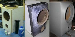

If this isn't a sub I would have issues with how far the driver sits back from the rim of the flare.
Hi Bill,
I looked at the pic again & it seems like the speaker sits a little back from being flush at the lip of the flare. If it was made to be flush with the lip that would be better right?
Also would this kind of flare be a bad thing for diffraction (woofers and tweeters)?
What's the difference if it's a sub or not?
Ralph

Subs would tend to have thicker rims necessitating a deeper rabbet.
Looking at the picture of his woofer, it seems it will be recessed. Not sure how he did it. Did he use that ring as a spacer and the woofer rests inside it? It wouldn't be difficult to make the woofer reasonably flush with this design. Maybe he's flushmoutning a grill.
However, I wonder what having that hollow chamber between the fiberglass and wood would do. It would be great if you could fill it with sand which would be doable if you glued the rear panel on last.

Well, there's also the wavelengths to be considered. At bass frequencies, that little bitty edge isn't going to diffract much.
