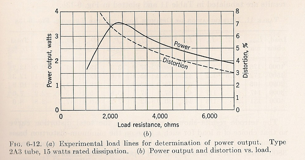

In principle tube amps are ideal constant power sources. In practice this means that power delivery will not change drastically when load changes within a reasonable range.
It's not true they are designed for a specific load. Recommended operative conditions found in datasheets are normally for good/near max output power without trading off too much in linearity.
But I use a 10K plate to plate transformer in my 45 PP amplifier with only 8 secondary and can use any speaker rated from 4 to 8 ohm. Into 4 ohm I get more than 25% increase in output power. Max power is achieved into 3 ohm where primary load is just below the recommended value in datasheets...

The only case where I would avoid this practice without careful check is where the amplifier has pentode output stage. With triode and Ultra linear no problem. Triode especially is brilliant at driving high impedance.

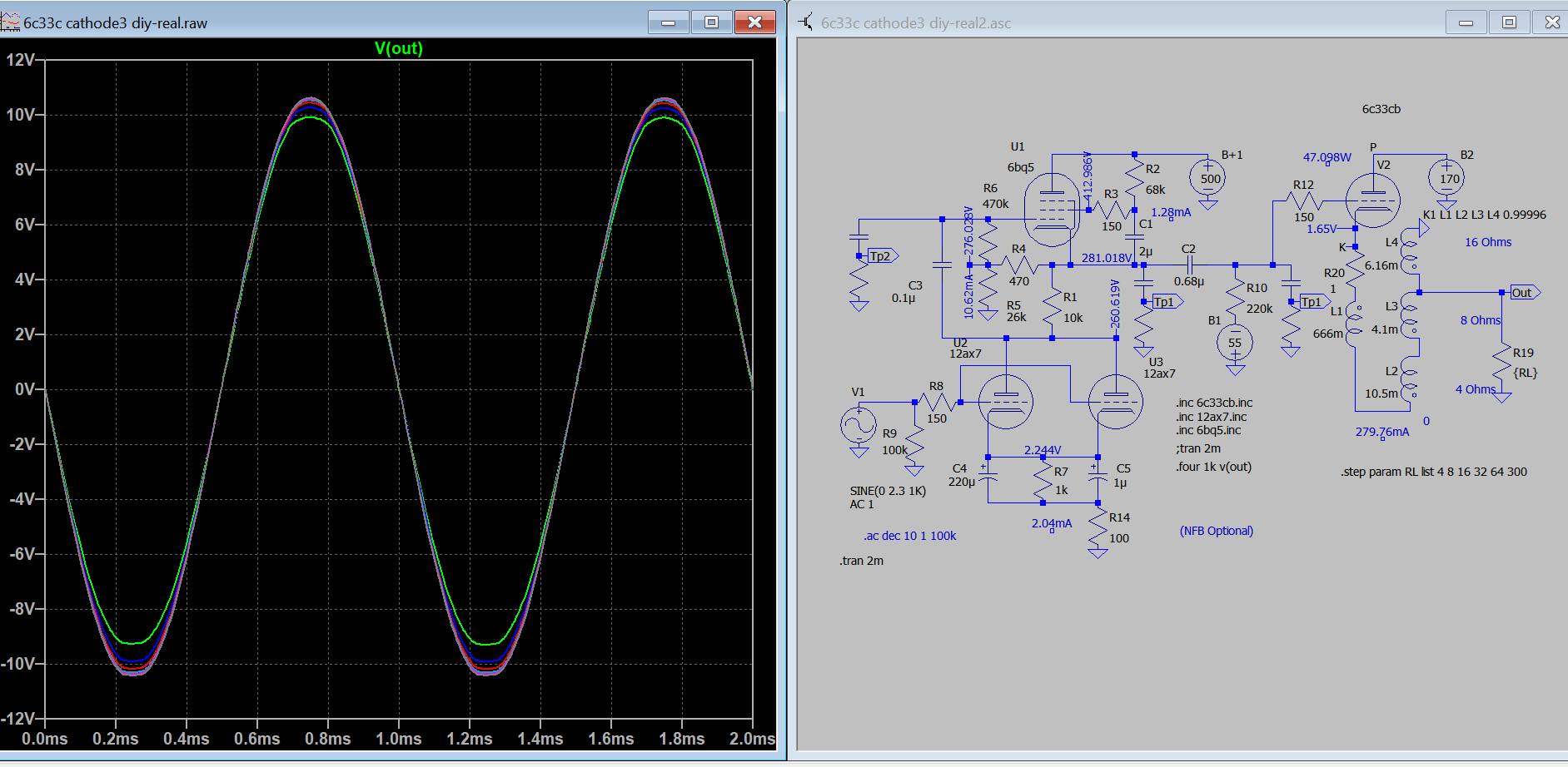

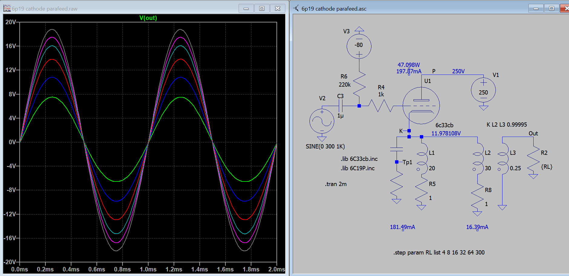

Depending on output stage configuration, here is classic vs para-feed, the later has DCR 730 ohms.

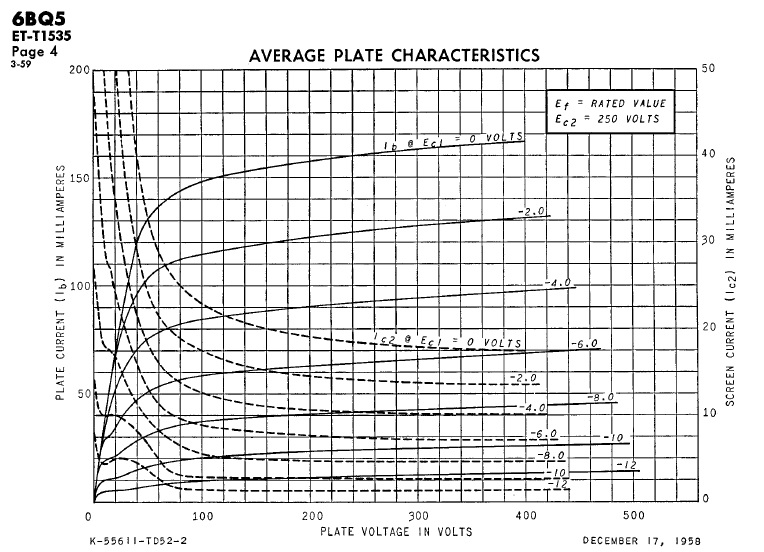

Depends on whether triode or pentode output. If triode, no problem, somewhat less power & less distortion.🙂
But if pentode output the screen(s) will have to dissipate a lot of power when the loadline runs up against to zero G1 line. That wuld be the dotted lines on the 6BQ5 plate family curves. And more D% is a sure thing at most levels.😱
