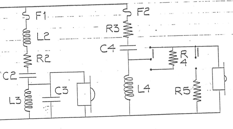

Assume a 6.8 Ohms resistor is placed in midrange crossover at the input terminal side and a 2 Ohms resistor is placed at the same position in the tweeter crossover. The difference between them is 4.8 Ohms (6.8-2 Ohms). If the woofer is replaced with a higher sensitivity one, the mid and tweet will need to lower their attenuations. And if the tweeter is bypassed its 2 Ohms resistor, would it be successful by simply replaced the 6.8 Ohms resistor of the midrange by a 4.8 Ohms resistor? By doing this, the difference between tweeter's and mid’s resistors still remain 4.8 Ohms (4.8-0 Ohms). That means the relationship between these two resistors is linear. Is this assumption true?
No. What are the impedance of the drivers?
If both drivers are 8 ohm, I would try a 3.9 ohm resistor for the midrange to keep it matched to the tweeter.
If both drivers are 4 ohm, I would try a 3.3 ohm resistor for the midrange to keep it matched to the tweeter.
I would get a range of resistor values. Start with the value from above that applies to your impedances, and measure the response with REW (free software, but you use a USB microphone, e.g., a UMIK-1). Adjust as necessary.
Lastly, you probably will need to tweak the crossover for the woofer. It is unlikely the crossover you have will work well with a different woofer, especially if the impedance of the new woofer is different than your old woofer. Side note, do not put a resistor in series with your woofer; it will negatively affect the damping.

Yes, the woofers will definitely have their crossovers revised. But, I didn’t mention it because I’d like to focus on the mid’s and tweet’s attenuations first.
Given the tweeter and midrange are both 4 Ohms;
Case I
R2 = 6.8 Ohms
R3 = 2.0 Ohms
Case II
R2 = 4.8 Ohms
R3 = 0.0 Ohms (bypassed)
Do these two cases provide resemble on-axis responses? As both cases have different value between R2 and R3 equals to each other—at 4.8 Ohms, hence, the relationship is linear?
