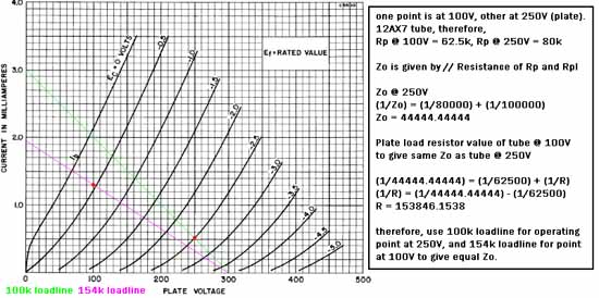

hi tim,
thanks again for the reply.
as far as the freqency response you dealt with, you're absolutely right... especially about the simple part! 😀 A couple of minutes with a pen and paper will even give you number values on your frequency response!😎
alas, once again, not quite what i was asking about...
have a look at the situation i drew up for you in paint that i attatched... a couple of loadlines and a little explanation written down the side.
now, for this example, frequency response due to the output circuit is the same for both operating points, despite 150V difference in plate voltages and about .8mA in current.
this is why i am asking these kinds of questions... i am interested in what is taking place 'inside' the tube... what you were refering too was frequecny response due to the output circuit. i am interested in knowing wether a tube amplifies some frequencies more than others at certain voltages, and how inter-electrode capacitances at different operating points might effect it, and so on...

benny said:alas, once again, not quite what i was asking about...
Oh well... I've slept now 😀
Yup.
Almost any tube behaves the exact same until maybe 30MHz. Some need to be derated by then, so they run much lower power by say 100MHz. You can run 6L6s at 200MHz but they're not good for much. This is mostly due to electrode inductances and capacitances, skin effect, that sort of stuff. HF tubes have several pins connected to the cathode and are well shielded (compare an 807 to a 6L6GA). If you try pushing a tube like 6C4 up to 500MHz, you won't be able to because the inductances and such simply won't allow it through. Other tubes (particularly coaxial and planar microwave types) work basically the same from DC to many GHz, although saying so isn't as easy because anything operating at that frequency will be resonant and things happen in such short times and distances that you can't always look at the circuit in terms of time across the scope or what have you. But the point being, tubes consider audio frequency as changing DC signals, almost all types can operate 3 orders of magnitude faster.
i know.😉 that's why i refered to it as a 'magical' tube. 😀
Yeah, but it's an odd thing to say because the curves are part and parcel with the 3/2 power law. Although, now that I think of it, you might be able to generate perfectly linear curves. (Or grab a 6SL7. 😀 )
as far as what you said about abruptness of clipping, what do you mean it doesn't happen??? different abruptnesses of clipping can happen... one of the main comparisons people bring up between transistors and tubes... and even different tube types transfer into distortion differently... what i want to know, is within the same tube, can operating point effect how it transfers into clipping?
Yeah, but in the case of pentode or transistors, external loop or local NFB causes it to be much more linear until it canst be linears no mores, and clips. Triodes don't have this as their internal feedback is based on that 3/2 power law. (You can set up a triode and pentode stage to have the same gain and Zo, the triode might have 5% THD while the pentode has 1 or 2%.)
But that doesn't answer your question, as you asked w.r.t. operating points. I would have to guess that, grid current aside, when pushed into the distorting areas, it will always be the same gradual figure. Only external means of additional NFB can straighten this out. Triodes do it a little gracefully due to a combination of internal NFB and its nonlinearity, indeed you can operate a triode at a higher current and get very little distortion as you are running in a more constant-Rp region. (Look at 6SL7, 6SN7 to some extent, 12B4, they all have straight curves after a certain range.) A pentode has very little NFB and hence is always distorting, though THD is still less for smaller signals. Transistors have an exponential curve and when amplifying a triangle wave, the output is known as "barn roof" or something like that, because you're applying an exponential function (the Ebers-Moll equation FWIW) to a linear signal. It looks like a barn roof!
These factors won't really change with operating point, with the exception of making things relatively smaller: i.e., say you want 20V output. That's 20% of +100V but only 5% of +400V. If the same nonlinearity exists, it will be 4 times smaller at the 400V operating point. A generalization, mind you...
- Oh, a good way to visualize that would be to draw a curve and mark a small area near zero, then mark the same width area at a higher level. Which is straghter?
