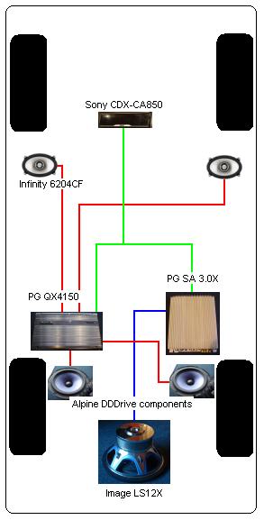

Anyway I thought Id share pics of my install as it progresses. I have just purchased an A31 cefiro with no stereo and I have a collection of equipment to install in it😀
Pics to come.....
This is the layout...
