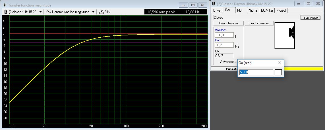

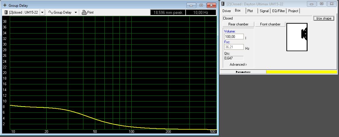

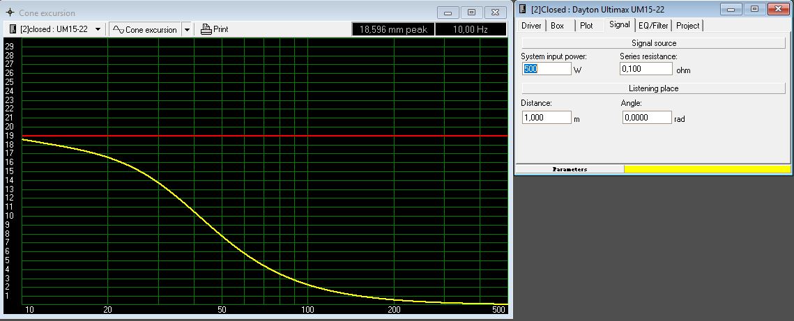

Sooo i thought about DIY Subwoofers since my current 15" Jamo THX Sub is not enough anymore.
The current driver of choice would be the Dayton Audio Ultimax 15".
The idea is to build two ~105L (3.7 cft) Boxes, not counting driver-displacement or bracing, powered by an amp with approx. 2x 450-510W@4Ohms (db technologies HPA 1000 / crown XLI 1500).
I want effortless tight bass down to 20hz but with a good amount of punch in the upper regions for Movies/Music/Games at a max volume of around -10db on my AVR in a 25qm² (~269 sqft) Room. My current cut-off frequency for the LFE is 90hz.
The cost of this would be rougly 1000-1100 for both, maybe a bit more. Same as buying two Klipsch R 115SW. I really want to beat those.
The Questions i have:
First of all: do these box dimensions with this speaker paired with the amps make sense? Can it be built smaller and still deliver)
Second: Does it make sense to build this over buying two of the Klipsch R115SW off-the-shelf subs?
I hope you can help me out 🙂 I never built a sub (or speaker) so i don't know every minute detail about building one (have learned much in the past weeks though). I am not clumsy concerning woodwork but i just want to make sure that it makes sense. I don't want to end up with two huge subs with which i'm not really satisfied in the end.
Attached is a simulation in WinISD if that helps:

Hi kite,
The Ultimax 15 is a great subwoofer. I talked two friends into buying them, both are still very happy after about two years in use. One friend got the 3 cuft knockdown enclosure and the Dayton SA1000 subwoofer amp. The other friend built an 11 cuft slot ported enclosure and used a bridged Crown XLS1002.
To answer your first question. Yes. 3.7 cuft sealed should work well with the subwoofer, but I think you need more power, 800-1000 watts. One thing you should consider is you may need to add some bass boost at 20-25hz when using a sealed enclosure. Most proaudio amplifiers have a 1.4 volt input sensitivity and home audio receivers have a .775 volt output, so you will not get the full power out of the amp unless you use a signal booster between the two. Hope this was helpful.

After some quick uneducated tests in WinISD it seems that a 5db boost will flatten out the response down to around 25hz. Although 5db seems a bit much it shouldn't be a problem with two 15" ultimax o_o
About a year ago I built a pair of HT subs using the 15" Ultimax drivers. I put them in 4 cu ft sealed enclosures. I'm driving them with 500W BASH amps.
500W seems plenty. From my modeling in Unibox, these drivers are excursion limited. I don't understand why comments on numerous forums claim to need 800W to 1,000W. I barely have the gain turned up on the amps. My home theater is about 3,000 cu ft.
Yeah thing is.. i reall don't want to kill the driver 😀 If i (and i know, simulation is simulation) play around in WinISD and let's say i add an EQ at around 25hz Q2 and Gain of 5 to flatten out the response, then add a 4th order highpass at 18 or 20 and apply 500W of power then the cone excursion is 6mm over max. If i add 1000W then it goes through the roof. Yes, that's without room gain but i'm thinking:
Whats the most sensible way of doing this.. applying around 750W of power and limit the driver via highpass so you have more power for the higher bass frequencies? Am i overthinking things? I've had dreams about the driver popping out of the case, burning on the ground 😀
