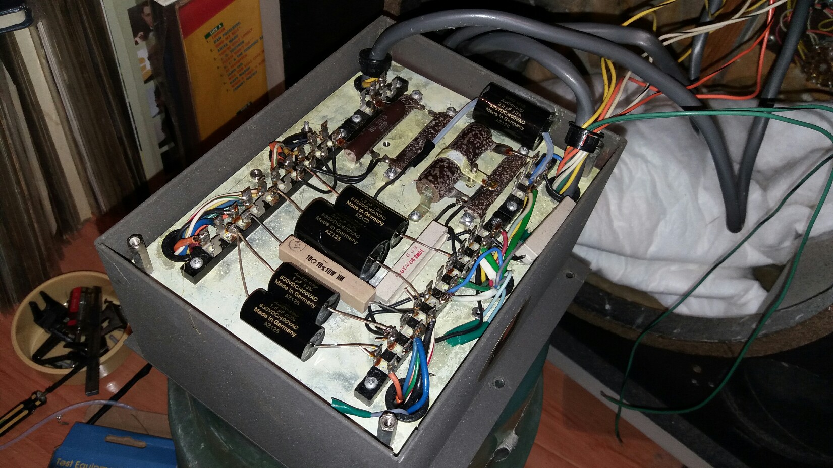

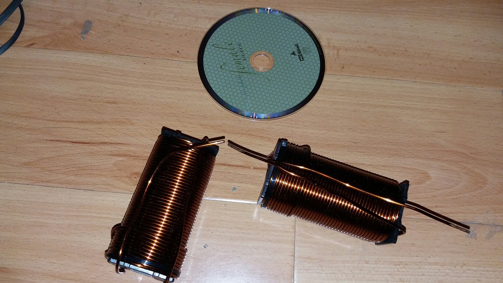

I would like to replace the original JBL 4343 woofer inductor (5.4mH with 0.6ohm DCR) with a new 5.4mH at 0.25 ohm DCR, whic is about tripple the size of the original inductor. It gonna be a big task to install inside the 4343 because the new inductor is very big with 2mm diameter wire
My intention is to improve the bass response (more bass and more bass dynamic)
Is this approach effective to achieve the goal?

The issues is that well designed, you take the DCR of the coil into account when you build the entire crossover network. In my designs, this would mean I'd have to change the coil and cap values to achieve the exact same FR.
Usually, reducing DCR in the first coil tilts the FR of the woofer upwards.
Sometimes you can even use DCR to help in eliminating baffle step.
I don't know how much of a difference 0.35 Ohms will make in your case, but the increased output wont' be in the bottom half, but the top half of the woofer's range.

I have a feeling that the effect may not be due to lower DCR but much thicker wire used to constrcut a coil. Just think about using a much thicker speaker cable improve the bass response in your hi fi setup. Is it the same thorey?
You make a lower DCR inductor by using thicker wire.
Yes, it is the same theory and it does not work well for this because of what I shared with you. Change the DCR and you change the behavior of the low pass filter and not how you want. When I make crossover filters I choose the ideal DCR. I do not pick the minimum DCR available to me unless it is also the ideal DCR. It is not a cost factor. It is a matter of making the ideal low pass circuit. Alter the DCR and you alter the entire circuit.
You can't pick and choose what parts of network circuit theory you believe.
If you want to avoid this altogether you need to build an active crossover so the amp has no coils or caps between it and the woofer.
You might as well just start doubling the inductors or cap values as well if you do this.

If all the other components in the network were resistors, then no problem. But they are not. Each reactive component's impedance (coils and caps) changes vs. frequency, therefore the percent effect of DCR is not the same.
You can view this in simulation. See the top link on this page:
A Speaker Maker's Journey: LM-1 Bookshelf Crossover
You can grab XSim, and this simulation, and play with DCR.
I think part of what you are missing is that the low pass filter is ALSO an equalizer.
Usually woofer response rises with frequency. So the low pass filter doesn't just cut off the response at a certain point, but it also has to tilt the response downwards.
Change DCR and you change this tilt.Eliminate DCR you point the response upwards which increases the midrange, not the bass. Do this enough and you have to re-set the twitter level.
DCR is not a separate part of the circuit you can just alter without affecting everything else.

get hold of the woofer specs, and put the data into some online calculators;
you'll get about .35 dB increase in bass level, and the Qts will lower by ~ .03;
i.e. bugger all difference

The difference may be measured in a Lab, you will definitely hear no improvement, since difference in attenuation between 0.6 ohm in series with 8 ohm and 0.24 ohm in series with 8 ohm is microscopic, well under 1 dB , well below the threshold of hearing.
So you will spend $$, waste time and complicate your life trying to mount a larger and heavier inductor ... for no (audible) return.
For comparison, moving your speaker a couple inches closer or further from a wall will change way more than that, go figure.
