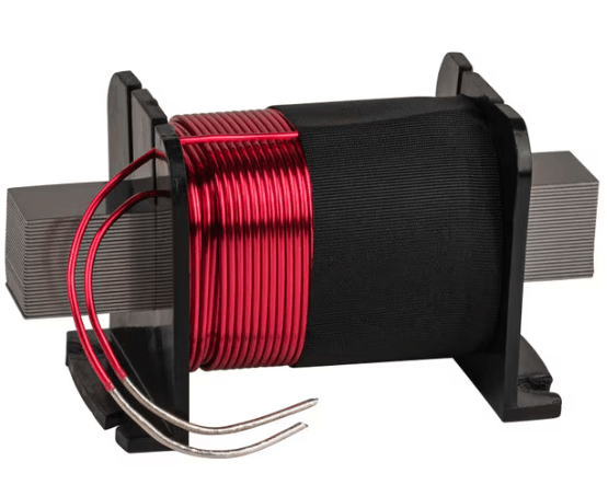

Hello all, do you know where to buy, if exists, a low DCR and high current variable inductor to help in crossover fine tuning? I hate unwind and rewind normal coils, also because they can easily be damaged from this practice, so I'm wondering if exists an inductor where I can simply move the inside core in & out to change the mH value, or at least what can be the best suitable in commerce inductor in which this tweak can be easily done.

It should be easy to do with an inductor that uses a solenoid core which can be dislodged. Often they are glued to the inner surfaces of a bobbin.
Exactly, do you know any commercial model made so? I was surprisingly not able to find any. Does somebody know, for example, if this Dayton Audio model is suitable has moveable core and is suitable for this purpose?
If yes, what's the mH value with core totally in place and without core at all for some model?
Maybe you could use two inductors in series and adjust the distance and orientation to fine turn their inductance.

I wind my own inductors with multiple taps to use for wall proximity compensation on passive filters. A rotary switch then allows you to select how much BSC you want on the LP to avoid muddiness.
I also use multiple taps for crossover prototyping. Also very handy for testing tweeters and horn drivers.

If you want a useable range, even for a simple 2-way crossover, you soon run into very large, heavy and expensive constructions.
If you are a professional speaker developer, it could make sense, even as I don't think a pro would invest in such gear today.
Good measuring in combination with crossover simulation works faster, better and cheaper. You only try and fine tune the most promising simulation results.
If you do some serious speaker development, you will build up a heavy stock of coils, caps and resistors anyhow. I can't carry all my boxes with coils at once... they are too heavy.
By the way, after adjusting a set of coils to a specific value and before permanently mounting them inside a speaker, pouring some fast curing epoxy over the windings is a good idea. The inside of a speaker is mechanically demanding.

Probably not what you were looking for, but as you want to do this to test/prototype it would it not be easier to use an active crossover? Once you get the exact values you want you can buy/build the inductor. If you need to simulate the DCR, variable resistors are easily available. (If you have enough DACs/amplifiers you should be able to get away without buying a DSP board if you can use your computer's output with something like CamillaDSP.)
While writing this comment I just googled variable inductor and apparently they do exist, for example mouser sells a few. However their inductances might be on the lower side, some are listed in nH.

Far from chesp but there is 2 available options, along with multi caps and resistors. Assumr Lozjek was reffering to the same ones above.
https://www.intertechnik.com/shop/developer-tools/583193,en,8072
