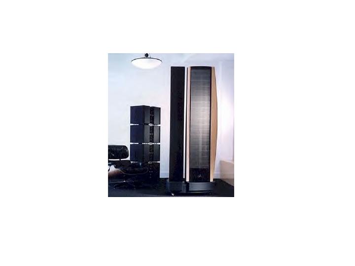

Martin Logan Statement 2
The Martin Logan Statement 2 has a line source dipole ESL, a dipole line array of 6.5" Scan Speaks separated by a physical gap from the ESL panel, and a separate bipole subwoofer array that was placed far away from the panels that could have a radiation pattern aimed perpendicular to the ESL and still pressurize the room.
ML apprears to have used all of the techniques mentioned in this thread to reduce the effects of low frequency sound waves modularing the ESL panel.....physical gap to midrange line array and separate bass cabinet aimed away from the ESL.

If a closed box sub is used with dipole you simply place the sub at 90 degrees to dipole and voila, no problem from the direct outputoif the sub.
And with multiway dipole you need a gap between each range just like ML did it with their big speaker system.
The problem also exist with coned drivers as someone was concerned with, but the cone mass and enclosed volume beind makes this much less of a problem compared to a dipole ELS membrane.
By the laws of nature the mids and tweeters thast are most sensitive to this is of course those with soft suspension, low mass and big volume of air in the box behind. The stiffer the suspension, higher the mass and smaller the volume of air in the box the less this moving system will move according to a outside pressure acting on it.
Moving coil dipole speakers are more sensitive than closed box but less so than ESL.
In the end it is actually dipoles (no matter if moving coil, ESL or magnetostats) that can be arranged to be least affected by this phenomena, simply by doing it like ML. With perfect symmetrical dipoles and air gaps between panels there will be no force acting between the panels.
