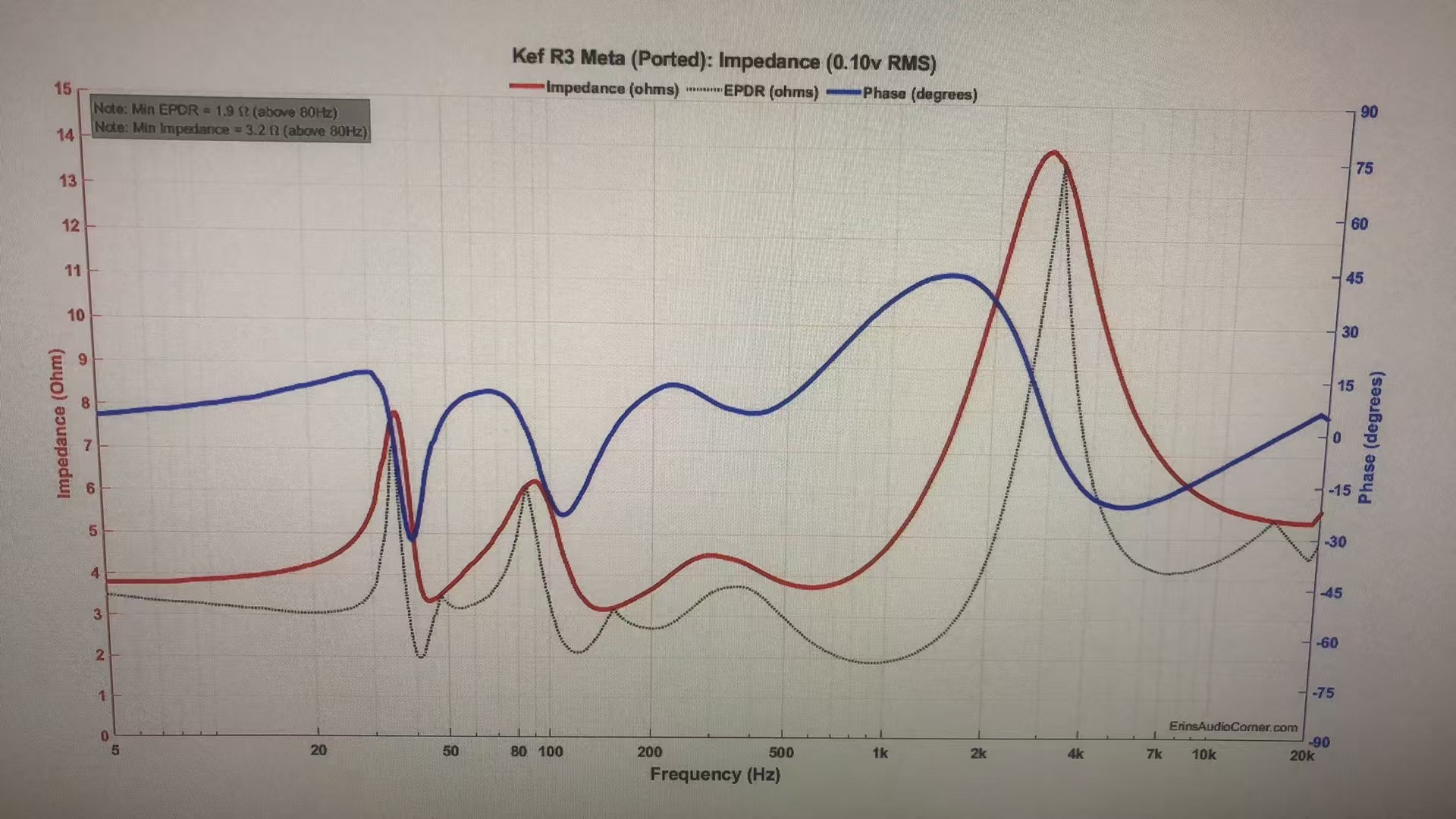

I regard amplifier power dissipation as effectively an inverse of EPDR (equivalent peak dissipation resistance), i.e. peak power dissipation occurs at minimum EPDR.
A competent amp designer would ensure sufficient peak power dissipation into a real life speaker load at different frequencies.
I would expect a high quality amp to withstand momentary minima of 2 ohms. Do you have a particular amp in mind?
Impedances/EPDRs like that are relatively common in speakers intended for audiophiles that typically have amplifiers capable of driving low impedance loads. If you intend to use something like a home theater receiver that's only rated to 6 or 8 ohms, it's less advisable.

i can't solve low EPDR. If i add 1 ohm in serie to woofer, the bass and group delay will be in bad form.
Resistor in serie to woofer is prohibit. But to boost EPDR, i don't know other method.
Unfortunately, loudspeaker designers seem to insist on making it difficult for amplifier designers!
