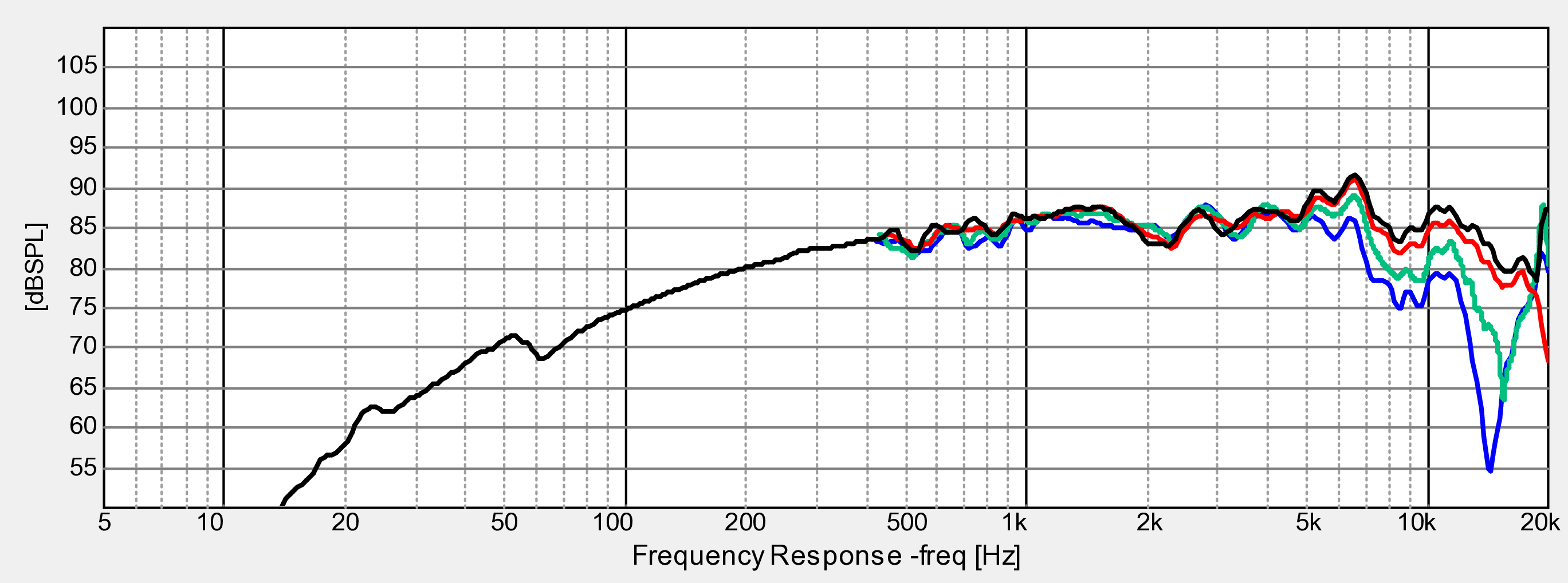

Rigid might be a bad thing here. My Dayton ND64-16s have a peak of close to 10dB in the octave from 1500 to 3000Hz, while the B&C 8NDL51 has a peak that's about half as loud.
The Dayton is aluminum, the B&C is treated paper.
The spec sheet from Dayton shows it's smoother than my measurements show, so I'm trying to figure out why:
B&C's 8NDL51 measurement on a baffle
My measurement on a Unity horn
Dayton's ND64-16 measurement on a baffle
Subjectively, those prosound midbasses (in general) seem to perform pretty nicely through the midrange. My old Summas with the 14TBX100 had a great midrange, and my Yamaha DXR12 with a midbass that looks a lot like the Eminence Alpha is also quite nice. Of course both speakers use them as a direct radiator so it's a bit of an "apples and oranges" situation.
If anyone's wondering why both spec sheets show a rising response, and my measurements show a falling response, I believe that's because the horn loading takes the output radiated by the midbass and spreads it across a wider beamwidth. IE, same amount of energy but wider beam means less energy on axis. Also, compression chambers act as an acoustic low pass filter.
