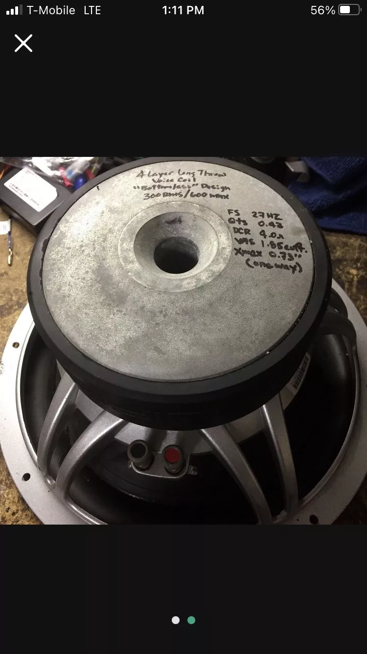

Does anyone recognize this?
I bought this sub for cheap and I'd like to make better enclosure for it. But I can't figure out what model this is (tried reverse image search and one reddit post but no conclusion) and I have no way of measuring the t/s parameters now. So can someone identify this or tell me how can one measure the t/s parameters for cheap.
Or the not best option, could someone say what could be good ported box for this based on the sealed that it came with?
Do you have any test equipment? Multi-meter that's accurate across the frequency range you want to measure, signal generator, etc.?
A couple links that cover measuring/calculating parameters with older methods:
https://sound-au.com/tsp.htm
https://sbacoustics.com/wp-content/uploads/2021/01/Measuring-Thiele-Small-parameters.pdf
Alternatively, are you interested in learning how to use REW?
https://www.roomeqwizard.com/help/help_en-GB/html/impedancemeasurement.html
https://www.roomeqwizard.com/help/help_en-GB/html/thielesmall.html
Well my dad has multi-meter lying around and said he would give it to me and I have no clue how accurate it is. Signal generator if my hz generator on my phone counts yea, if not nope. REW would be cool to learn but I have not gotten around to learning it, now is probably the best time because I have reasons to do so.
On the multi-meter, you have to be careful since many aren't accurate when they get much away from 50/60 Hz (AC line frequency). With a subwoofer it's less likely to be a major problem, but it is something to be aware of, and it's worth looking up the specifications of the meter if they are available.
