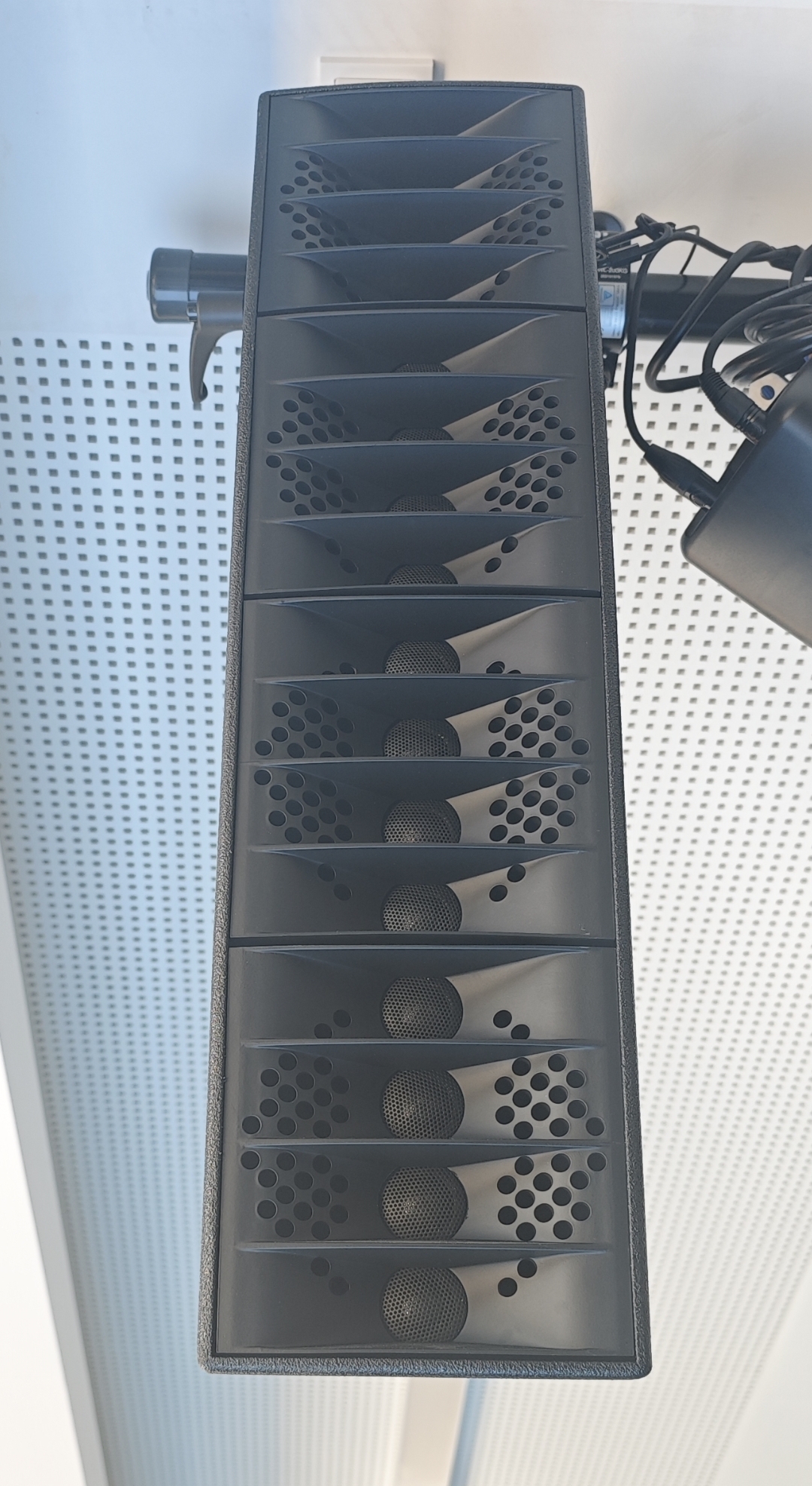

I have seen these in a music academy today and find them interesting.
They are only about 6inches wide.
I would really like to listen to them but it's vacation time in Bavaria.
The sticker says Seeburg GL 16 vox
Cylindric Wave Radiator

I agree this is interesting, thank you for posting it. I've not seen such a design before.
With something so narrow, horizontal directivity control isn't going to extend very low in frequency. I wonder if the design intention might be less towards proper unity/synergy territory, and perhaps more of a simple coaxial-like arrangement, just built tall, into a line array?
Similar in design to JBL CBT70 and 1000 series too, just those are passive cabinets.
