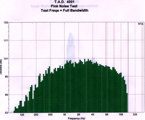

Does anyone have the TAD TL-1601a and Exclusive ET-703 Frequency Response Graph?
I am trying to determine where to cross those drivers.

Thank you.
Could you explain what does 30 degrees off axis on horizontal and vertical plane mean?
It seems like these ET-703 are good down to 2kHz. I am surprised and very impressed.
Combine with the TAD TD-4001 graph, it seems like a good crossover point could be from 3K to 7kHz. Does anyone have experience with crossing these drivers?
8khz to 12khz would be better, but it depends on the horn you are using.
3khz is way too low, and risky with such a pricey driver.

I think you are right considering TAD recommends 5kHz or higher.
Could you explain why this range would be better than say 6kHz to 8kHz? From the TD-4001 graph, it seems like the TD-4001 is not very good above 8kHz.
I am using Yamamoto F-350II with the TD-4001. The cut off frequency is 350Hz.
what horn are you using?

Concerning the ET703 / TD4001 integration, it is always better to try to cross the supertweeter as high as possible to avoid comb filtering in the most sensitive regions. 10khz is a good point to consider, but it depends on the horn you are using.

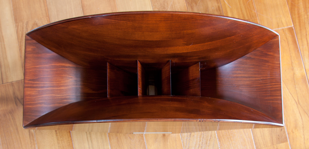

Horns with fins (like the one in the Exclusive Model 3401) are more subject to beaming and lobs at high frequencies, and may demand a lower crossover point. Directivity (loss of it) is also a limiting factor as to how high you should use a horn.

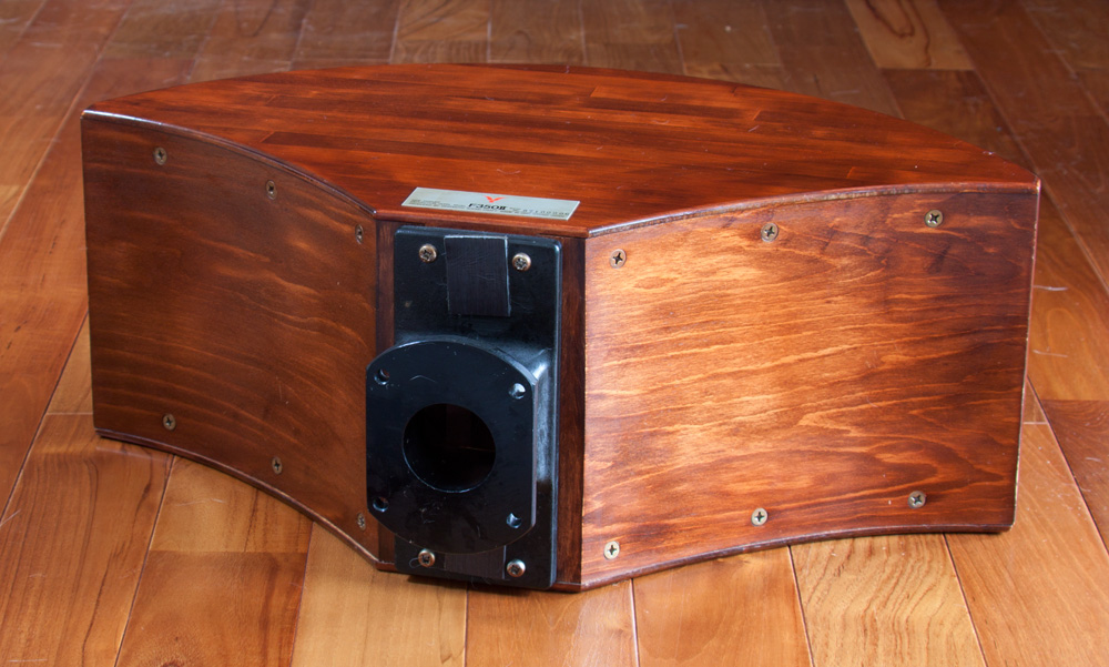

Do you have pictures of your horn?
The frequency response of the TD4001 (on which horn, by the way?) is not that important: as long as the falling in level is slow and regular it is not a problem at all, as long as it it taken into account in the crossover). The beryllium diaphragm will remain pistonic at 10khz, no worries.
If you want to stick with the TL1102 I think you should seriously consider these (JBL SUB1500), crossed over around 60Hz to your 1102. W15GTI would also be an option, as well as acoustic elegance AV15.
Any of these will do much better than the TL1601 in the 20-100Hz range (and not using the TL1102 down to at least 80Hz would be a waste...).

nice horns!
