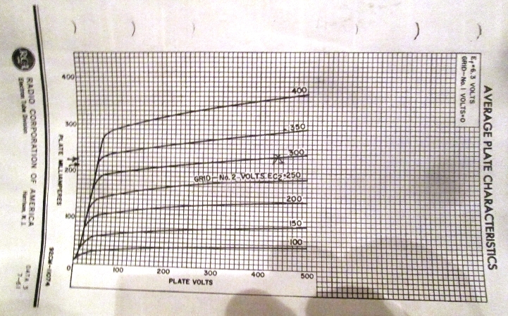

Does anyone have specs for the "new" Tung-sol 7591s
Hi guys, I was trying to find a spec sheet for the new version of the Tung-sol 7591s. I've heard they are a hotter tube than the originals. The only spec sheet I can find was on tubedepot and its the one for the original tube from 1961. Cheers
Unfortunately, the one Steve linked is from 1961 also.
The Tung-Sol website has the datasheet, but they've just replaced the bottom line of the sheet with an overlay saying New Sensor. It's the old datasheet, too.

I told you how to properly bias your amp. With roughly 450 volts on the plate (the stock value is 430 volts, but that's with a 117 volt AC line voltage - today's line voltages are often 5% or so higher than that which means about 450 on the plate). and essentially zero volts on the cathode and cathode current of 35 ma. you'll have total dissipation of 15.75 watts.
The Tung-Sol current production 7591As are quite happy at that wattage or just a hair more (you could bias them at 38 ma if you want). But in my experience many of the Tung-Sols develop excess heater-cathode leakage or excessive grid current at total dissipation above 17 - 17.5 watts. So regardless of what the old spec was, I don't recommend - nor do I guarantee - the tubes be run at any higher dissipation than I just mentioned.
As well, the ratings shown by the data sheet on the New Sensor/Tung-Sol site are ratings reached using the "Design Maximum" rating system. This is a rating system that is significantly less conservative than the "Design Center" rating system that is most often used. In fact the Design Maximum ratings are 10% higher than the Design Center values.
According to the GE Essential Characteristics manual here are the definitions of the two ratings:
Design-Center Rating System: To establish conformance to the design-center rating system, the ratings should not be exceeded with a bogey tube operating in the equipment under average conditions with respect to supply voltage, signal, temperature, component values, adjustment of controls, and other variables.
Design-Maximum Rating System: To establish conformance to the design-maximum rating system, the ratings should not be exceeded with a bogey tube operating in the equipment under the worst probable combination of conditions with respect to supply voltage, signal, temperature, component values, adjustment of controls, and other variables.
You can find a complete discussion of the ratings in the TubeCad journal here:
http://www.tubecad.com/december2000/page17.html
So consider that:
a) the amp is likely running at 20 volts or so higher plate and screen voltage than it was originally
b) the published 7591A ratings are showing the less conservative Design Maximum ratings system
c) my real-world experience with testing/matching hundreds of Tung-Sols indicates that while some tubes will perform properly at the Design Maximum dissipation specs many of them will not! And looking at the schematic of the 7591 version of the S-5000 II I see it does not have adjustable bias.
d) your S-5000 II originally ran the 7591s at a cathode current of about 51 ma. per tube and with 430 volts on the plate. That yields a total dissipation of 22 watts per tube - which exceeds even the Design Maximum spec by over 15%! Back in the day the tubes could often withstand this sort of abuse - and tubes were cheap and readily available. That's not true anymore.
e) finally, the new Tung-Sols tend to bias hotter than the old stock tubes did. By hotter I mean that they have higher cathode currents (and therefore higher total dissipation) at any given set of operating conditions.
On the basis of those 5 points I recommend 35 ma. per tube as a safe bias current. And that was why I made the recommendations I did.

Here is exactly the page that proves it.
All valves come with graphs, which is exactly what they are for.
Here is the one you need to see.
