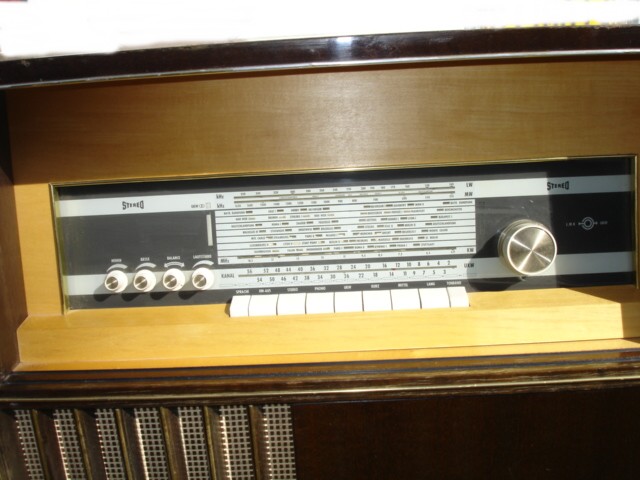

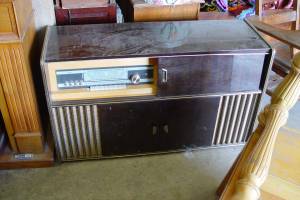

Can anybody tell me or give my any information on this late 50's late 60's German console. Owner says it does not work but I am mainly interested in the speaker and it is complete for $50.00. I am going to look at this next week. I am including a picture and at this point, I don't have any more information.

If it is german, has a tube amp in it and speakers it is worth $50 just for salvage.

Hi Curt,
it seems to be a Grundig or Loewe Opta Console, Here in germany wie call them "Musiktruhe" "music chest".
Try Google and look for "Musiktruhe" in connetion with the major radio makers like Grundig, Blaupunkt, Loewe Opta, Philips, SABA, Telefunken, Schaub Lorenz, Siemens.
With a little patience you will find a picture of this radio set. Most of the german collectors pages are additional in english.
good luck!
regards
Wolfgang

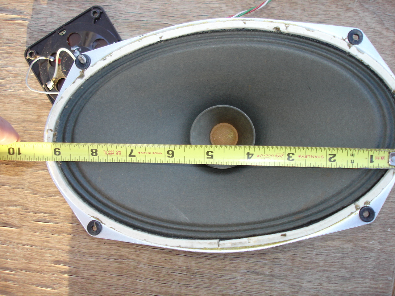

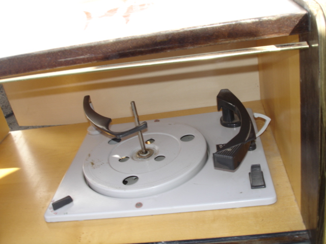

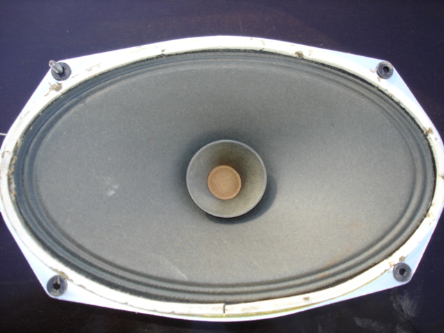

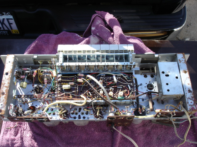

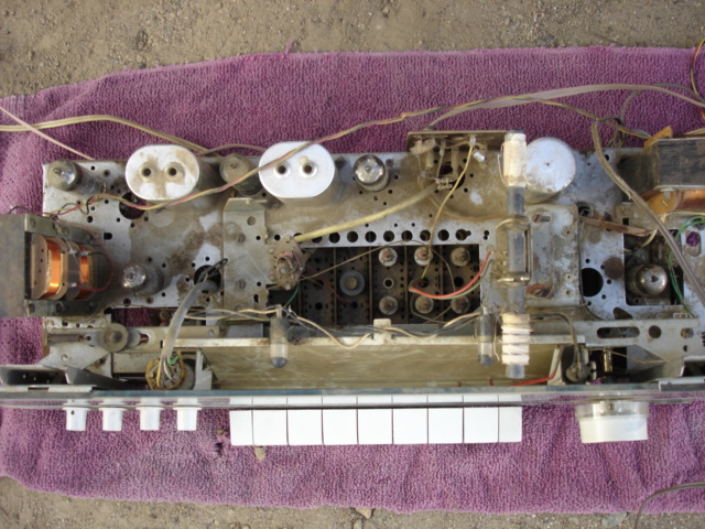

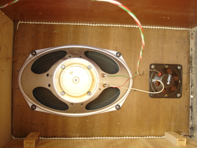

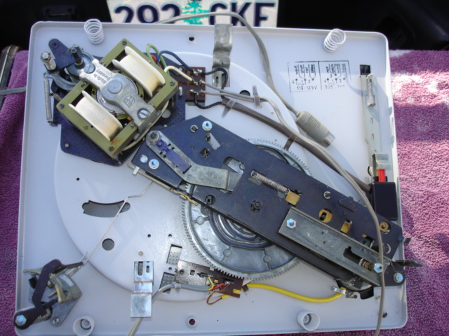

Hi, this is Curt. I went, looked and bought ($40.00) the German console today. I was a little disappointed because it looks like a lower end model and I cannot find the make on it anywhere. I was hoping it would have larger speakers. It has 5-1/2 x 9 inch oval wizer cone speakers, small tweeter and no crossover. The speakers look good. Cabinet looks in good condition, just a few small scratches. It has really cool speaker grill covers. Record changer appears to be complete and not tampered with. The amplifier is dirty but not rusty. Someone has loosened the transformer, tuning dial string is broken but the dial glass and controls are nice. I did not want to try and power it up. It has these tubes: ELL80, EAF801, ECH81, ECC83 and ECC85. I am attaching some pictures- I am not sure what I am going to do with it yet...

Those speakers are very nice. Small whizzer and the brown woven dust cap brings back pleasent memories. Mount it vertically on an open baffle and see how it does.

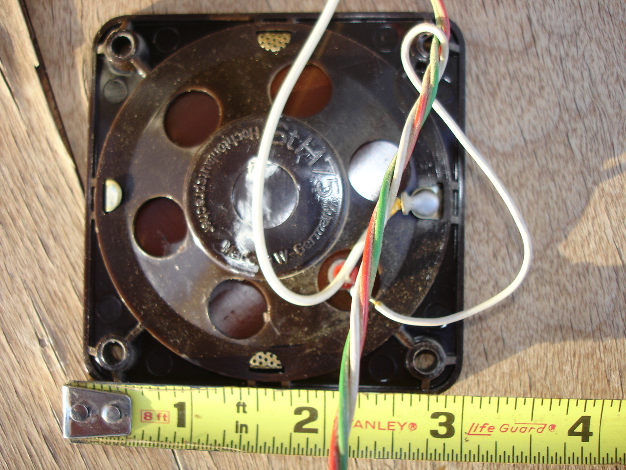

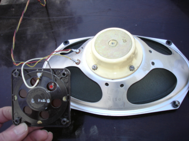

The tweeters are sungle ended electostatics, driven directly off the amplifier plates where the single cap XO is. Yours are isophon STH-75

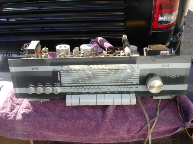

From the one picture that shows the OPTs i get the impression they are pretty largefor a console, it was fairlycommon to see the same OPTs across the range,so these could well be beefy enuff to support an EL84 SE build of decent quality. I've not seen any that look like those.

I may be talking out of my rear orifice here, but it is possible this console was made in East Germany (quite possibly with slave labour from political prisoners - Ikea used this for years) under contract for a West German Catalog/Department Store.
A lot of this went on in the 50's and 60's and even into the 80's (by the 80's it was of course no longer consoles).
I can be sure to be able to tell with close-ups of the components on the radio chassis. It is equally possible it was made under a similar contract in the West.

I was almost going to suggest that, since some of the parts were reminiceint of an RFT i has seen a number of, but seeing a number of West German parts in it, i didn't know how often, if at all, that happened.
If the question about the kind of tubes was RFT i was going to put forward Easy Germany.

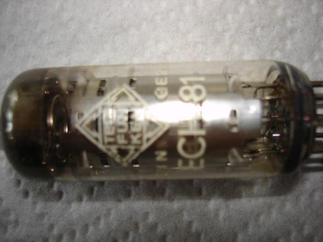

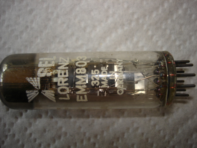

Hi This is Curt. I forgot one tube, it is a EMM 803 that is in the dial.(Tunning eye) ? All tubes are TELEFUNKEN Germany. Here are two pictures, the last is the dial tube. I've already had $40.00 worth of fun. Thnks all Curt Let me know if I can send more pics and of what part.
Double check that the ECC83 has a diamond etched into the bottom of the tube. If the tube tests good and it has good silkscreen (be very careful handling it), you might be able to recover your purchase price with that tube alone.
I might be interested in buying the ELL80 off you.
Better pictures of the OPTs (with a ruler or tape for reference)?

Looks to interesting to part out to me. Very interesting tweeter and those ovals are often very nice.
