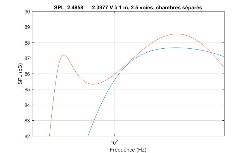

I want to 1st order low pass a woofer at 140Hz with a series inductor before the Re driver.
R=Re+R_inductor
Le=Le+Le_inductor
Re=5.75 Ohm
Le=1.8 mH
R_inductor=0.68 Ohm
Le_inductor=4 mH

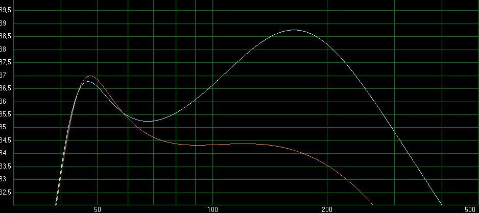

When i add a LP filter in EQ/Filter tab in WinISD Pro, it work's like i want (orange curve in black plot). But if i change directly the Re and Le values in driver parameters, it does'nt (cyan curve...).

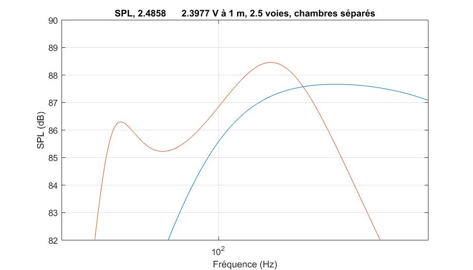

When i use Matlab with my schematics (lumped parameter), i get the same bad result. First white plot is without filter, the the last one is with added impedance.
Should i expect this bad behavior of the LP ?

So you want to create a low pas filter in front of the existing complex impedance device, not with it.
Take a look at the impedance curve at the frequency you want to create a filter at. For instance, the Z at 180 Hz may be 5.3 Ohms. Use that to calculate your low pass filter. To get 6 dB down at 180 you must divide the impedance equally, so the added coil must be 5.3 Ohms at 180 Hz as well.
It's a starting point only though, as speaker impedances are complicated. To properly match a mid or tweeter adjustments will undoubtedly need to be made.

A passive low pass filter at such a low frequency requires the impedance peaks of the woofer to be flattened first. At least the peak that is highest in frequency. Otherwise you usually get a bump somewhere around 100 Hz. It is cheaper to implement an active filter, or put the woofer in a bandpass enclosure.

The easiest way of finding a solution is to use existing sim programs where
you can import the frd (spl vs.freq) and zma (impedance vs.freq)
of the driver. The Le of the driver is defined at certain frequency in order to
match the real inductive reactance of the driver. Manufacturers usually provide
Le parameter. Once you have speaker unit impedance defined (in a box), you don't
change it in simulation, just the filter values. Get yourself XSim program.
The only two variables that might change the response is inductor's Re and L.

Start with the assumption that components you place between the speaker and the amplifier won't change the fundamental behaviour of the speaker. They will change the electrical 'appearance' of the speaker with respect to the network applied. It comes down to two things..I read that good alignment relate to symetry of impedance peaks. If i attenuate one peak, i lost this simetry. Is that a problem ?
The filter network modifies the drive signal in a selective way, so you can change the response..
and the filter network has a complex interaction with the speaker impedance, which is primarily an impediment to the way you design the filter.
Look at the example of a woofer that has a rising impedance, and the requirement to apply a low pass filter at its top end. If a series resistor and capacitor is strung in parallel with the driver the combined impedance in the region appears resistive, simplifying the design of the low pass filter placed before it.
I'm not sure but I've thought of WinISD as a box simulator, and Xsim is a crossover simulator. Each has their uses.- Stop using WinISD for filter checkup : download XSim to check my calculations
The bump in impedance requires fancy filter work to avoid the bump in response. It is easy to do once you get the hang of it.The bump in response mean a bump in impedance.

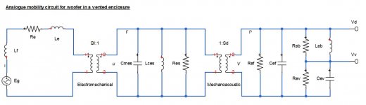

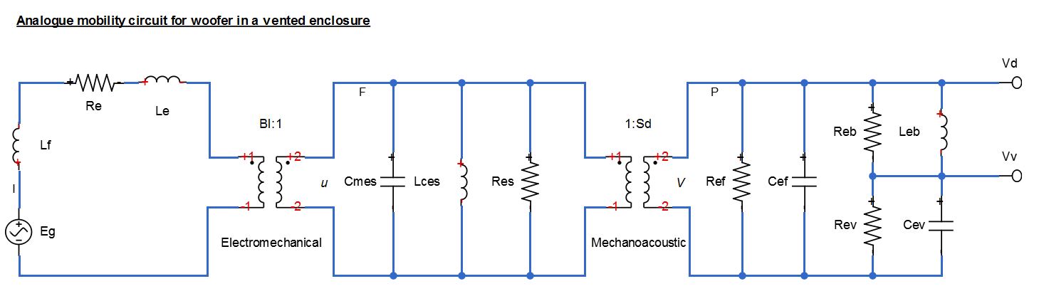

I try to draw my schematics with Matlab Simulink and it work's !
I take the module of the sum of speeds Vx+Vv and compute the pressure Ps and the sound pressure Spl.
Spl=20*log10(Ps/Pref);
There is about 30 other equation...
Is there a way to easy extract electrical impedance and total impedance from the mobility analogue circuit, or i need to do all the impedance analogue too ?

Z=V/i
Take voltage at voltage source or between crossover inductor and Re
Usually the radiation mass and resistance get moved over to the mechanical side and lumped in with the rest.
Those in teh mechanical part should probably be called (assuming they need to be prefixed with C,L,R) Cmms, Lcms and Rrms (which is actually 1/Rms)
Lces, Cmes and Res are usually reserved for those mechanical values referred to the electric side through the transformer.
