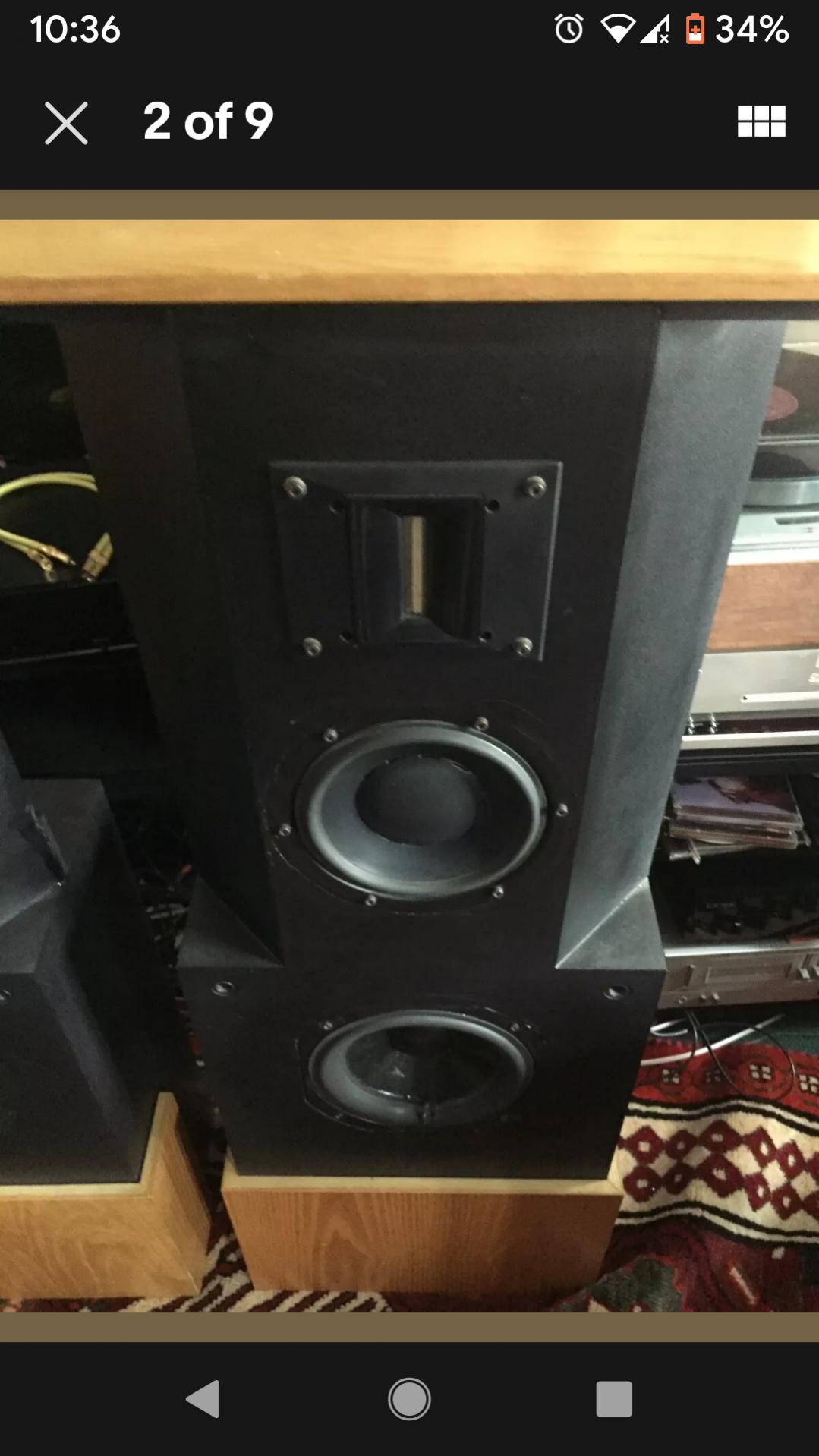

The speakers are SD Acoustics ' OBS '
I purchased them + some previous owner had replaced the Xover with just a single cap for tweeter ...and single cap for mid .. nothing on woofer

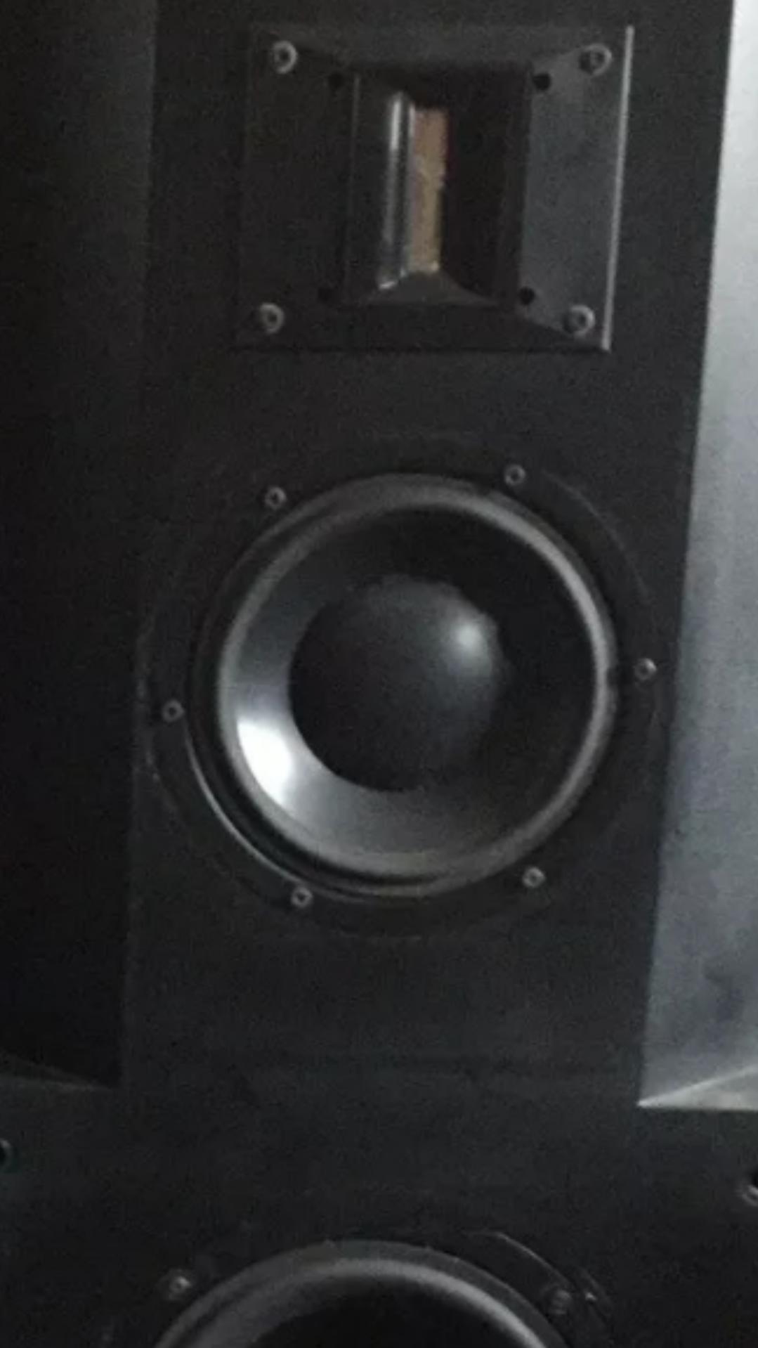

The front of the driver looks the same ......but the rear is different.... These drivers are from 1990s....but still function and no visible detoriation...
The speakers consist of a Monacor ribbon tweeter + 5.25 dynaudio mid + 8" Audax ( doped paper ) ... All pretty old ..the audax had to be refoamed
See photos ...
See photos ...
