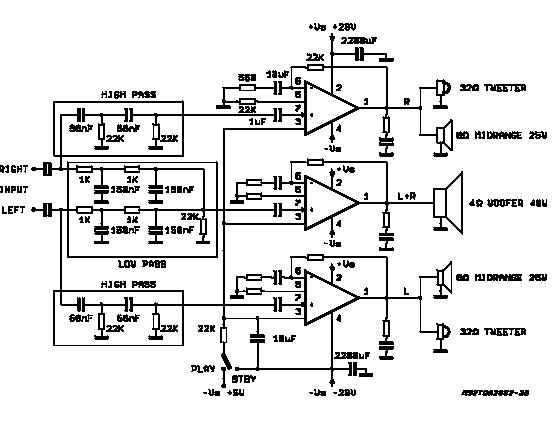

I made a 2.1 in last weekend. I used 4xTDA2052 (standard application circuit on ST's manual+passive crossover circuits) with 2x22v (250VA) PSU and 2 x 4ohm subwoofer + 2 x 4 ohm satellite speaker box then plugged it in to my pc's line out. And no hum, no noise and no on/off plops... Until that its all normal, but I feel it doesn't give 40W output level! Because generally my volume pot is on maximum level!

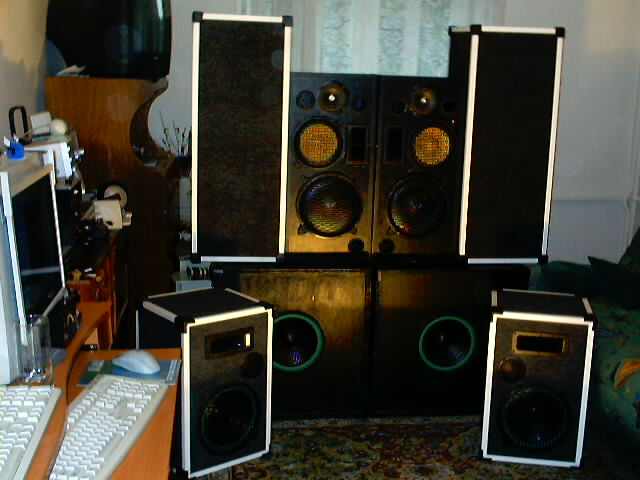

In my 5x4 room i have about 2800 W RMS at aprox 98 dB
I attached a picture of my system .
The aspect of the speaker's is not so good .. i didn't want some fancy looging speaker's ... i just want a good sound ...
Notice the klevar speaker's ( yellow ) and the bass horn's ( standing on the subwoofer's , next to the speaker's with yellow driver )

The fact that you cannot drive your amplifier into distortion even a little bit makes me still think the power amp IC's are not getting enough signal fed to them.
Hi Dx,
is that 22k & 560r as the gain setting on the chipamps?
Gain= 40.3 times.
Maximum output voltage ~ 15Vac into 4ohms.
maximum input to the chipamps ~ 15/40.3 ~=372mVac
Measure the average output from your music source.
It needs to be attenuated to <=37mVac to drive the amps to -20dB rel. to maximum output.
What's the sensitivity of the speakers?
What volume is expected from 0.5W input to the speakers?
Passive filters in front of the amps? Is this intended to be close to L-R crossover?
That summing Low Pass is wrong.
Where does pin7 get it's input offset current from?
