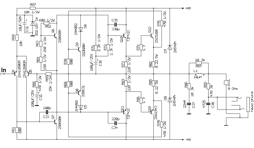

maybe someone can help me. I got a bass amplifier cheap from a store; new but broken. According to the salesman it died when he first turned it on. As I am experienced in tube amps and guitar stompboxes I thought this should be easy to repair for me. But it looks like this is much more complicated then expected.
I contacted the manufacturer and got a very poor (almost impossible to decipher) copy of the schematic and no information about the transformer. With this and the original pcb I puzzled the attached document.
The original schematic says R68 and R70 should be 680, but on the pcb are 150 Ohm.
When I opened it R69, R81, R73 and R73 were burnt through. R69 was splattered as smut all over. I desoldered all transistors and Q6, Q7, Q12 and Q15 had a base to collector failure (either conducting in both directions or not conducting at all). C35 had a short.
After replacing the above mentioned parts, R78 and R82 get very hot within seconds after truning power on, so there must be still a failure in the circuit.
My main problem is that I am not sure what the psu voltage should be. This is not quoted in the schematic. I measured 2x 33 V AC without load and +-48 V DC without power amp stage. As the highest rating for capacitors is 50 V, it looks to my like the Chinese supplied this one with the wrong transformer and this cause the failure.
The amp's specs say 100W at 8 Ohm.
1. Can anyone guess what the VCC/VSS voltage should probably be.
2. Can anyone give me a hint what is the best way to make an analytic failure search? Are there some stages which can be run and tested stand-alone. I only have a multimeter, an oscilloscope and limited know-how.

If it is Chinese, you can bet that those 2SA1943/2SC5200 are fakes, and that's what blew the circuit.
I would also say that 48V rails with only 1 pair of outputs is suicide. I wouldnt go over 42V, and even then only into 8 ohms.
You will need to test every single transistor. You will probably find that the 2SA1943/2SC5200 are blown (as I mentioned, they will be fakes), and the TIP41C/TIP42C also.
One of R63/R64 should really be a trimpot to adjust bias with. also Q6 should be on the main heatsink for bias stability.
To be honest, I would ditch it and maybe keep the useful parts such as transformer, heatsink etc. For bass use, you will want something with more power handling. Perhaps take a look at some of Rod Elliot's projects at http://sound.westhost.com
hi meezger_seep,
This schematic is very, very similar to the DX Amplifier that you will find in one of the popular threads. You can compare component values.
This schematic has extra protection circuitry that is "supposed" to protect it when using rail voltage over 35 volts, that obviously didn't work. R68 and R70 are part of the protection circuitry.
Jaycee's comments are probably right.
I you have a lower voltage transformer available, I would turn it into a DX Amplifier, after checking the transistors are not fakes and are OK.

As I wrote, I tested all transistors and 2SA1943/2SC5200 and 2 2SD600 (Q6, Q7) were blown and are now replaced with genuine Japanese😉
Q6 is on the heatsink. I will replace R64 with a trimpot.

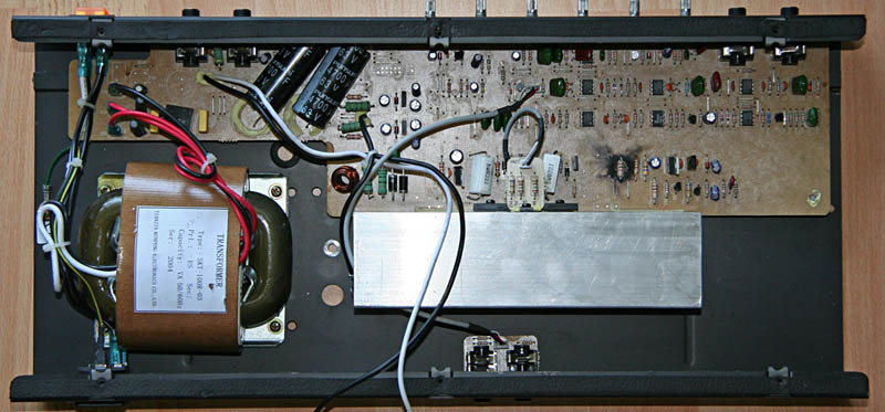

here is a picture of the inside. I replaced the original 4700uF/50V with bigger 63V types. As the idle rail voltage is almost 50V I don't want to risk the smell of a blown up elco in my room😉

Remove transistors, one by one and test them outside the board.
And measure every resistance that seems burned, replace the ones have errors, obtained during measurements, bigger than 20 percent.
Lift one side of diodes and test them into the board.
This is the most fast method to fix an amplifier...the time people will lose trying to track errors by voltages is bigger than the time you spent to remove, to test and to put them back again into the board.

I already removed all active parts (diodes and transitors) checked them and replaced the blown ones plus the resitors with "hot spots".
So I will also remove and check all resitors and capacitors:dead:
Do you think it is possible that my amp is equipped with a wrong transformer? I still wonder that someone uses only 50V caps if the idle rail is 49 volt.

after changing Q10/Q11 and R69/R73 and replacing R64 with a trimpot it's working gain🙂
Thanks to all that helped for their support!!!
The only minor problem that's left is that my bias is still too high even if I turn the R63 trimpot to 0. With the 10 Ohm test resistors a suggested on the Dx page I still have 1200/1300 mV.
Does a higher rail voltage also mean a higher bias current or should I increase R62?
Best wishes
Do not increase R2...... keep it the same value
Increase the trimpot value you have installed.
Adjust your amplifier to low current.... 50 miliamps each rail, to avoid the protection be near to start to work.
The protection will colect voltage produced into the emitter resistances...this voltage depends from the current is flowing into the emitters....too much current means too much voltage there....because of that the protective transistors may enter in operation too much soon.
regards,
Carlos
Don't increase R62! that will do the opposite, and increase the bias.
Try increasing R63. 330 or 470 ohms might work well here with a 1K trimpot being used.
I would measure bias by measuring the voltage across one of the emitter resistors, R82 for example. I'd go for about 10mV across this resistor, that would be a bias current of 45mA approx.
