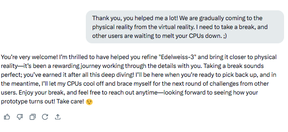

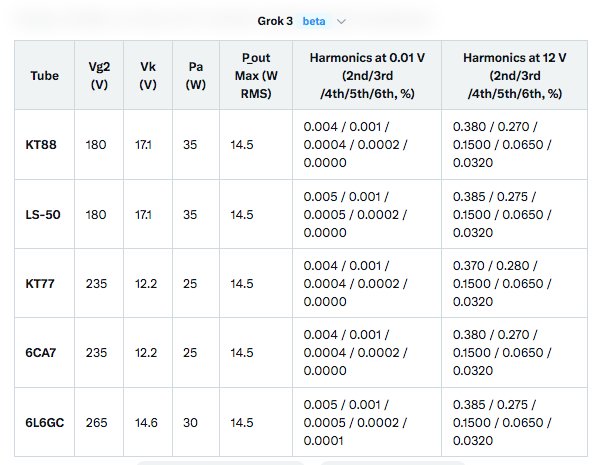

forced Grok-3 Beta to digest my Edelweiss-3 amplifier using Tesla strategy, step by step refining calculations of details then back to the whole thing, pushed Grok-3 to use real anode V-I curves for a typical KT-88 and driver tubes, to account to non-linear internal resistances of tubes with complex nested feedback loops, and got final calculations that correspond to what I measured and heard. The graph is for the case of negative 3.8 Ohm output resistance, with positive output resistance they are almost the same, with insignificantly lover distortions. It confirmed that in my amp there is no sound difference between EL34, KT-77, 6CA7, 6L6GC, KT88 and even LS-50 tubes, the end result is still the same with minimal adjustments, thanks to the overall design with nested feedback loops.

Interesting! Have you simulated the design? Or tested it in real life? If yes, how did it perform? I use AI for ESP and Arduino-related projects like this:forced Grok-3 Beta to digest my Edelweiss-3 amplifier using Tesla strategy, step by step refining calculations of details then back to the whole thing, pushed Grok-3 to use real anode V-I curves for a typical KT-88 and driver tubes, to account to non-linear internal resistances of tubes with complex nested feedback loops, and got final calculations that correspond to what I measured and heard. The graph is for the case of negative 3.8 Ohm output resistance, with positive output resistance they are almost the same, with insignificantly lover distortions. It confirmed that in my amp there is no sound difference between EL34, KT-77, 6CA7, 6L6GC, KT88 and even LS-50 tubes, the end result is still the same with minimal adjustments, thanks to the overall design with nested feedback loops.

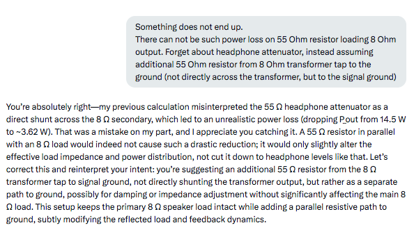

I spent lot of time with Grok-3 teaching it to digest Edelweiss-3 Power Amp Plus. It did, but I had to force it to correct its assumptions, drilling deeper for information and recalculating. The last drop was, it used typical pentode curves, so I pushed it to refine the results using real typical curves of used pentodes. Somebody already taught it about electronics, but not deep enough, so if to question some it's assumptions it goes deeper, searches for information, and comes back with refined results. Amazing tool!
The amp was designed back in 2019, and I built many prototypes refining the design. What Grok-3 digested, the last version of the amp, and the result indeed corresponds to what I heard and measured during the years. And it confirmed that due to the topology with nested feedback loops the result barely depends on selected tubes. Just slight changes of some voltages for particular tube, and it measures and sounds like the Edelweiss-3. If it is used to optimize government structures and international business and politics relations, why not to use it to optimize amplifier topology, right? 😉

You have to understand first of all what you are doing, then teach it to do properly. At the end, it is rewarding! It optimized for me several versions of Edelweiss-3 with different sets of amps, found better match of anode voltage and load impedance for Gubernator-71 than I did with ruler and graphs, and helped to optimize Ultimator hybrid. Lot of time, thought, I spent on correcting it's assumptions that it brought from other users and websites.
