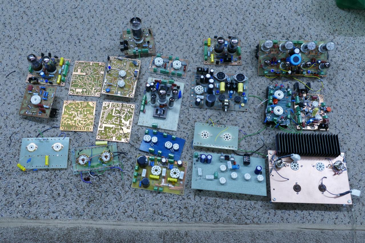

Just to give you an idea of what makes a Tubelab product, this is a picture of the prototypes that were in a box on my workbench. Some are from the past, dragged out to test an idea, some were used for developing something new.
There are two square boards and a rectangular board with big sweep tubes or sockets, and some turret boards. They were instrumental in developing they hybrid "Composite Electron Device" that allows for running big sweep tubes in triode mode at high voltages.
The blue perf board with 4 sockets was used for testing small CED's.
The blue board on the right that is wired to an older driver PCB with lots of sky wired parts is what the first glimpse of a new working amp design looks like. It is a single channel amp that takes some tiny TV sweep tubes and makes a 50 to 75 watt push pull amp. Both the driver and output stages are CED's.
Above that is the next step, a working stereo amp prototype PCB with it's own power supply. This one makes 50 WPC when powered by a cheap Antek toroid, and 70 WPC with a big Hammond power transformer. I think two more revisions on this board would be needed for it to be ready for commercial quality boards to be made.
Below those is a piece of coper clad board with 4 tube sockets and a heat sink. it is the first prototype of a SE amp that I call UNSET. I use that term because it is a triode mode SET, that contains NO triodes.

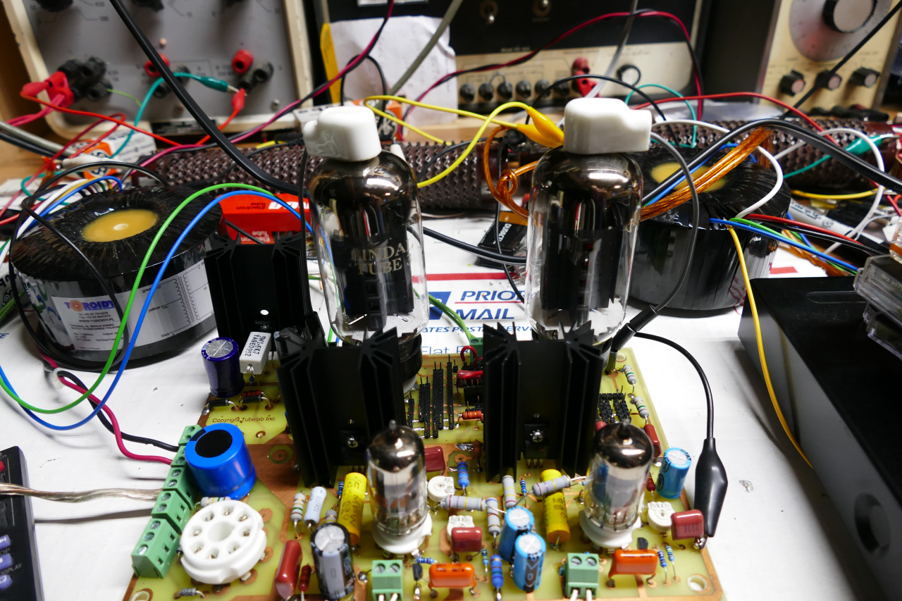

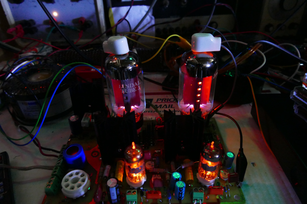

The next picture shows the only working stereo UNSET board. It has been hooked up to a pair of speakers since February and gets used often, but not at the tube melting levels seen here when I was exploring it's upper limits (about 40 WPC).
