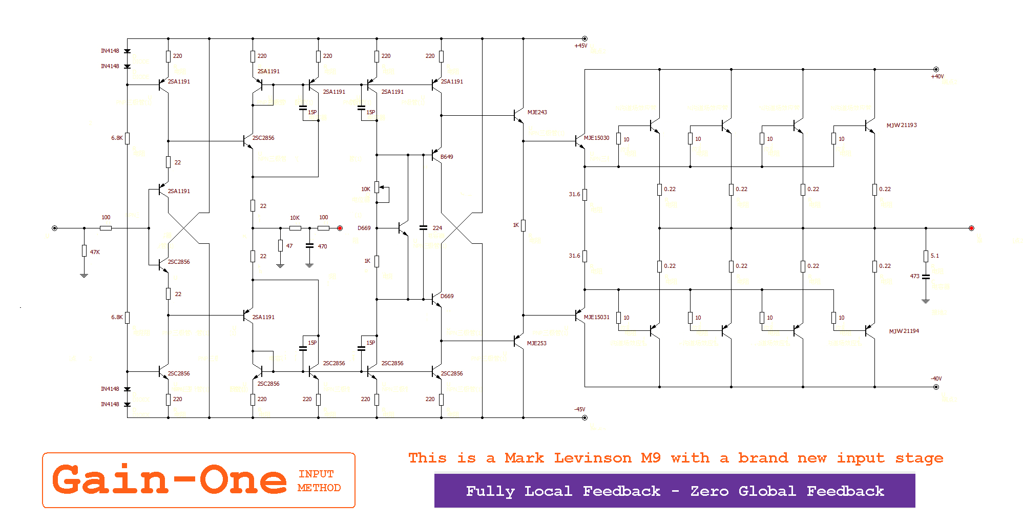

the divider has a total feedback
This allows you to isolate the gain of a single stage free

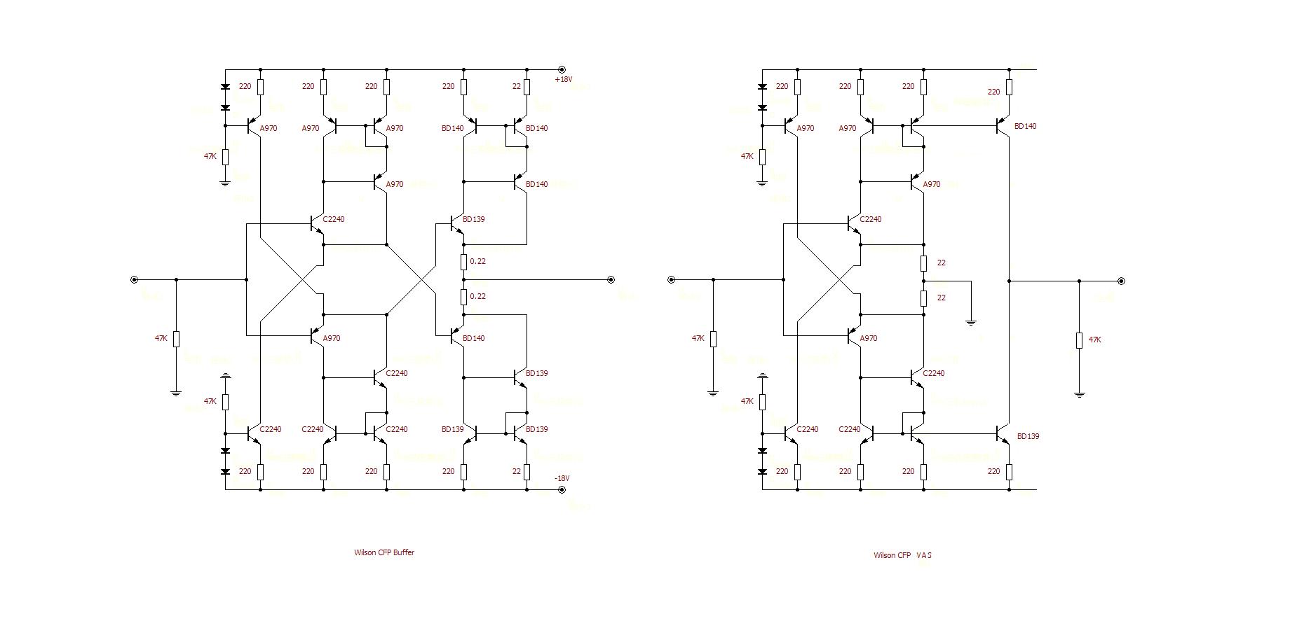

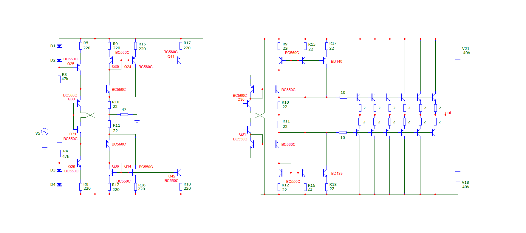

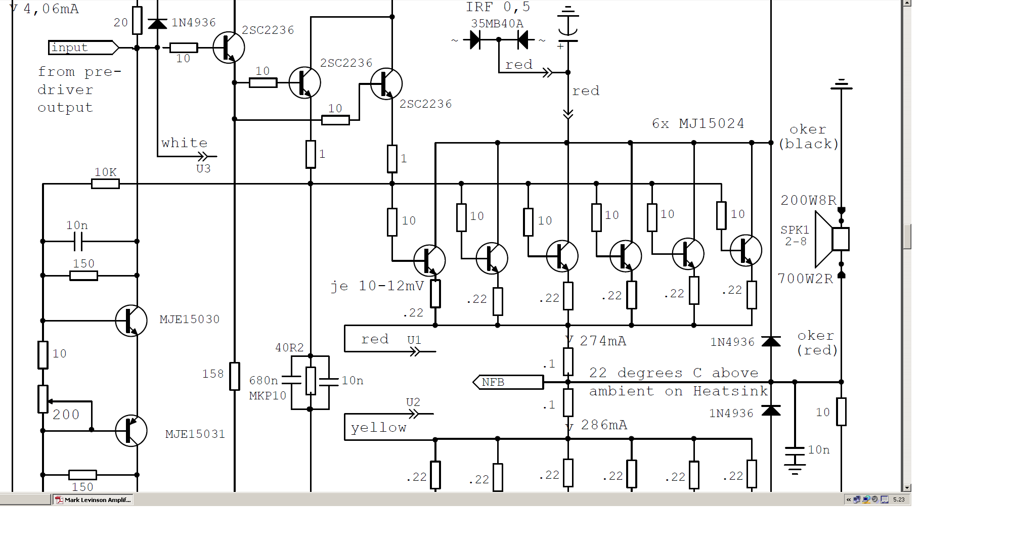

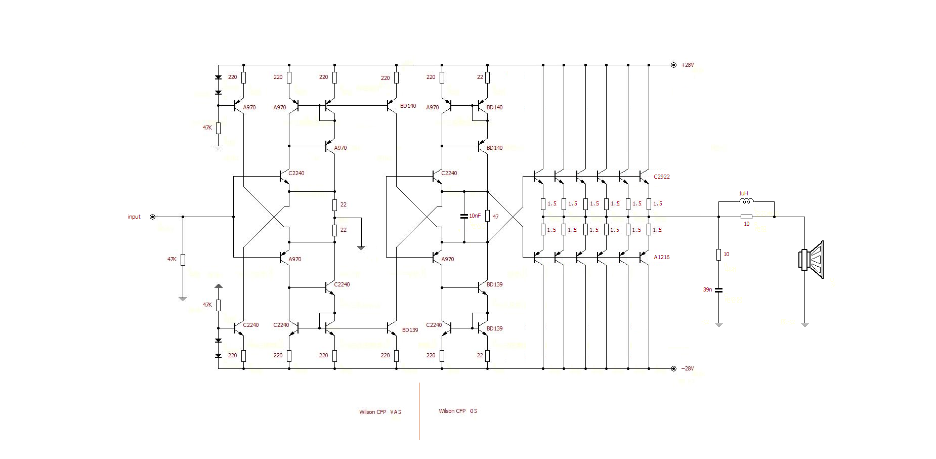

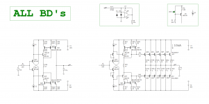

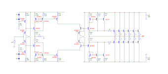

Hello Stee. Interesting bias regulator. Are its bjts mounted on the output stage heat sink, and/or get bias stability via the 1.5 Ohm emitter resistors?.1R5 on final devices can generate 150mV
then Vbe bias should be 450mV 😎

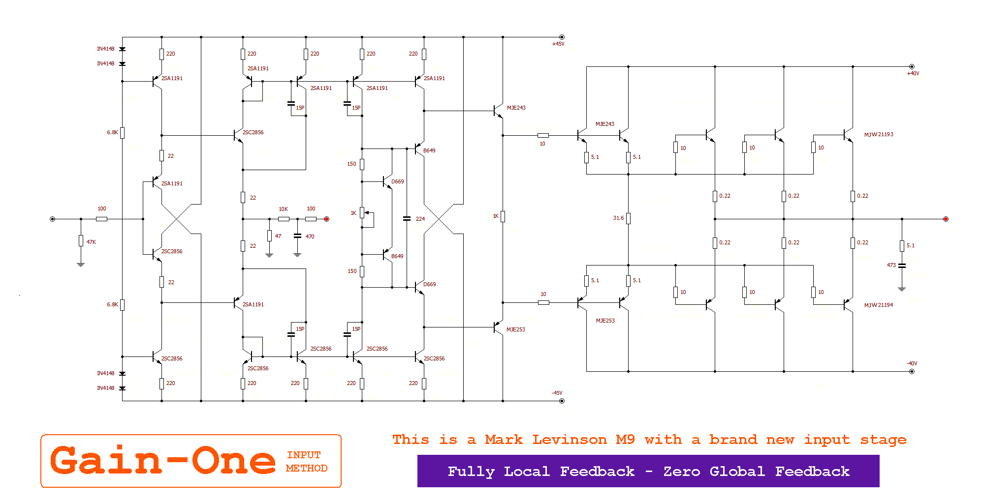

Hello Stee. I am impressed by your ability to generate [or mass produce] schematics which teach and inspire. It is like when it rains it pours. Downloaded your zip file, and peaked in it. Will study it. Thanks, and best regards.power resistors can avoid to reduce base current

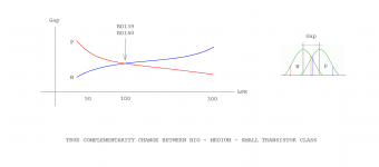

I'm thinking about MJE15031/32
8A Ic
