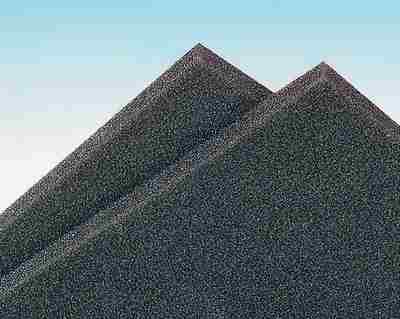

Use foam grilles!
Foam grilles is the solution to many of your problems...
On my diy-speaker I use foam grilles like the stuff seen on commercial speakers like "Rega Kyte" and "Naim SBL"
Some advantages:
Plastic foam loudspeaker front is found at:
http://www.elfa.se/en/
http://www.elfa.se/elfa/produkter/en/5617.htm
Some advantages:
- The main advantage is no frame to destroy sound
- Cheap
- Very easy to make
- Easy to mount and unmount using velcro
- I can not hear the difference naked vs. 1cm foam
- Flexible for non-plan designs
- Not that ugly

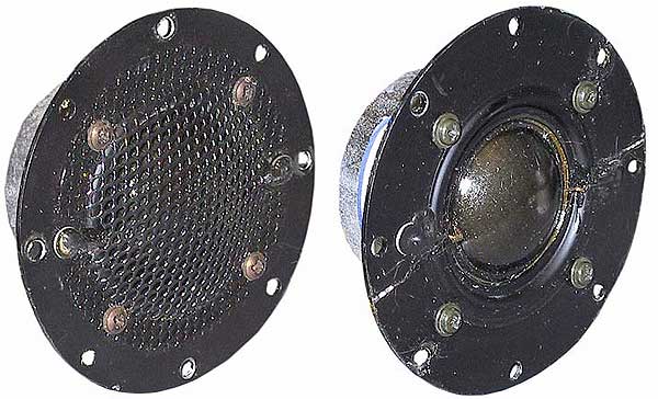

What about protective metal grills, like the ones used on Accuton's drivers? Any audible advantage of removing them?
Kjetil said:What about protective metal grills, like the ones used on Accuton's drivers? Any audible advantage of removing them?
I know it makes a big difference on the Dynaco tweeters (SEAS alnico H087) -- they aren't goinf to explode if you touch the dome thou.
