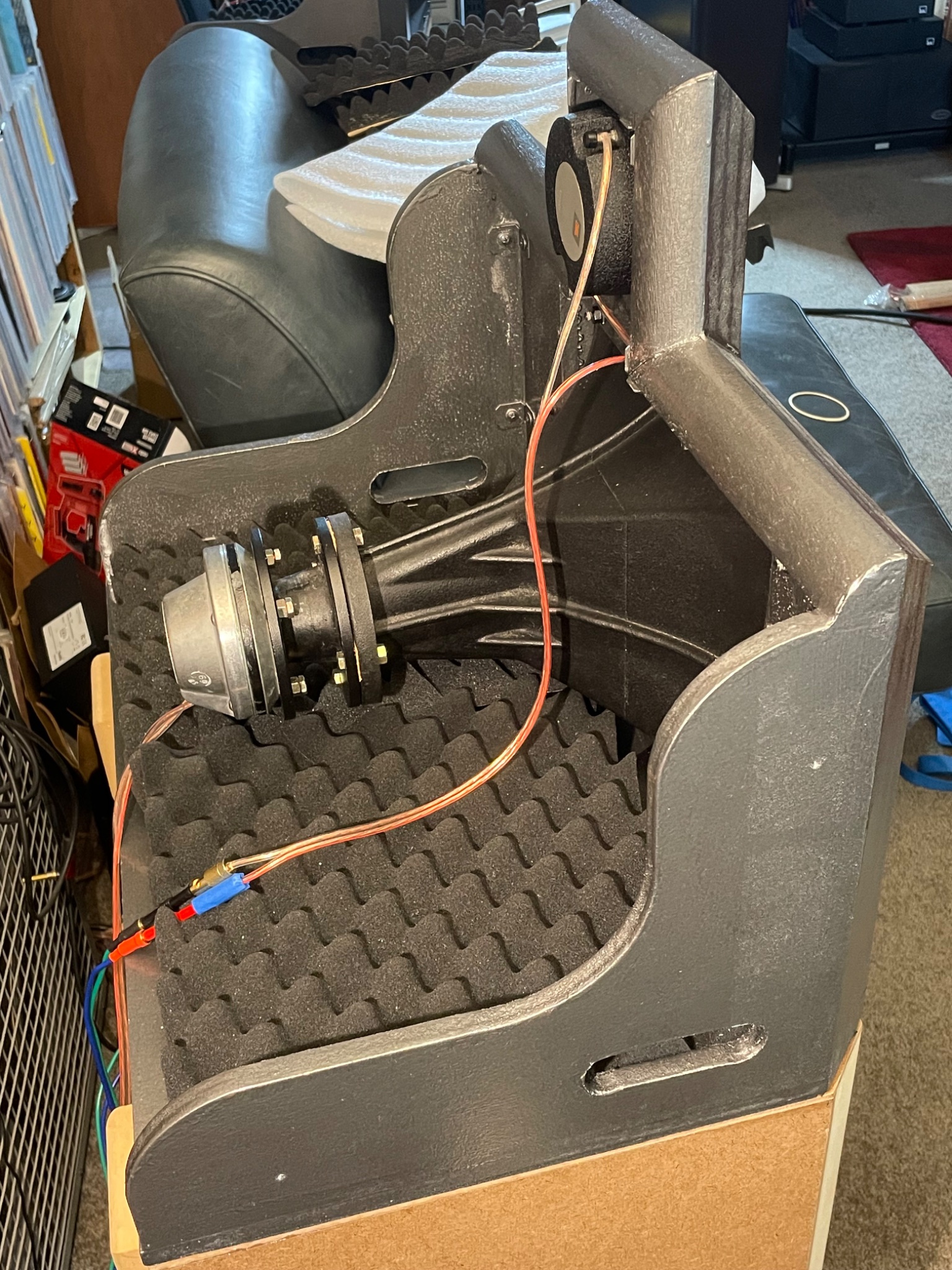

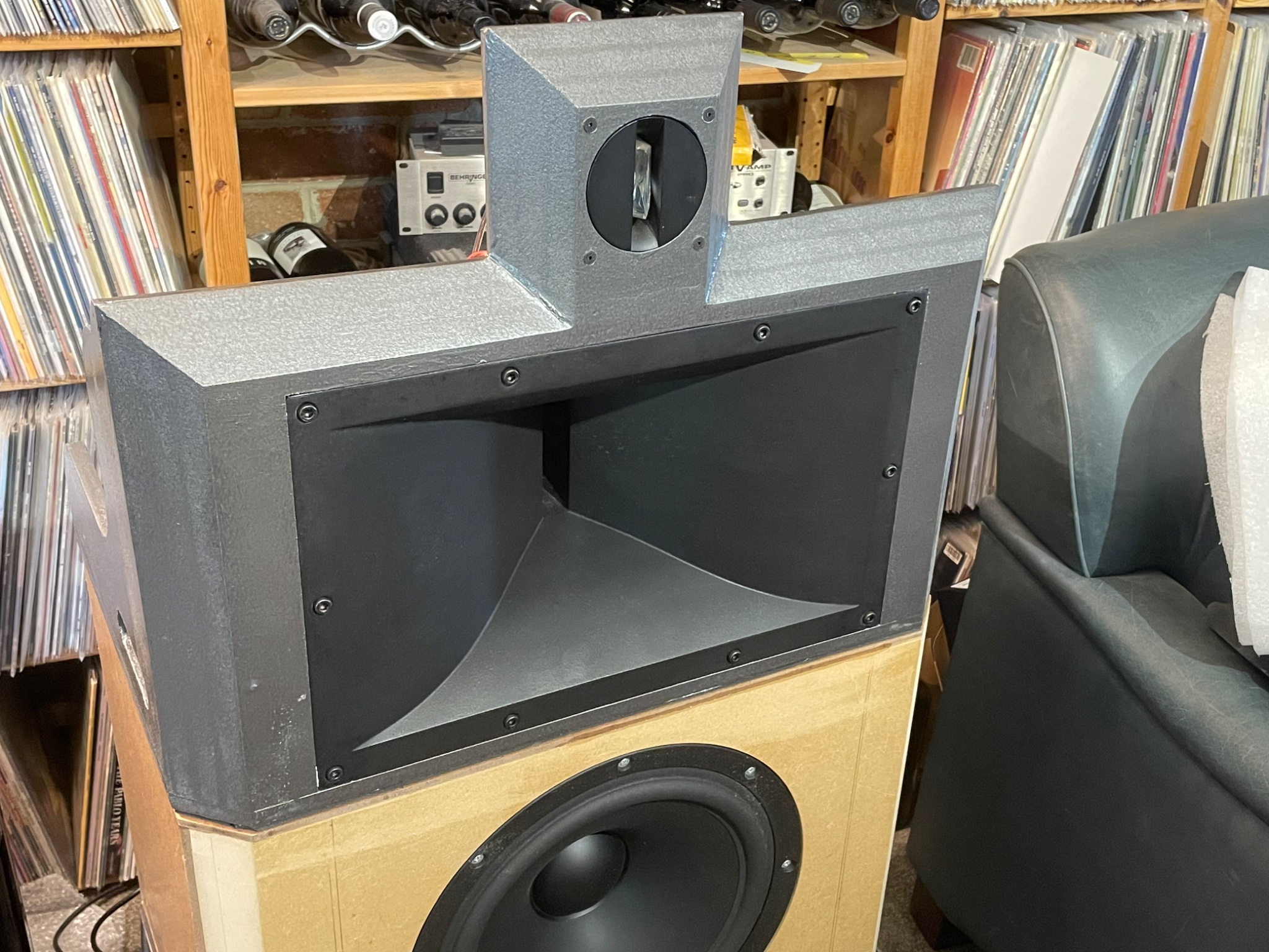

@AllenB. I am assessing my recent build. The mid-range and treble horn frames are 40mm thick laminated mdf with additional 30mm hardwood 1/4 round peripheral bracing. It should be stiff enough. The horn flare is bolted to the frame with 10x6mm bolts but the rear compression driver is unsupported. I see lots of pro audio horns similarly mounted. Is horn flare rear resonance a concern?

My reasoning is, why have an enclosure if it is not necessary to contain rear radiation and rigid support can be achieved in other ways without the mass and size penalties. This is what I am trying to achieve. I can't say that I have noticed any audible issues I can pin on horn rear resonances, but I will take notice of the comments and arrange some sort of clamp support for the rear of the horn. It does occur to me that modelling the horn as a beam, a clamped-clamped beam still has resonances, just at different frequencies to a clamped-free beam.

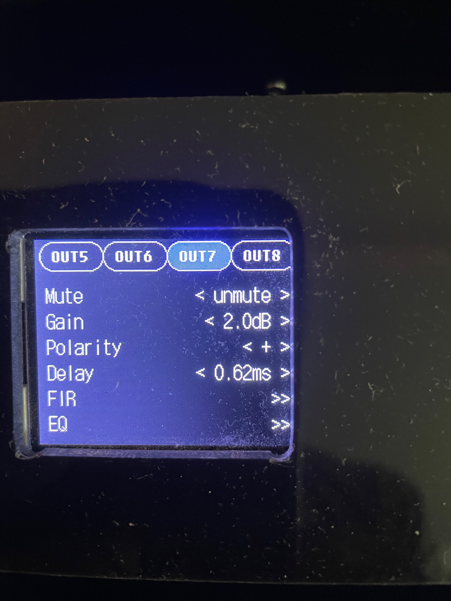

The system is active 3-way using a 192/24 dsp crossover. The tweeter and horn are accurately time aligned. The time delay of the tweeter relative to the mid-horn is determined by reverse phase nulling at crossover frequency and is in close agreement with the tweeter/mid-horn physical offset.
Right; MJK used a flexible ruler clamped to a table top to describe/promote his TQWT designs and I still have a dust mop with different distance taped points on the handle from a local Altec speaker system designer to get me in the right frame of mind when it became obvious he wasn't going to do it with math.
You were wise to confirm this by measuring the distance and cross-checking. The null method can give false positives, and it won't tell you whether you match the slopes.
It's not necessary to use the null method if you can take separate (low/high) time locked measurements.

An enclosure does not necessarily solve diffraction issues, which are principally caused by sharp edges and surface mounted drivers. I give cabinet diffraction control a high priority, as can be seen from the photos in #5 above. The horn/tweeter baffle has a 45 degree front chamfer and the rear a 30mm radius roundover. The drivers are flush mounted.

In the interest of constructive discussion I could point to four areas that I'd be interested in confirming.
1. The size, location of and benefit from roundovers or champhers depends on a few things.
What is getting diffracted there?
how audible is this on a frequency by frequency basis?
How is the smoothness overall in the band and in context of the system it's a part of, as well as including the impact of directivity limitations?
2 & 3. The tweeter and midrange horn are clearly designed on diffraction slots.
4. The midrange vertical dimension is: 1. Based on a narrow angle and 2. relatively short. These represent a two faceted limitation on diffraction control, and the lower frequency support the horn can offer. An asymmetrical horn typically isn't optimal with a flat mouth.
