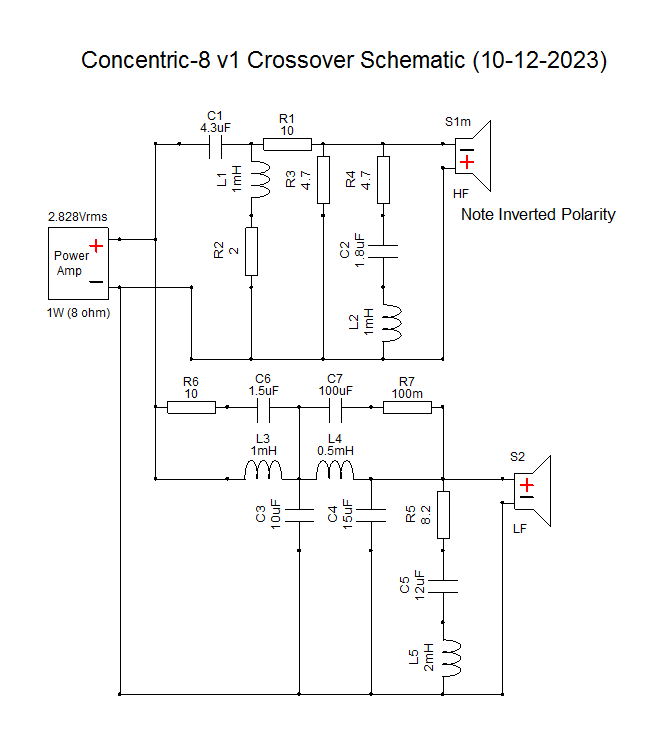

I must have been bored, but had a look at this suggested box crossover for something like your driver:
Hmm... that's a funny looking thing. Not how I would do it. Not what Eminence would do either with a concentric on one of their stock 2.5k crossovers.
What it attempts to do is cross pretty low around 2kHz. Impedance is TERRIBLE. Notches attempt to fix basic design errors.
The main event for you with a DSP filter is probably about second or third order around 2kHz and a lot of attenuation on the tweeter. No idea what polarity comes out at.
