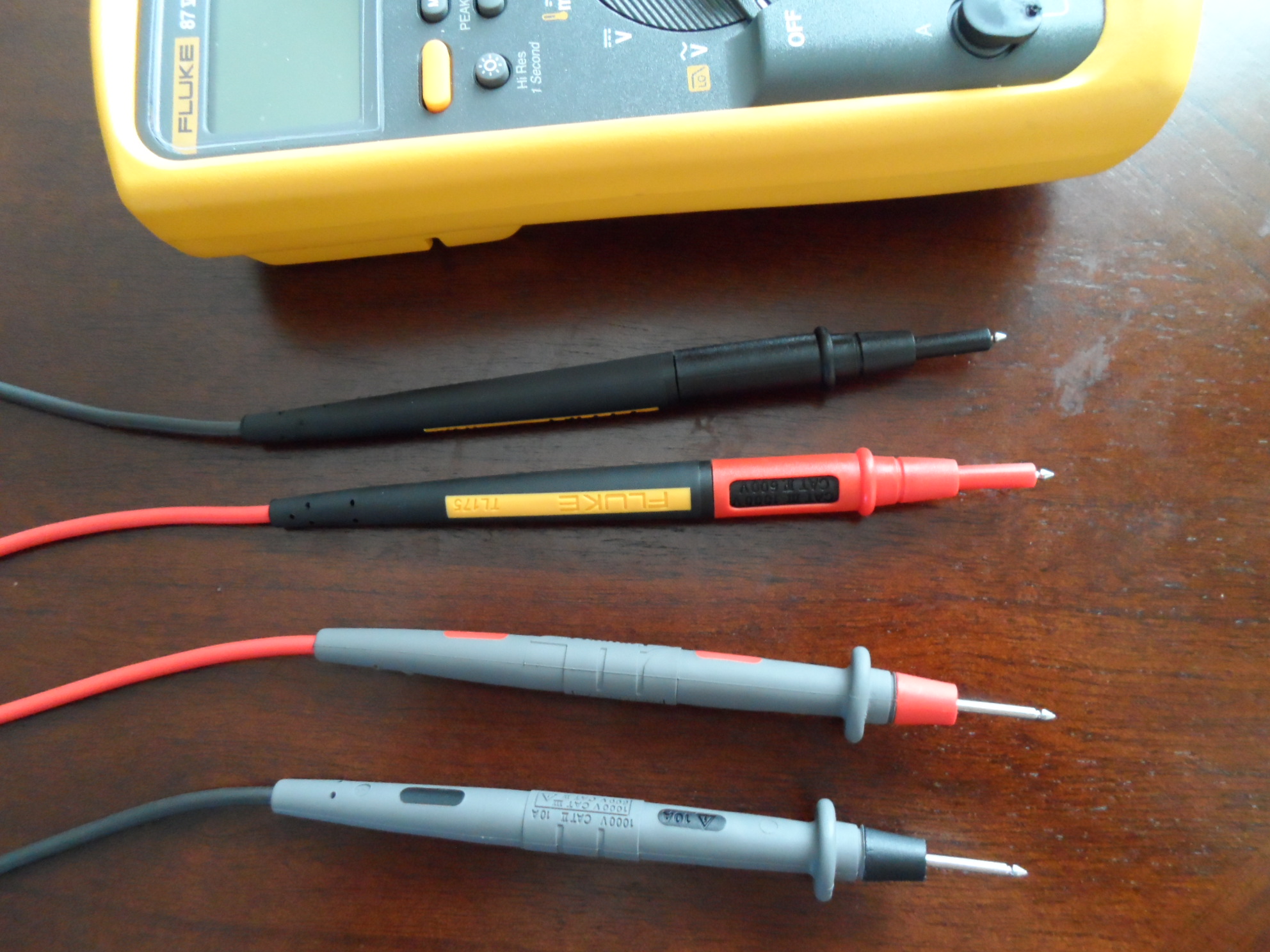

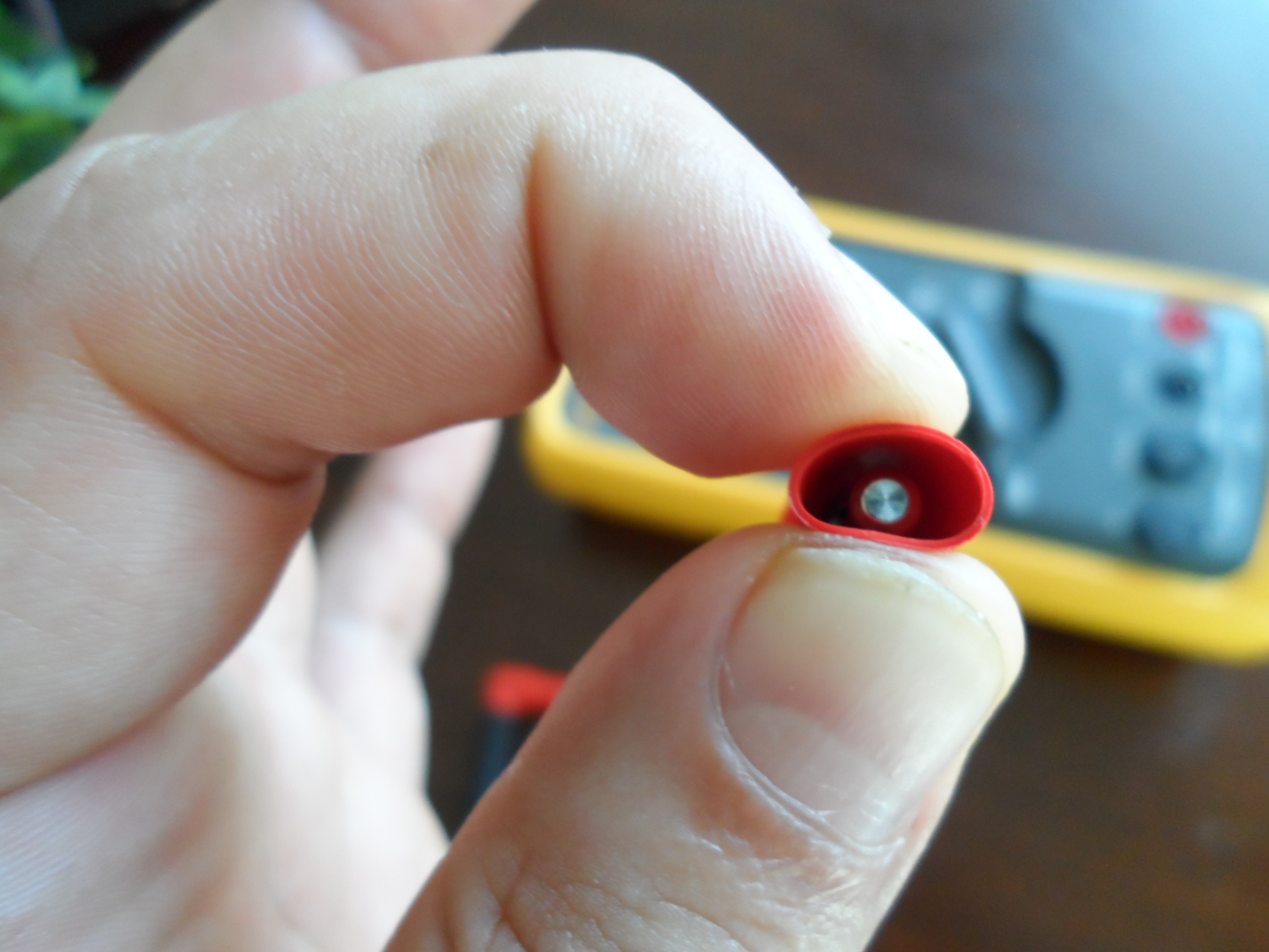

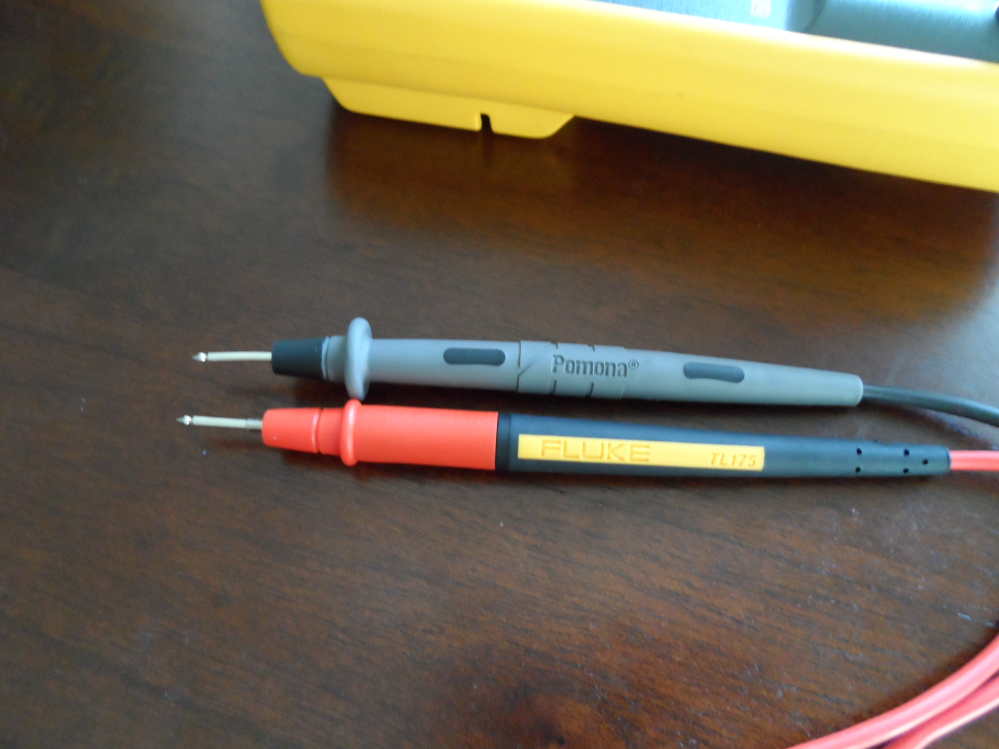

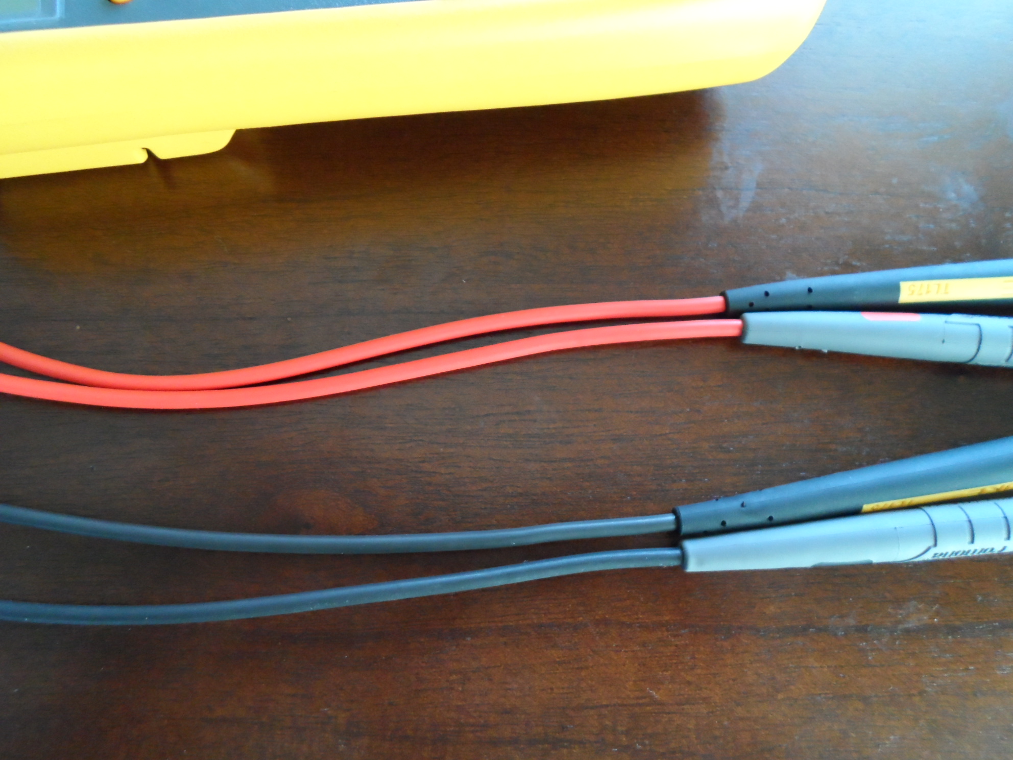

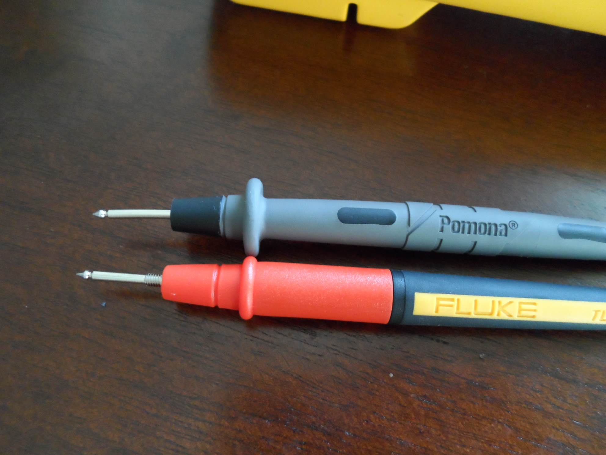

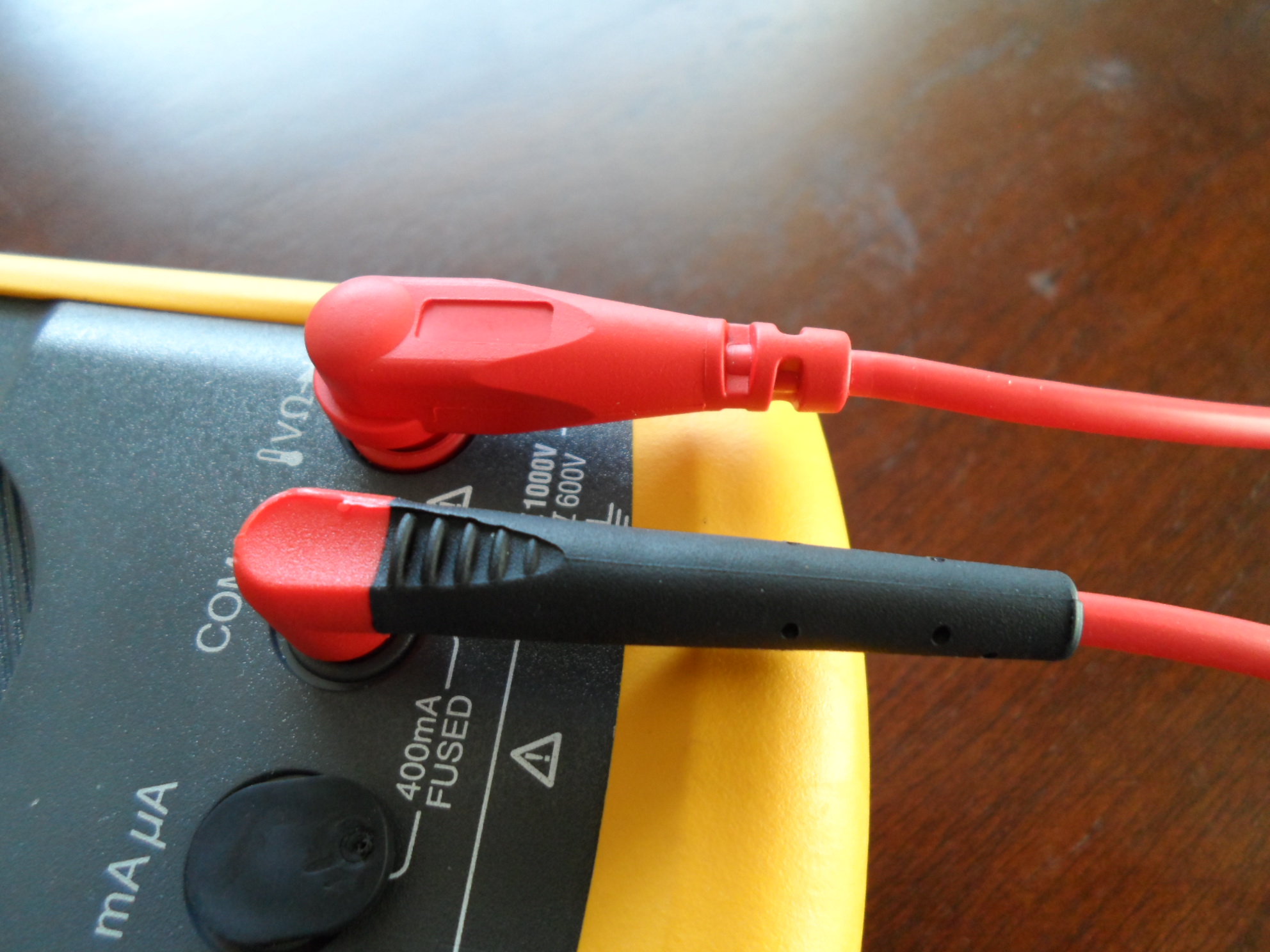

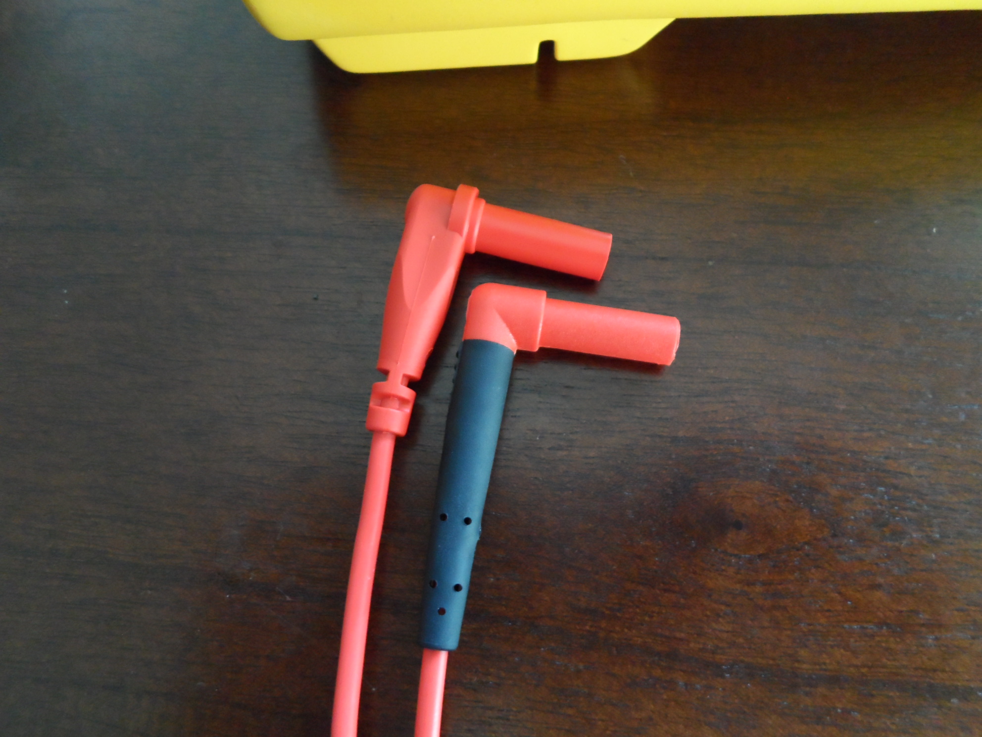

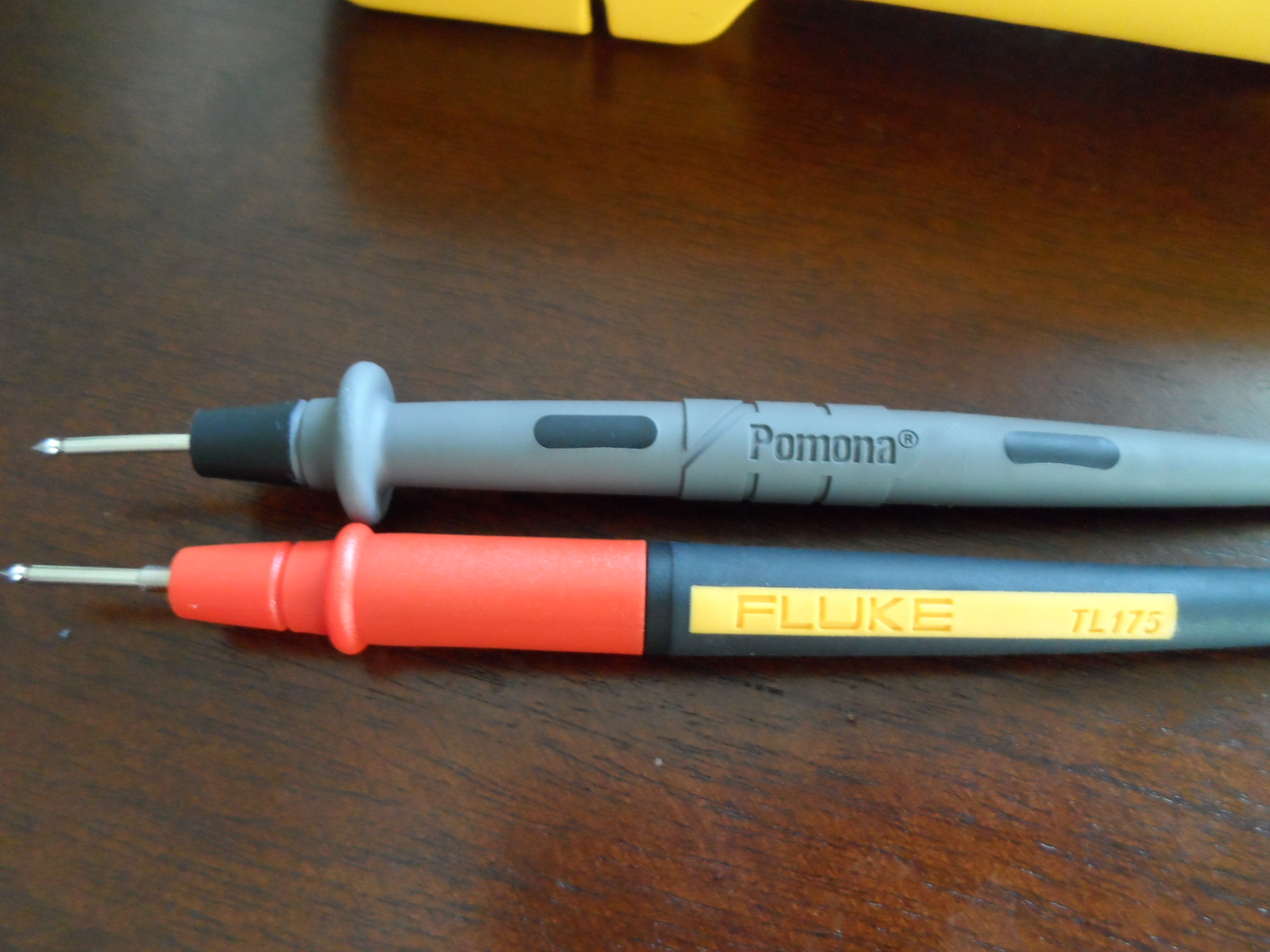

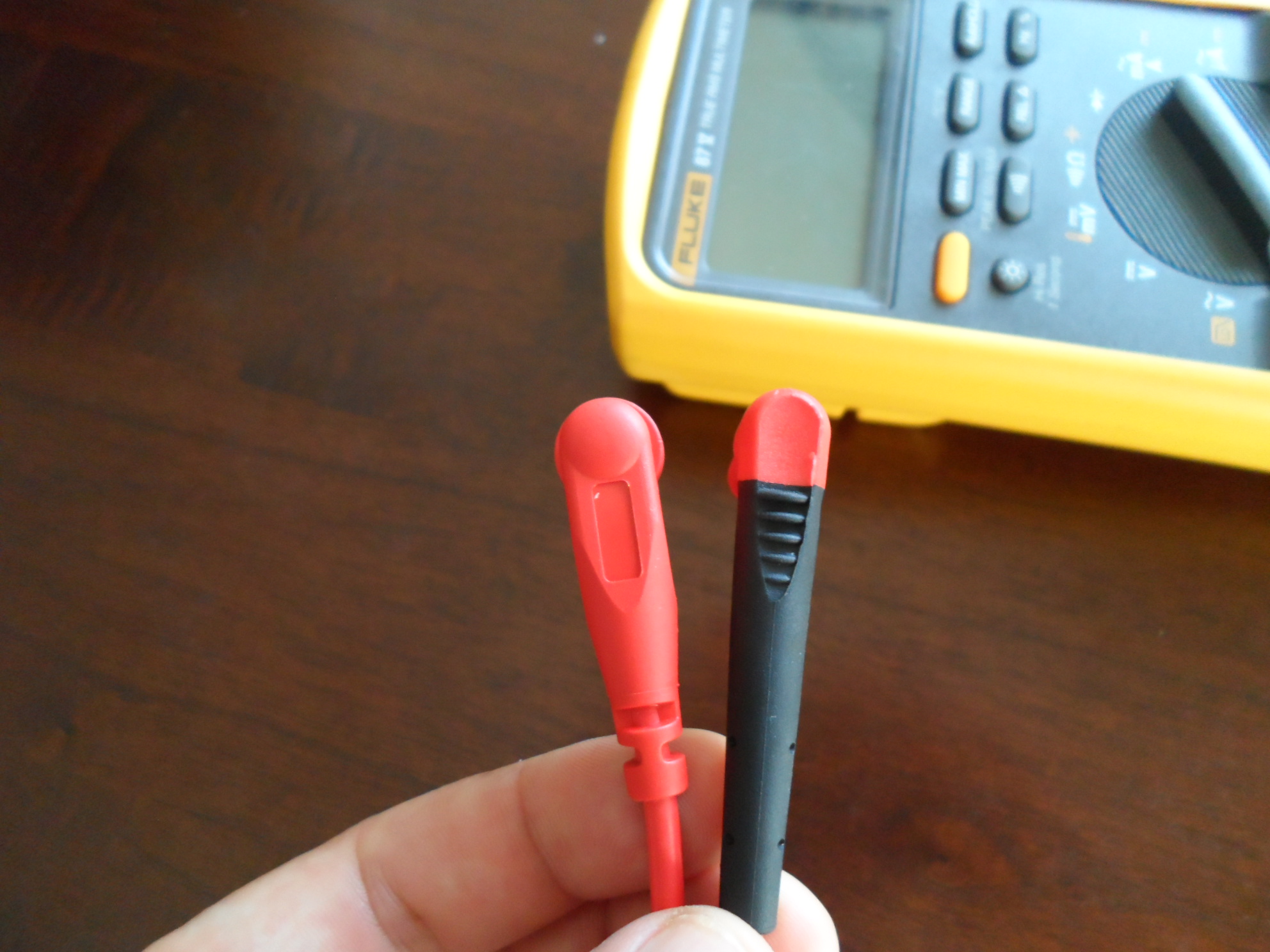

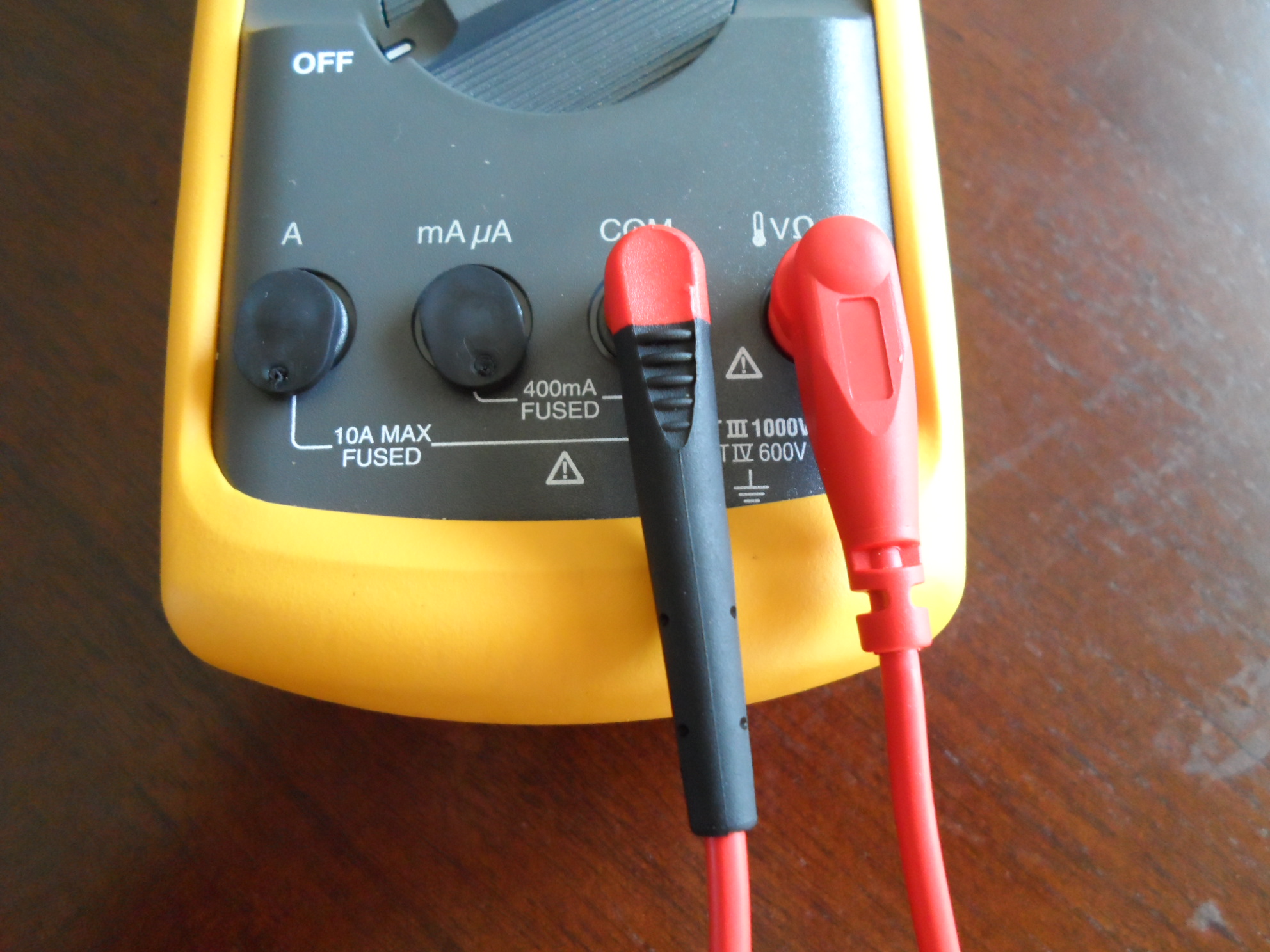

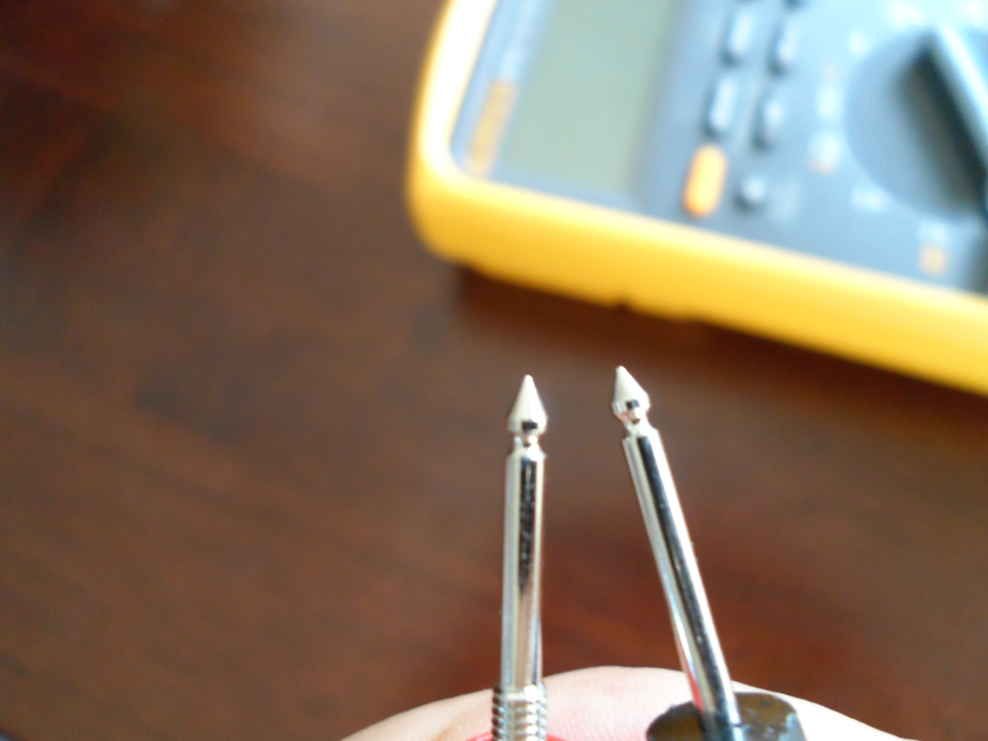

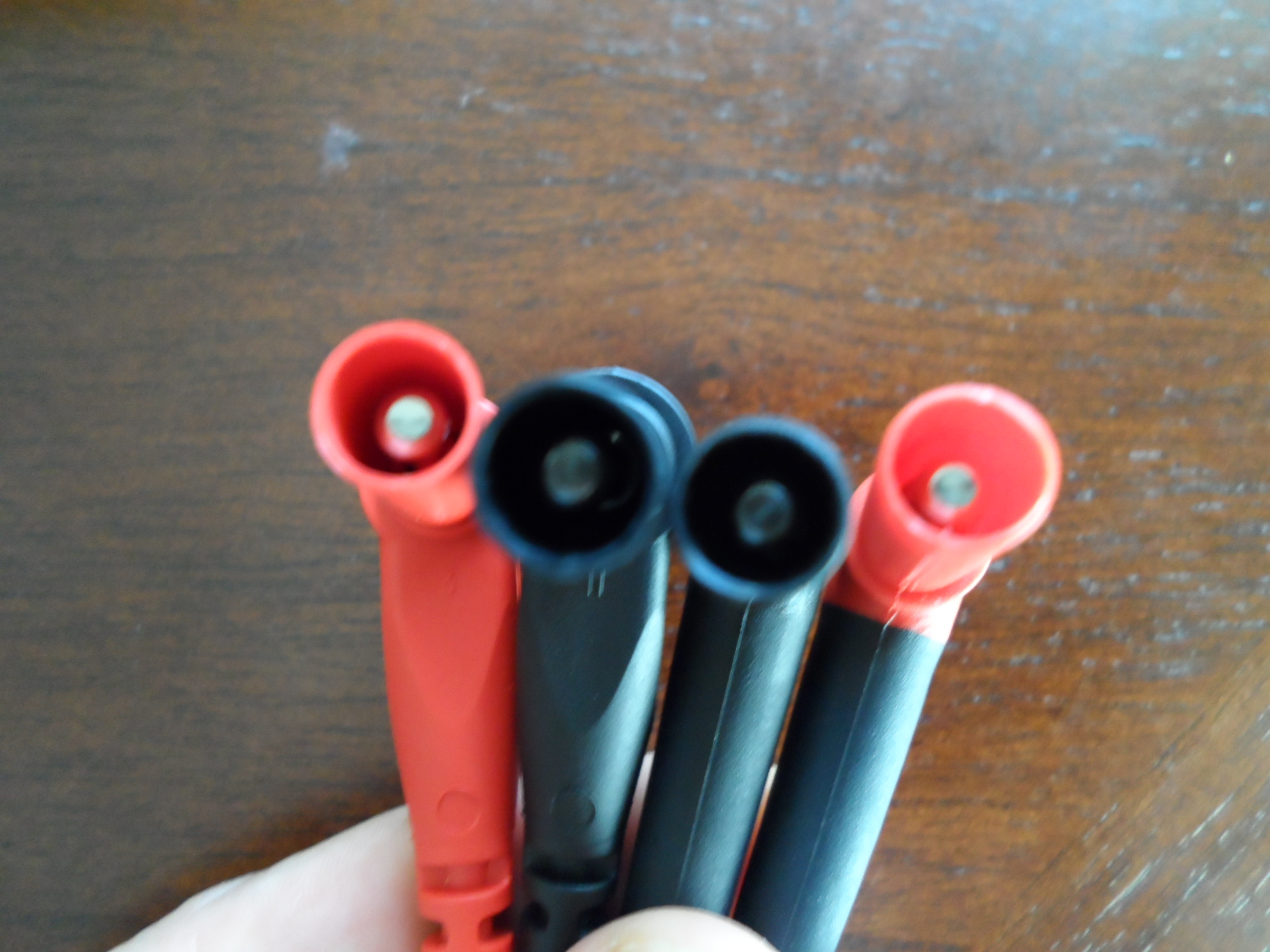

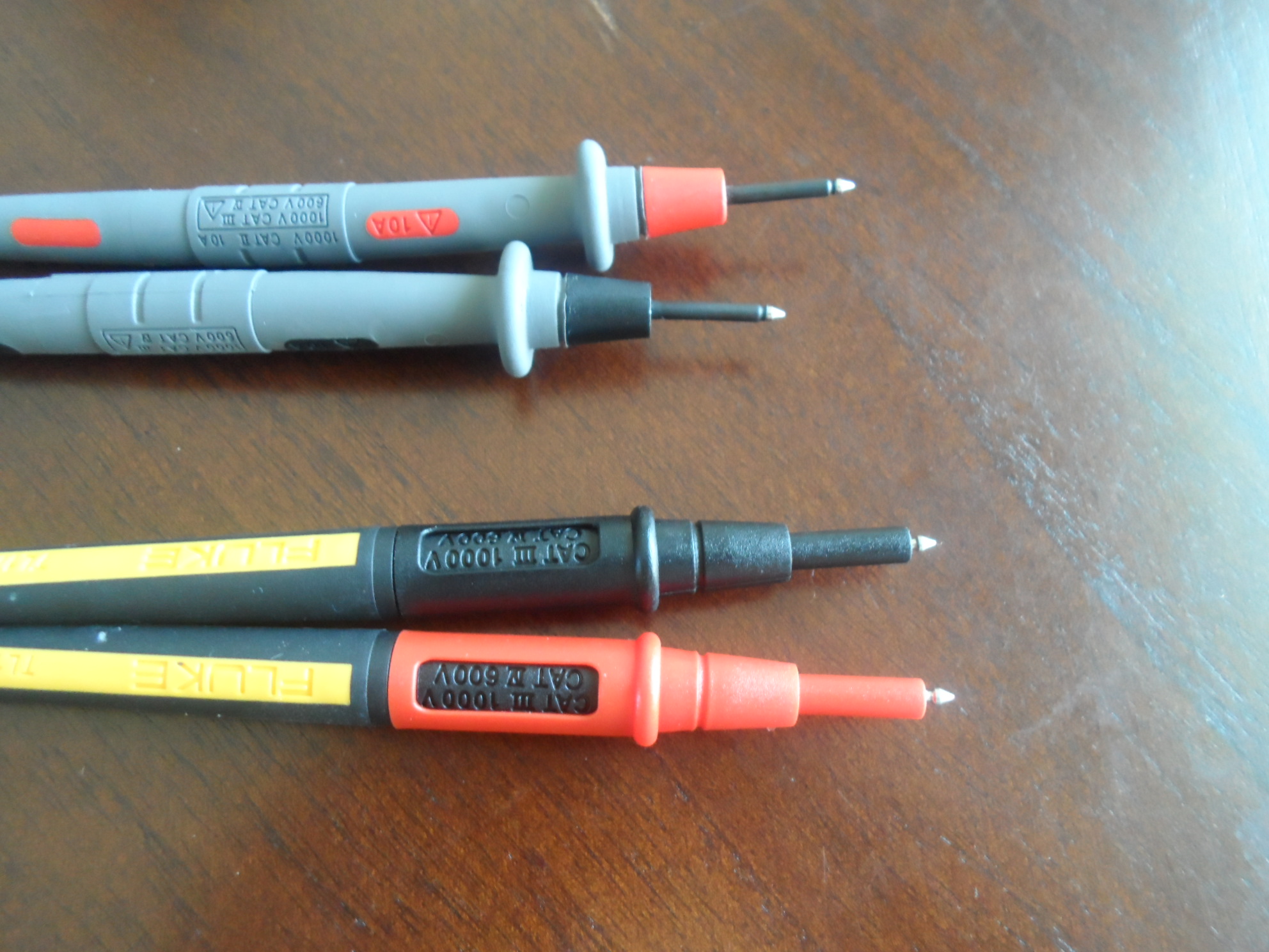

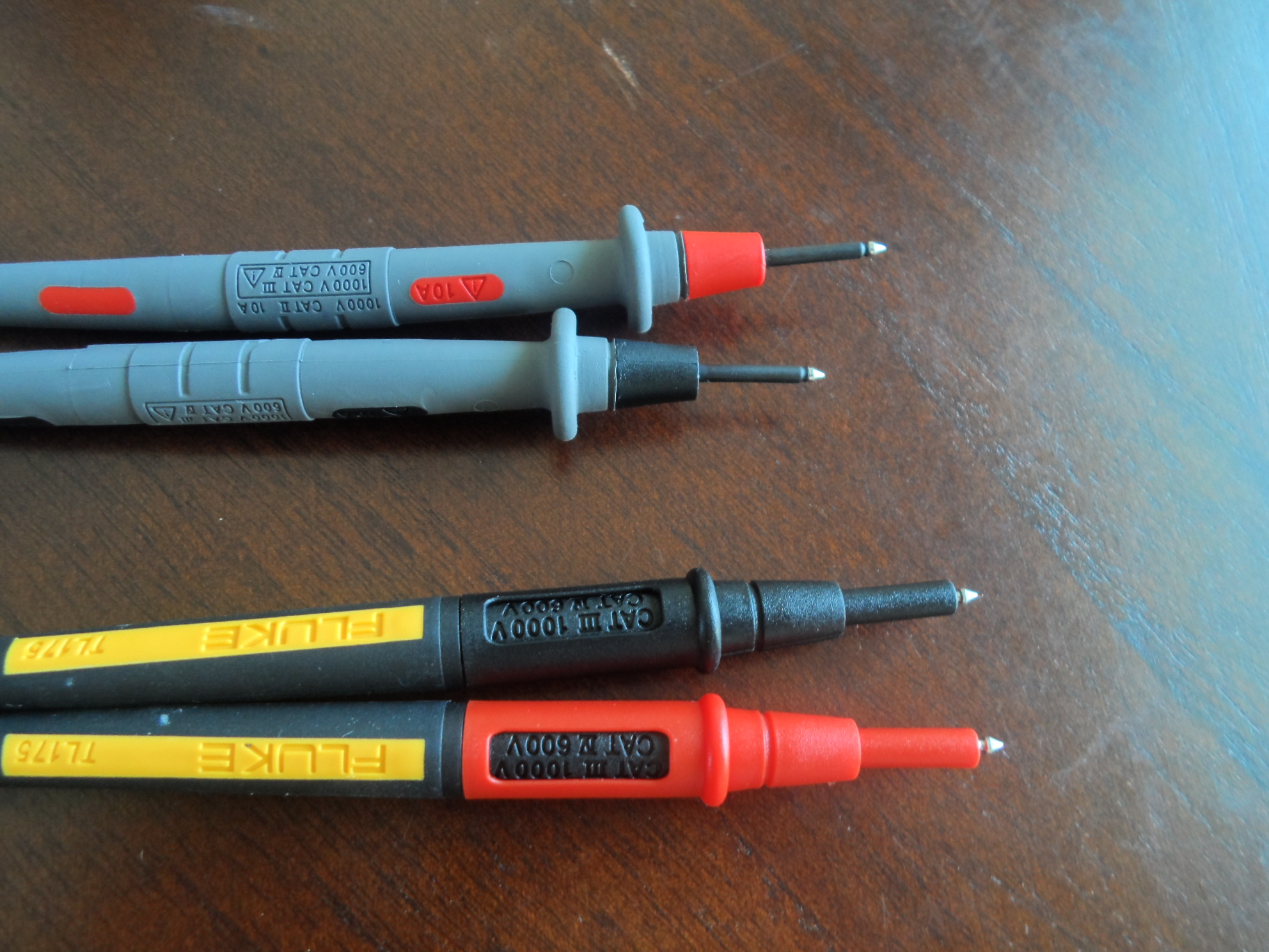

Hello, I just compared two test probes, one is the Fluke TL175 ($25) and the other is the Pomona 5519A ($15). First, I would say both are excellent test probes (silicone wires). But will the "extra" $10 made a big difference in quality? I would say...Not really!. even though Pomona is owned by Fluke, I would say I like the pomona build quality in some aspects. First if you see the picture of the Pomona "flexibility" banana plugs material compared to the "hard" banana plugs in the Fluke. I would say I like the "flexibility" of the Pomona better than the Fluke, because you can not brake those plugs. I say this because I had the Fluke TL75 test probes(worse of Fluke) and I "pressed" a little and cracked the plastic shrouded plugs. I think if I press enough I can crack "easily" the banana shrouded plugs of the TL175. The thing I like the most in the TL175 is the "retractible" tip safety thing. the rest in quality I would say by touching and looking they are excellent probes. I would STRONGLY recommend the Pomona 5519A test probes, they are excellent quality and they are not too expensive.

My conclusion is: "if" you really need the retractible tip thing and the name of Fluke on the probes, I would get the TL175!...other way I would save money and I would get the Pomona 5519A. As I mentioned before, they are both made really well and you can not get wrong getting either one 😉. I can use other brand of test probes, but I will never use a multimeter that is not a Fluke😀

I like the enhanced safety of the shrouded plugs.
I also cover the "exposed" probes to minimise the risk of shorting.

I compared side by side the Pomona and the Fluke TL175 and the ONLY thing that I like in the Fluke better than the Pomona is the ability to "cover" the extra metal test tips. I find it very useful when working in tight spaces full with parts that you can touch by accident (accidents happen) and short out components.
other than that...the Pomona is the winner hands down!.

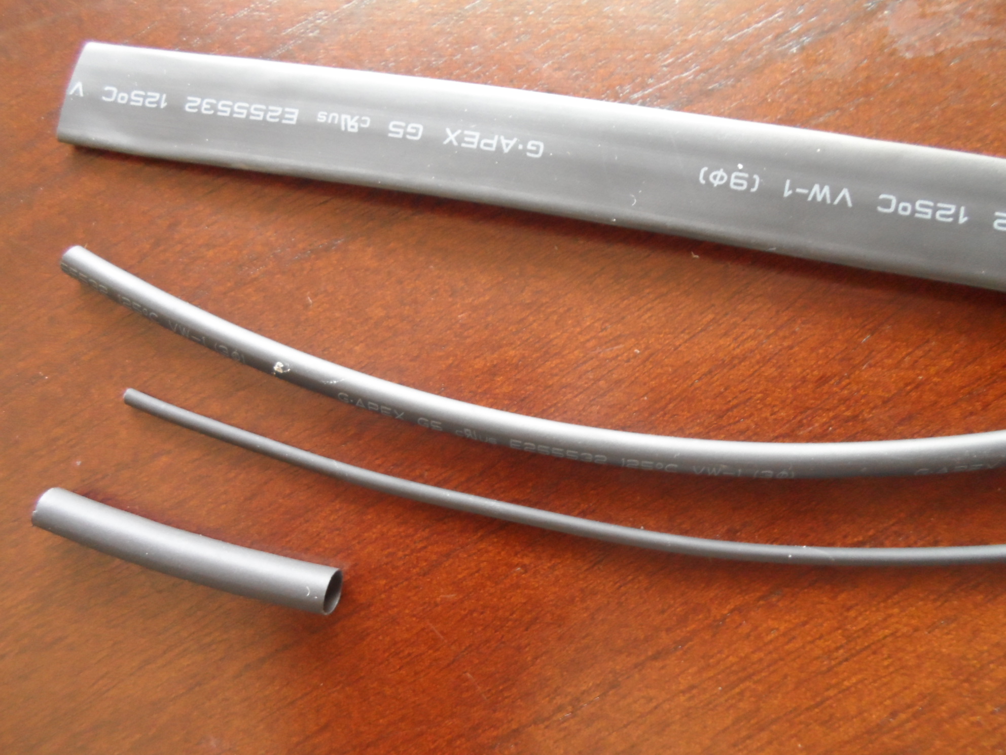

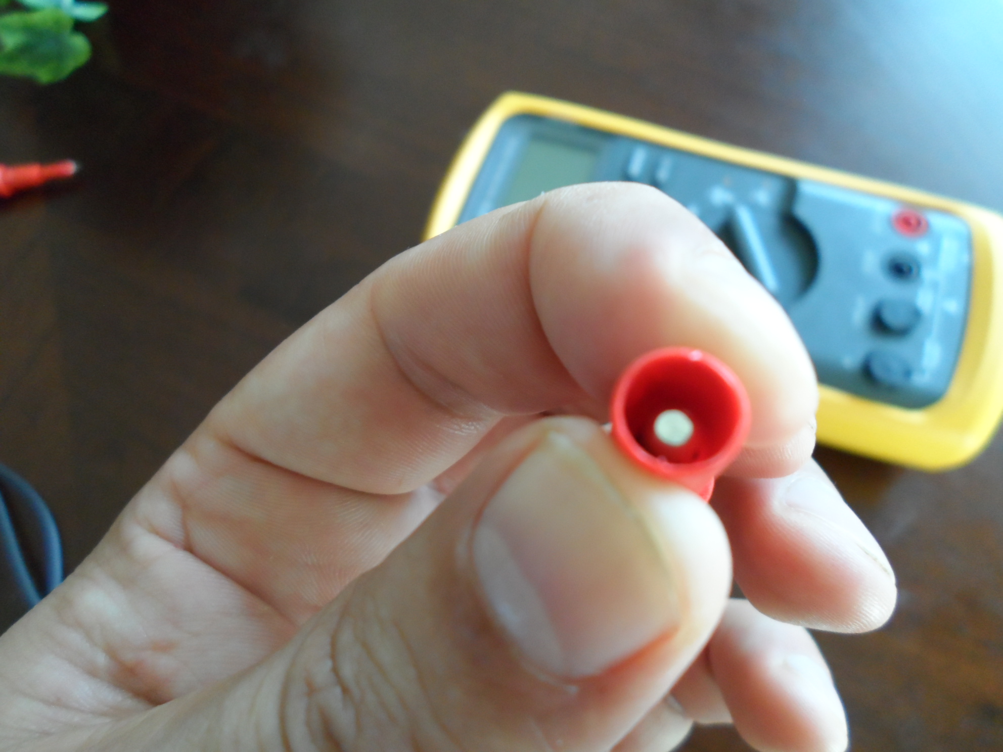

Since I work most the time in tight places where I can short out parts by accident (it happens)...I decided to protect the exposed tips of the Pomona test leads using this shrinkable tubing, as you can see they work pretty well. I know it is not so safe, but at least it is safer than working with all the tips exposed.
PS: To put this shrinkable tubing is not so easy, But if you put some oil (cooking oil)on the tips then it goes easily and after that you apply some heat and it will be very tight! I used regular cooking oil.
