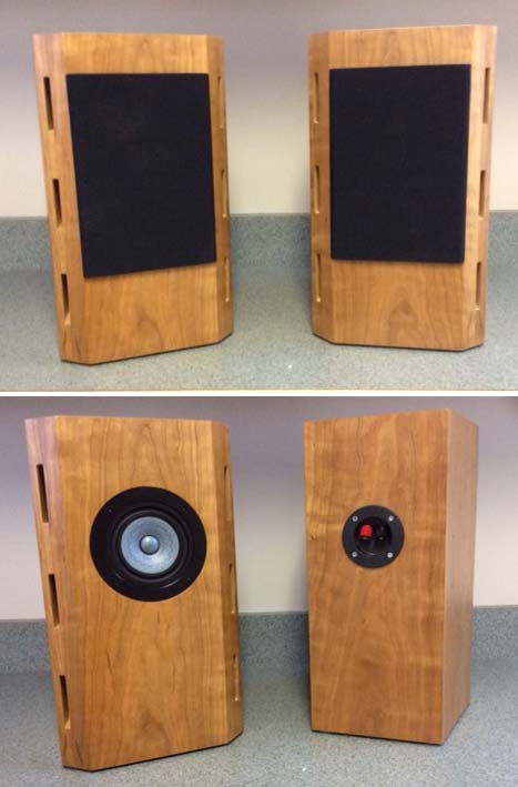

The A7.3eN ones don't currently have drivers (so a brand new set would be installed), with a fresh set of drivers $650
Attached is with A7p installed. That didn't work out so well.

I can stretch the budget to $650 for the A7e-onken, what kind of veneer is available??
The boxes with the A7p are very pretty!! They look tall, about 20 inches??? And the finish is....????
At that price you get the prototype ones with new drivers. About 16" tall i believe. Finished in cherry veneer.
A bespoke pair from scratch with grills would run near double the asking price of this pair of demos.
