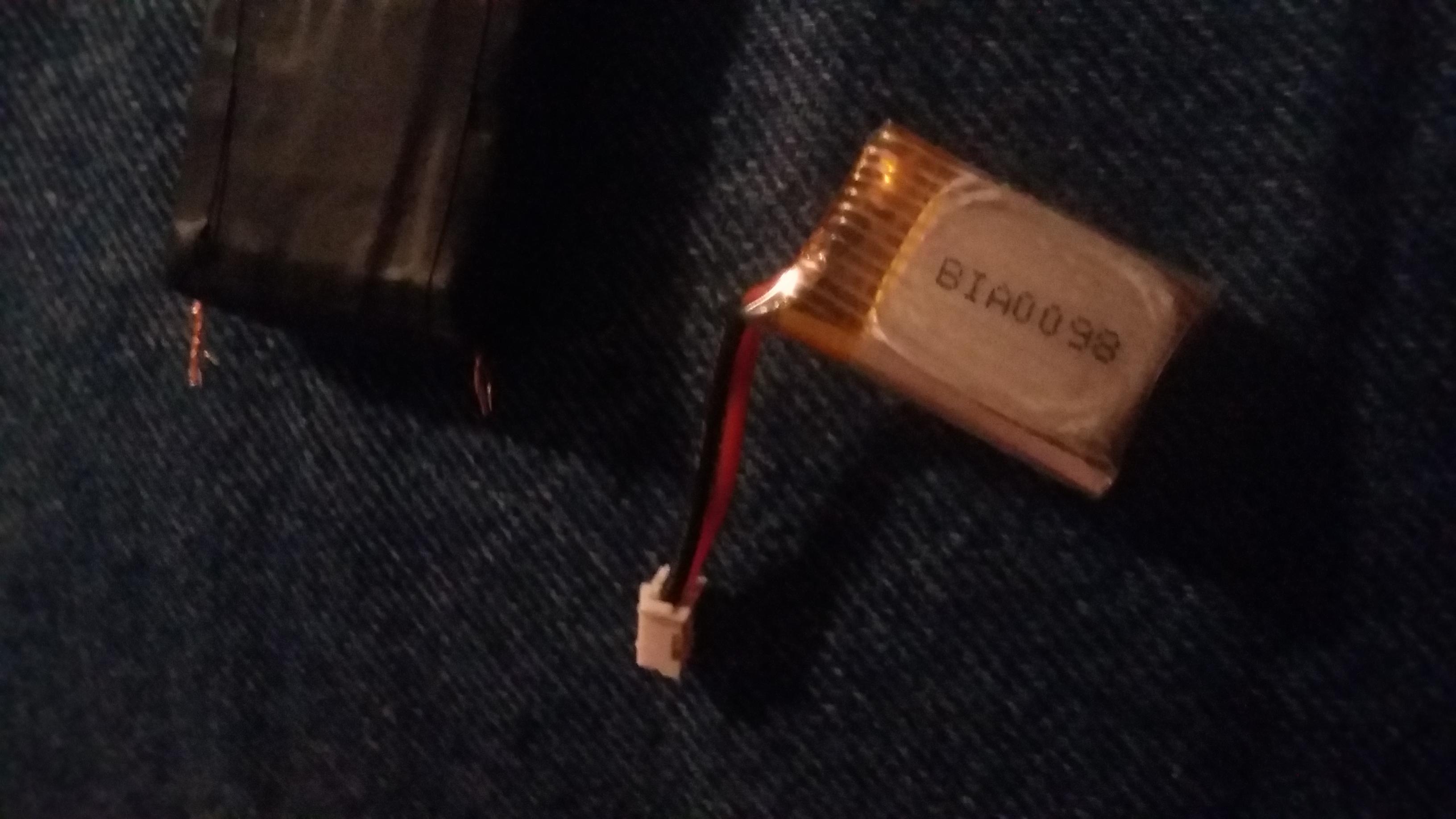

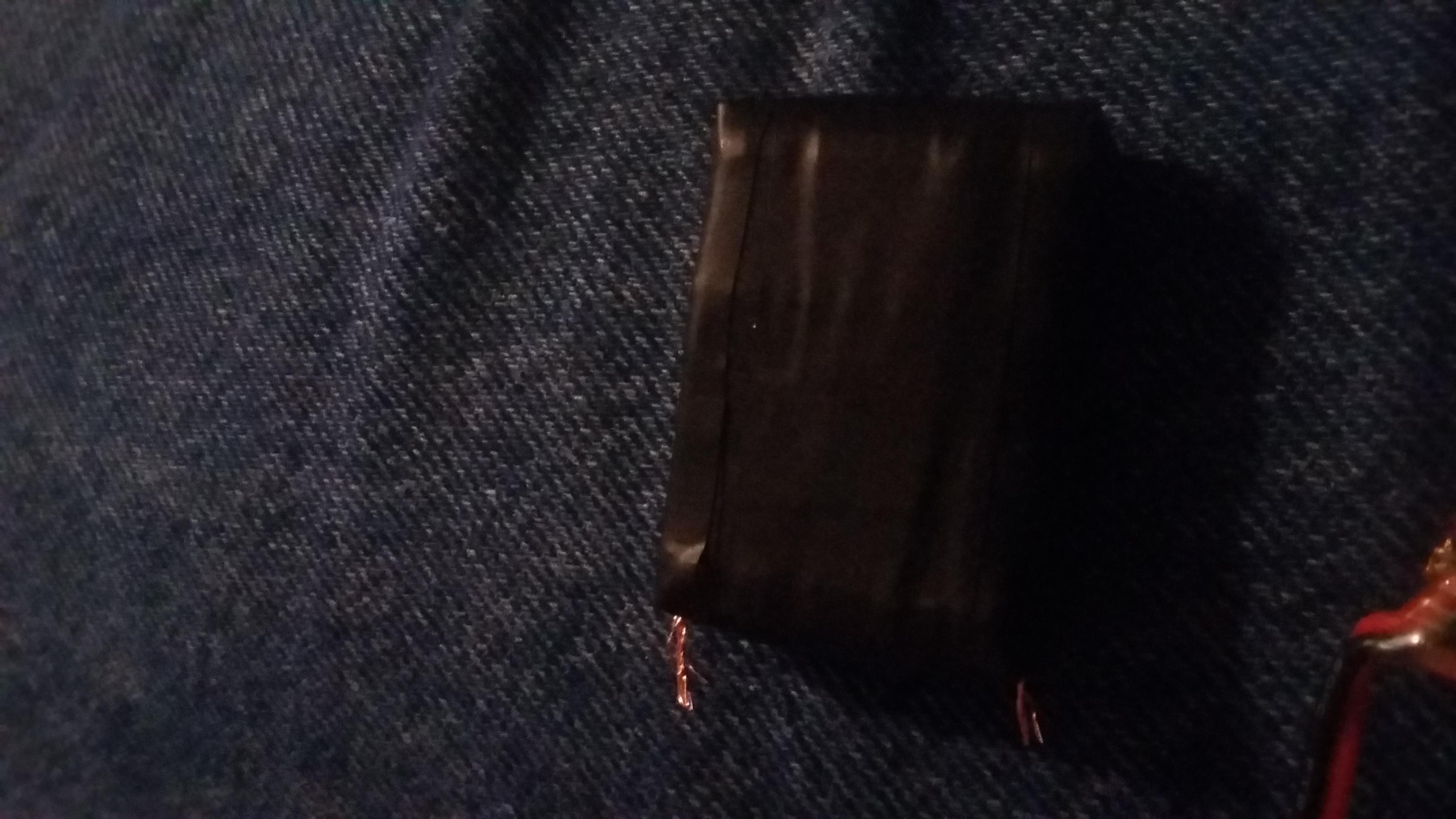

The only problem i have using the A23s is the casing. I molded it off of a 2 inch prototyping board and its slightly larger than 2.15 inches. Although i could try to fit the A23s but itd be a very tight fit

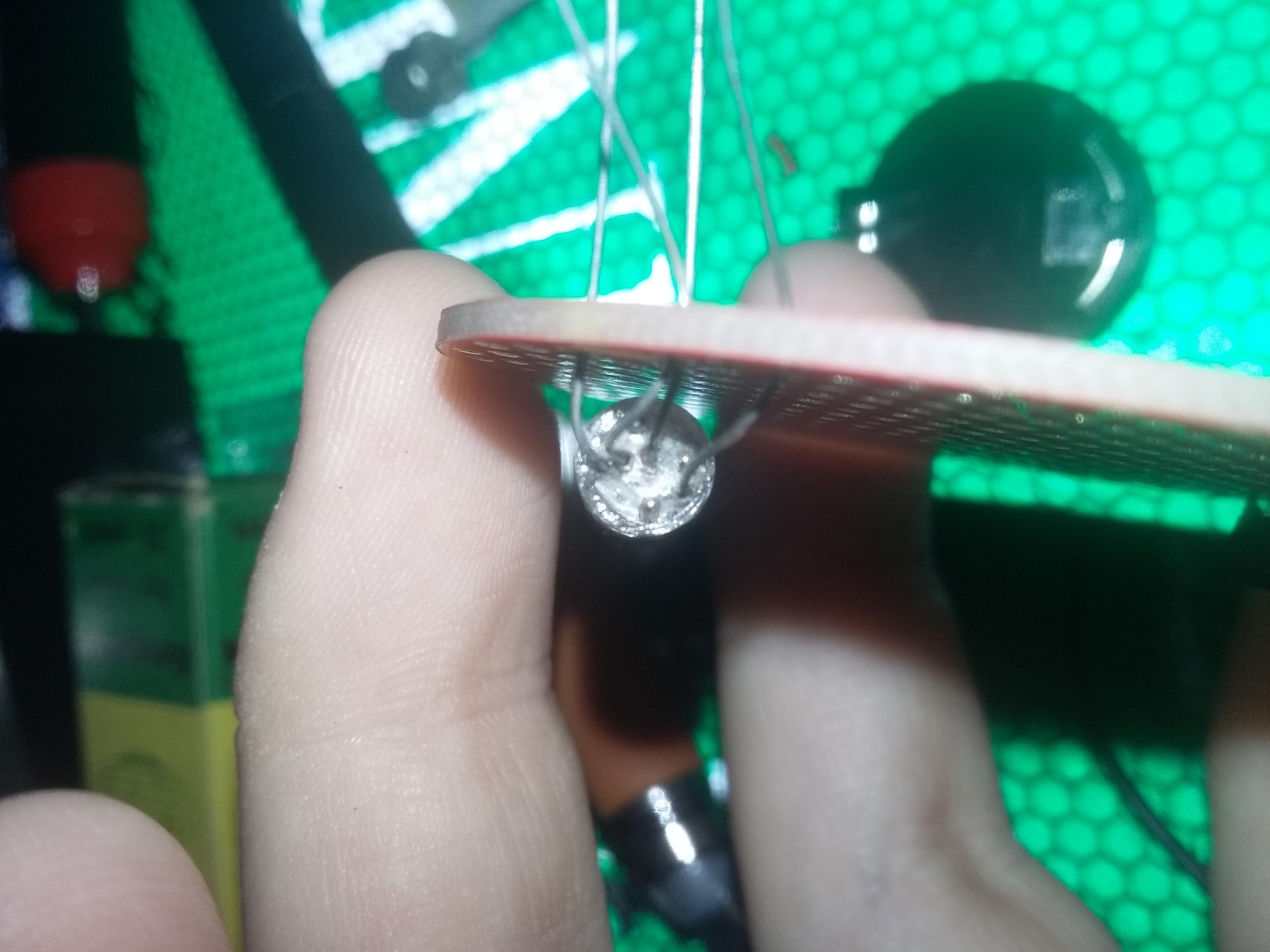

Plus the dm160s i have i cant clearly distinguish the pins but i have found the filament leads but i dont know which one is anode or cathode

I have the a23s but i cant get the grid to light up
