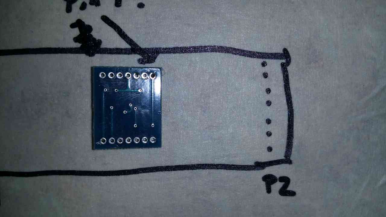

This is the board and the chip, I've tried to give it +-15 without HV but didnt find any signals on any pins by scope. https://scontent.ftsr1-1.fna.fbcdn.net/v/t1.0-9/fr/cp0/e15/q65/14590290_10157502820100514_3239227447661610118_n.jpg?efg=eyJpIjoibyJ9&_nc_ad=z-m&oh=104c646243ef47da1961d56433ad6def&oe=586A9E73 https://scontent.ftsr1-1.fna.fbcdn.net/v/t1.0-9/fr/cp0/e15/q65/14590290_10157502820100514_3239227447661610118_n.jpg?efg=eyJpIjoibyJ9&_nc_ad=z-m&oh=104c646243ef47da1961d56433ad6def&oe=586A9E73 I hope these links work. Thank you Perry!
This boared Ive posted is from my amp but I assume rev no 4 board with the 2 chips use the same basic board parts. So I think I colud build a control board. Any solution would work if someone lets say "hacked" it.

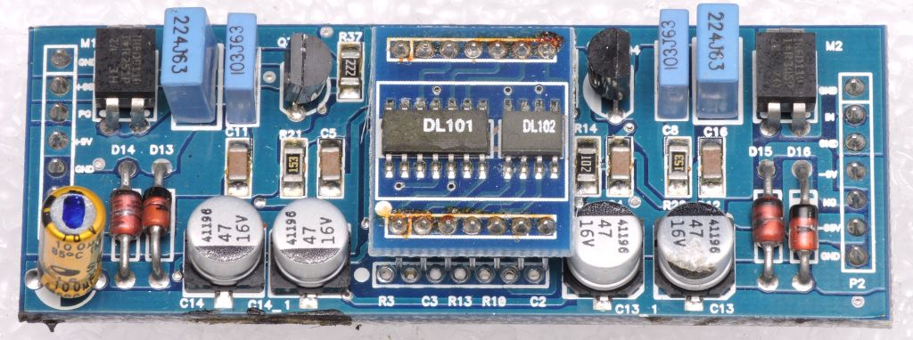

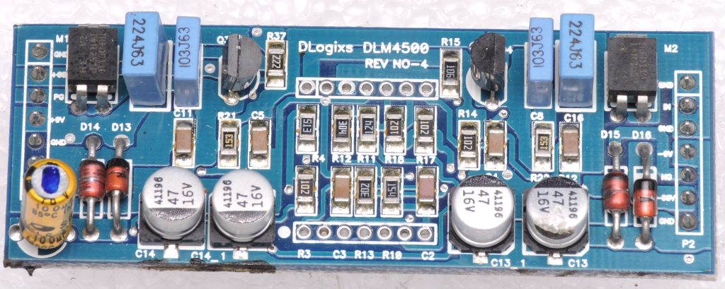

I don't have a diagram but you can compare your board to the photos below to see if they are otherwise identical. I don't have a photo of the underside of the 2-IC board.
Perry, is there any chance that the DL101 on these is not some custom IC? I have a old Autotek MX1500 that someone stole that IC out of. I am guessing it is the proprietary Dlogixs controller?

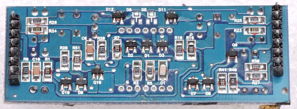

Jason, could you please post a pic of the bottom side of the smaller board if its available?
Better late than never I hope! Here you go, I am sorry this took so long. I actually forgot and picked up the amp today to inventory what parts I need and I remembered you needed this picture, so here you are. This is the best I could get for you. I have higher resolution if you need, I can email. I also have more pics of the amp overall that I am going to be starting in a moment...

Thank you Jason that you didnt forget about me! I appreciate that and if you have a better resolution pic of the first one I would be really happy to have it. My email is topguy9014@gmail.com thanks again Jason and also big thanks to Perry!
It's no problem. I am sorry I took so long. I do have higher res pics, I'll email momentarily. I thought you were actually looking for the pics of the back side. I still have the board off and am going to pull the DL102 as well so I can take some better pics later if you need. I won't be off work again until next Friday though. I work shift work, 12hr days/nights and this is my long week on...
