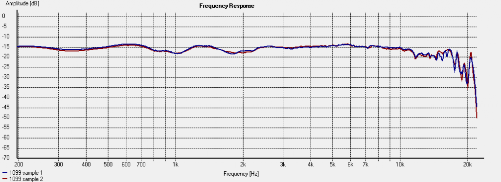

Thanks to a local who loaned me his 1099's, I was able to put them on my Klippel Near Field Scanner and get full SPINORAMA data for these speakers. I have also provided additional data such as impedance at varying levels, distortion and a few forms of my own compression tests. It would be a nightmare to link the images singularly here so I'm going to link to my website directly:

and this is how they claim it measured, gated.
Maybe some of the difference can be partially explained by the accuracy of the measurement mic used during speaker development. What Erin has is really SOTA.
I have a CSL calibrated microphone; however, I plan on borrowing a friend's Earthworks mic to see how close to two mics measure.
