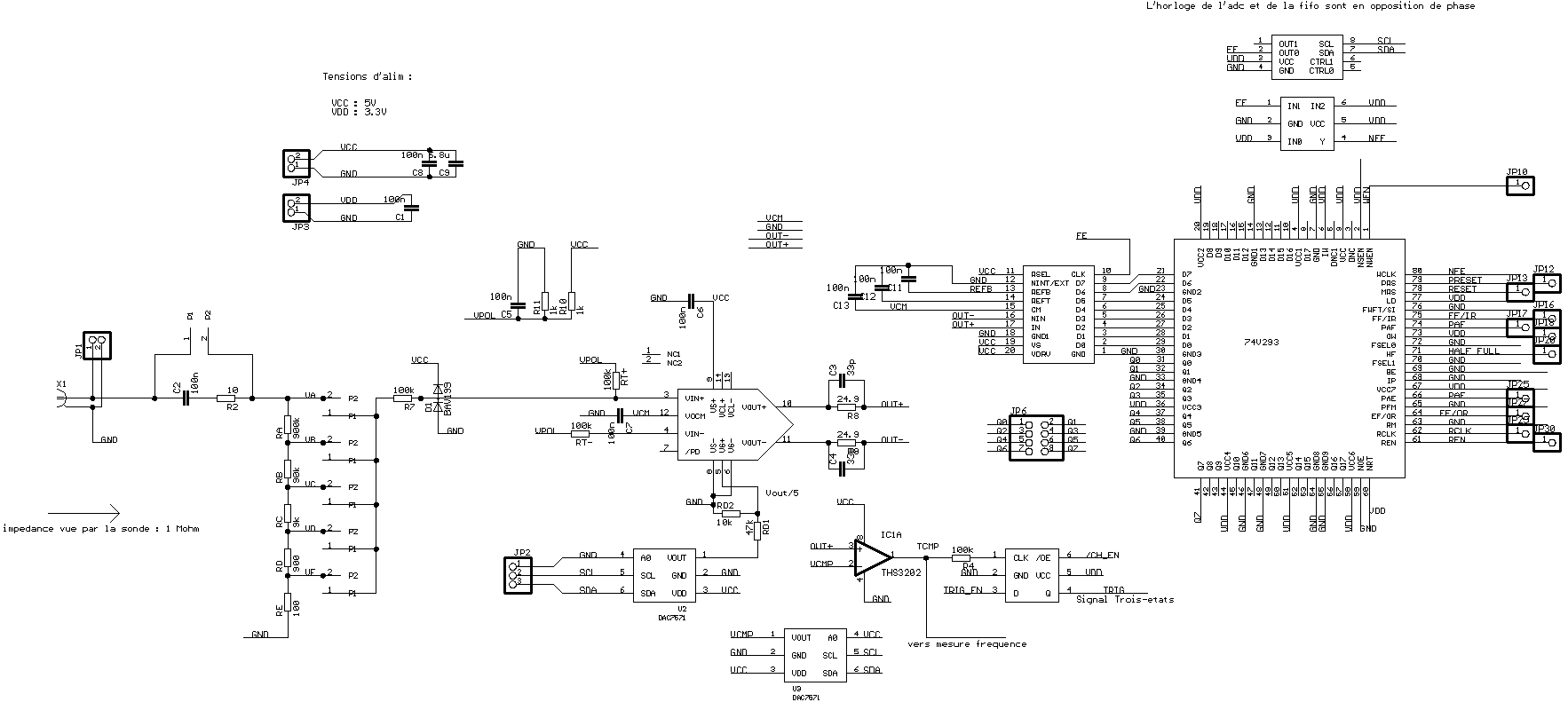

The plan sofare is to create a handheld DSO capable of doing pretty much anything and more of its analog equivalent (cheating of coarse).
I'm not too interested in all the extras i can incorperate through software at the moment since it would be useless without some base hardware to develop for.
Sofare the specs stand at -
DS89C450 - 4 8 bit IO's, 64kb of program memory, 33 MIPS @ 33 Mhz
SN74V3690 - synchronus FIFO, 32768 x 36bits, 133Mhz max, 5v tolerant
2x ADS5500 (or slower equivalent) - 14 bit ADC, 125MSPS
Graphic lcd of some undecided size
The uC I chose should, by all means, be fast enough to display everything. The FIFO acts as a storage buffer with the ADC's constantly running whether the FIFO is full or not. Once a refresh needs to take place, the FIFO can be reset for fresh data and read by the uC. To have enough room for all the IO's, the FIFO can be read on an 8 bit bus whilst still being able to take data at 36 bits.
The true potensial of such a accurate scope wouldn't be used whilst its outputting to the graphics lcd. If you think about it, even if its 320x240 pixels wide, thats only 320 samples it can fit across the screen at most. The true potensial would be used via USB (or maybe something else??) to connect to a computer to provide, very simply, anything we can possibly do with the ADC data.
The only software issue I'm going to mention is trigering. Do most scopes just trigger at a regular interval or do they try to match the waveform previously sampled?
Optional features such as a logic analyser might be able to be included but IO space is at a premium. If an IO expander is used speed is greatly reduced in most cases which would limit the use of the feature to lower speed logic.
Thing such as input buffers, I don't have alot of information about.
the bitScope site has schematics of thier input buffer, but its only capable of +- 5v. Does anyone know of a better way to get a larger input voltage and/or a way to control the range digitally?
A range of +- 60v would give you 600v with a 10x probe which would be ideal.

I'm building a scope at the moment, not handheld though but PC based.
The problem with the FIFO method is that you can't have any pretrig (that is save data before the trig point). Instead I use a regular synchronous SRAM as a circular buffer. I save data all the time while waiting for a trig and then I stop a preset number of samples after the trig point. This memory is hooked up to a FPGA that also handles trigger logic, downsampling and other things.
I think the most difficult part of a proper scope design is the analog input stage. Most likely you want:
High input impedance so you can use ordinary probes.
AC/DC coupling
Variable attenuation and amplification so you can change "volts/div".
Variable DC offset.
High bandwidth.
Low noise.

In addition to all the above, you want "input protection" -- no use spending dozens of manhours designing and building and then fry the thing with the inadvertent application of an over-voltage.
In addition to high input impedance, 50 ohms is nice!
If you want to skip the input massaging perhaps using a surplus Tek or other vertical amp would be possible...

My design is partially inspired by that one, although I had remarkably similar ideas even before I found that site (great minds think alike 😉 ).
The biggest flaw with that analog design IMHO, is that it's too complicated. Too many opamps... Also I think having no 1:1 setting on the input attenuator is a waste.
My current design has a JFET opamp (OPA655) on the input, two gain stages (5x and 2x) and drives the ADC single ended. Only three opamps in the signal path.
The DAC is used to set the DC offset, there are two reasons for having it adjustable.
1) Compensate for the offset in the gain stages.
2) DC-shift the input signal to make better use of the ADC resolution when the input isn't centered around 0v.
My design also controls the ADC reference voltage with a DAC, to compensate for gain errors and also provide a little extra "virtual" gain.

If you look at the Linear Tech application notes for the LTC1446 DAC there is a schematic for autoscaling which you might want to implement.
with respect to offset, there are precision op-amps with auto-offset features (from TI)
if the device is going to have any meaningful bandwidth you might want to consider using op-amps with "disable" function rather than inserting switches in the signal path. TI will send you samples.
When you begin talking of inputs in the 1kV range you are entering into a different strata of measurement and control. Note that some resistors become non-linear over a few hundred volts, note also that with just a little current you can fry a resistor that isn't rated for HV.

That's right, 1:1, 1:10 or 1:100 and then 5x or 1x gain, fixed 2x gain and an additional 2x selectable gain by lowering the ADC reference voltage.
I only have the very messy eagle schematic I made when laying out the board for this second prototype. I will draw a clearer, simplified schematic and put it up on my site soon.
Also, it's not actually my final design. I already have some changes planned for the next (hopefully final) version and I will probably make more after some more testing of this version.

If you disable the opamp the output goes into a high impedence state, so the only way switching gains would be to cascade to opamps and have one on whilst the other is off. Swithcing between them will cause the switch in gain, the only thing is, if you cascade them the external components would interfere (well I assume so) because parts of the feedback would be tried to ground which i assume would alter something (frequency respone, output swing, feedback?).
The THS7002 would be an easy way out by sacrificing bandwidth (-3db at 70Mhz). Although its unlikely I'd be measuring a signal greater than 70Mhz it'd still be nice to have the extra bandwidth, but it is an option.
With the auto Offset opamps, do you know which one you are refering to? I had a look at the precision section quickly but none I looked at say the adjusted to drift, but only had very little of it.
Also in relation to measuring a 1kV signal, The input stage should never see the full 1kV. Using a 10x probe, the kV signal is reduced down to 100v and fed to the input stage.
Arn't the ratios 10:1, 100:1 instead of 1:10, 1:100? Otherwise you owuld be amplifying the signalThat's right, 1:1, 1:10 or 1:100 and then 5x or 1x gain, fixed 2x gain and an additional 2x selectable gain by lowering the ADC reference voltage.

Another dso project
Hi there,
I am currently doing a prototype dso using THS7530 variable gain amplifier from TI for input stage.
the first DAC7571 sets the gain and the second makes the trig level.
The adc is a ADS831 (8bit - 80 Msps)
The sample clock is generated by an econoscillator from maxim (DS1085).
See the attached schematic.
I am currently evaluating the analog part.
What do you think of this design ?
Sorry for the large pic.
Bye
