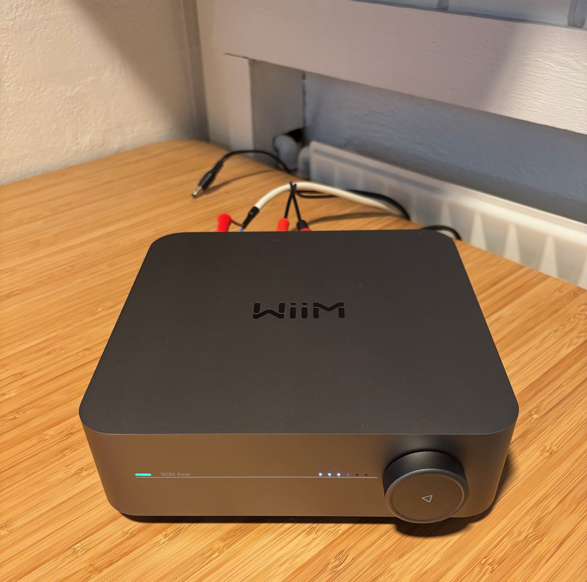

Seaching for an Amplifier and here it was: WIIM Amp!
What a great peace of an equipment, it got it all: HDMI input, Streamer, Graphic/Parametric Equalizer, Room Correction…
The equalizer part is very importend when placing a speaker directly on the wall!
I cant see how others can manage it without?

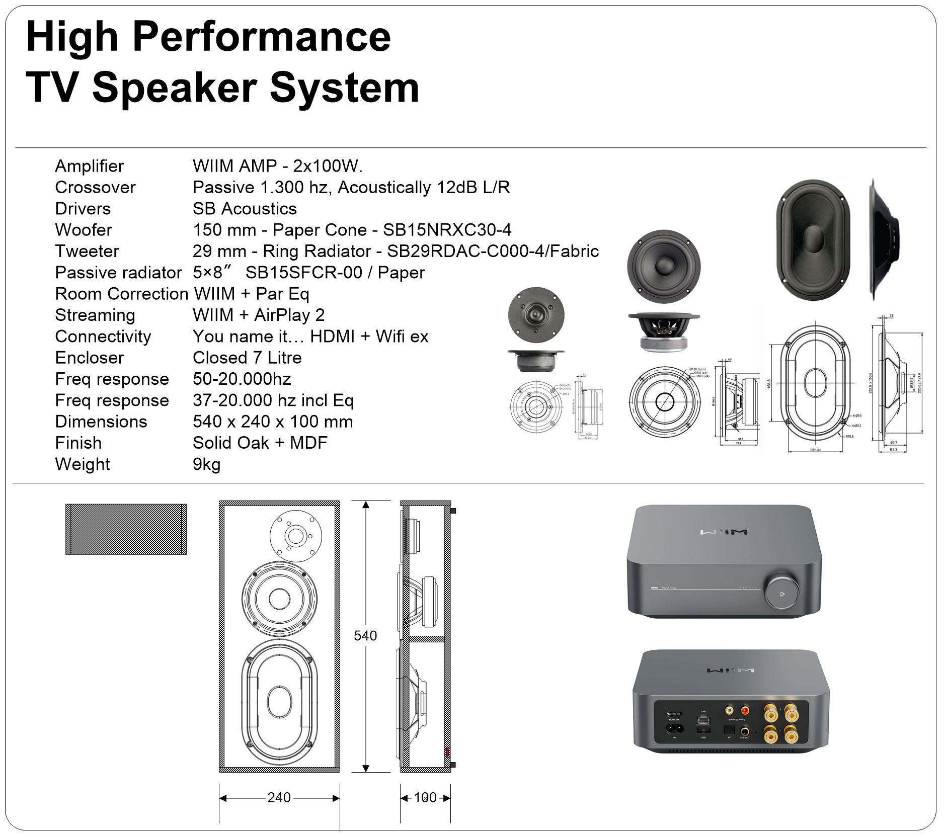

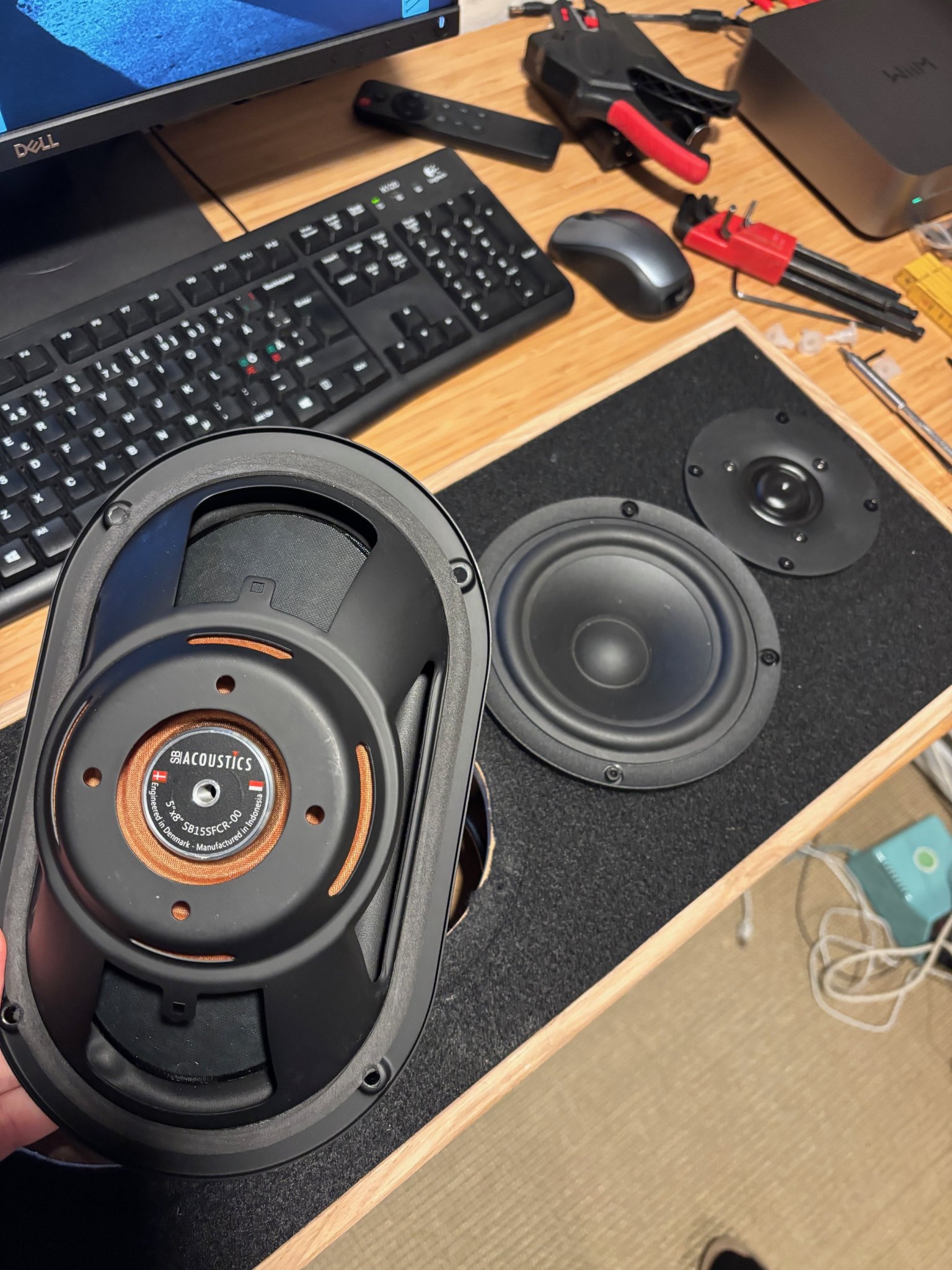

The driver selection:
Tweeter: SB29RDAC-C000-4/Fabric
Woofer: SB15NRXC30-4
Radiator: SB15SFCR-00 / Paper
SB Acoustics are very high level drivers!

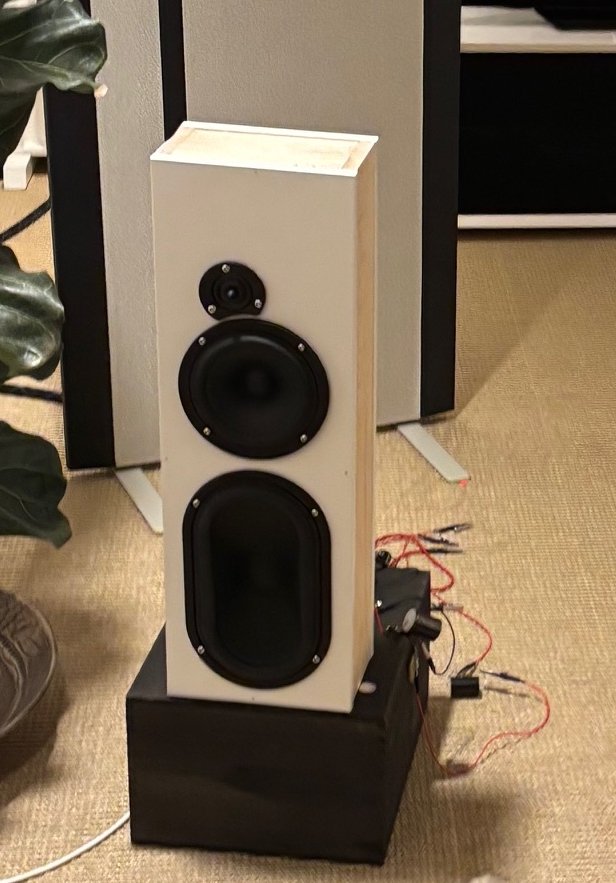

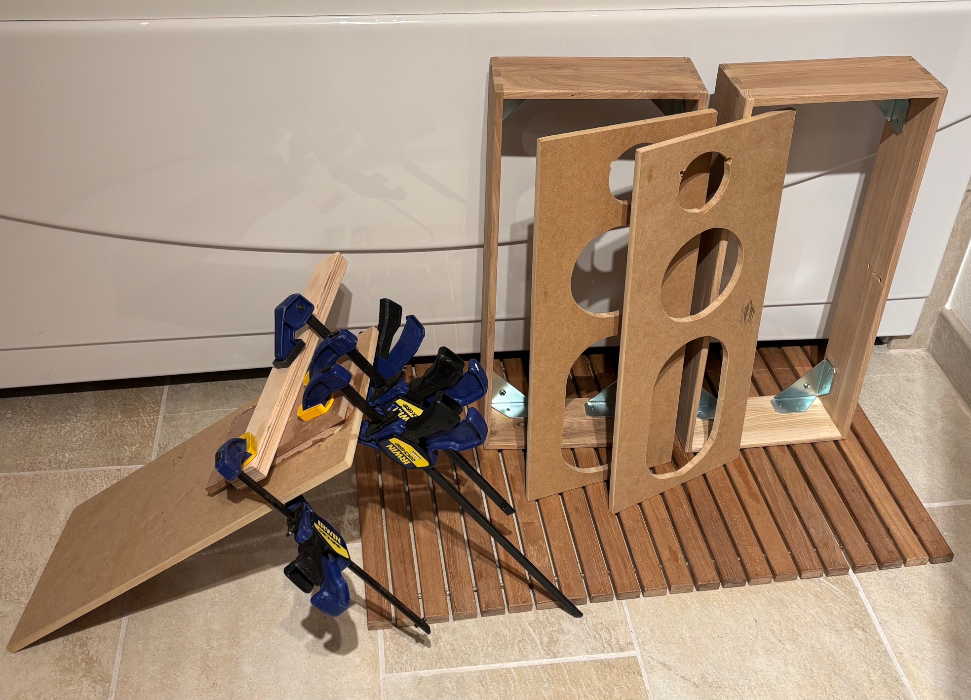

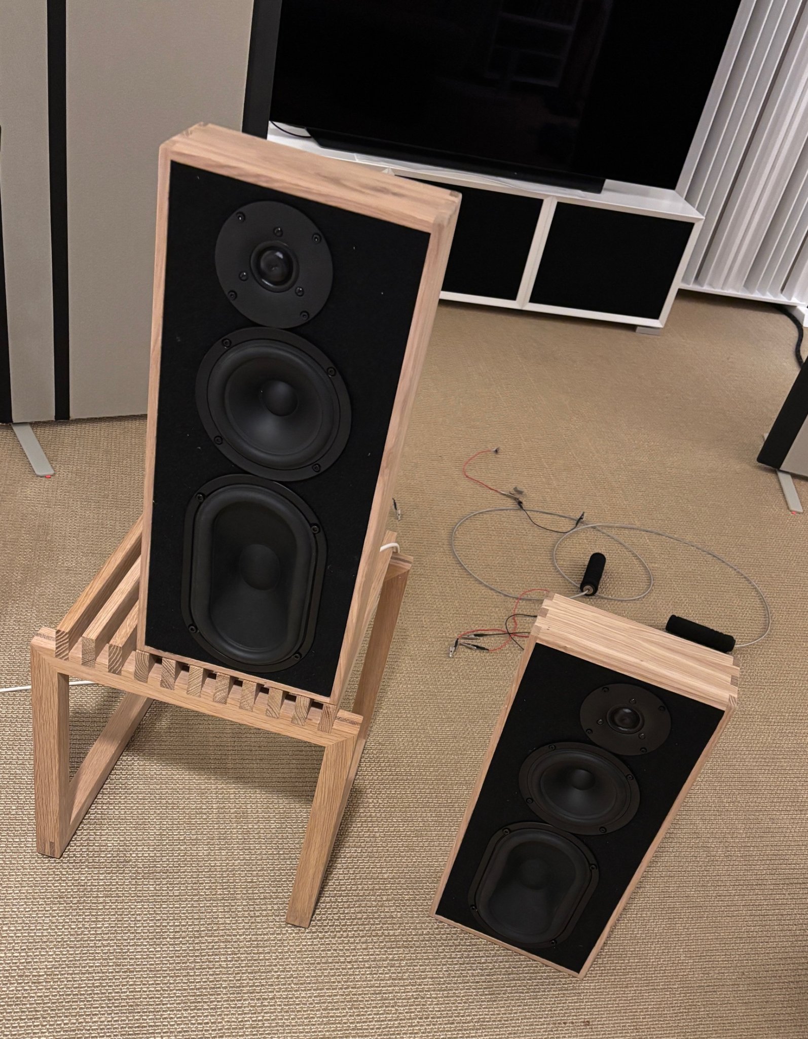

First prototype using another tweeter and a simple crossover – What a bass!
Didnt expected to be so well!

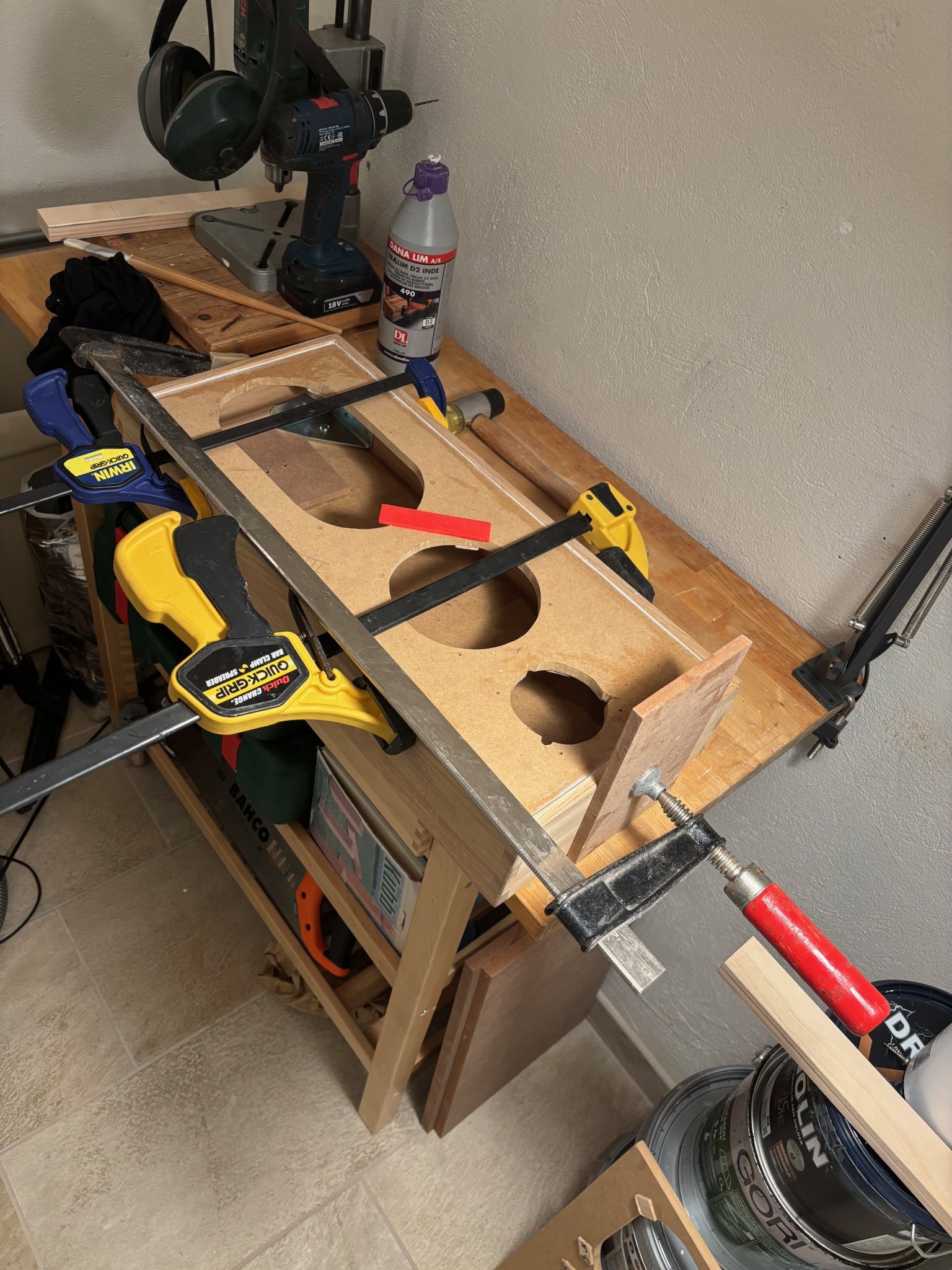

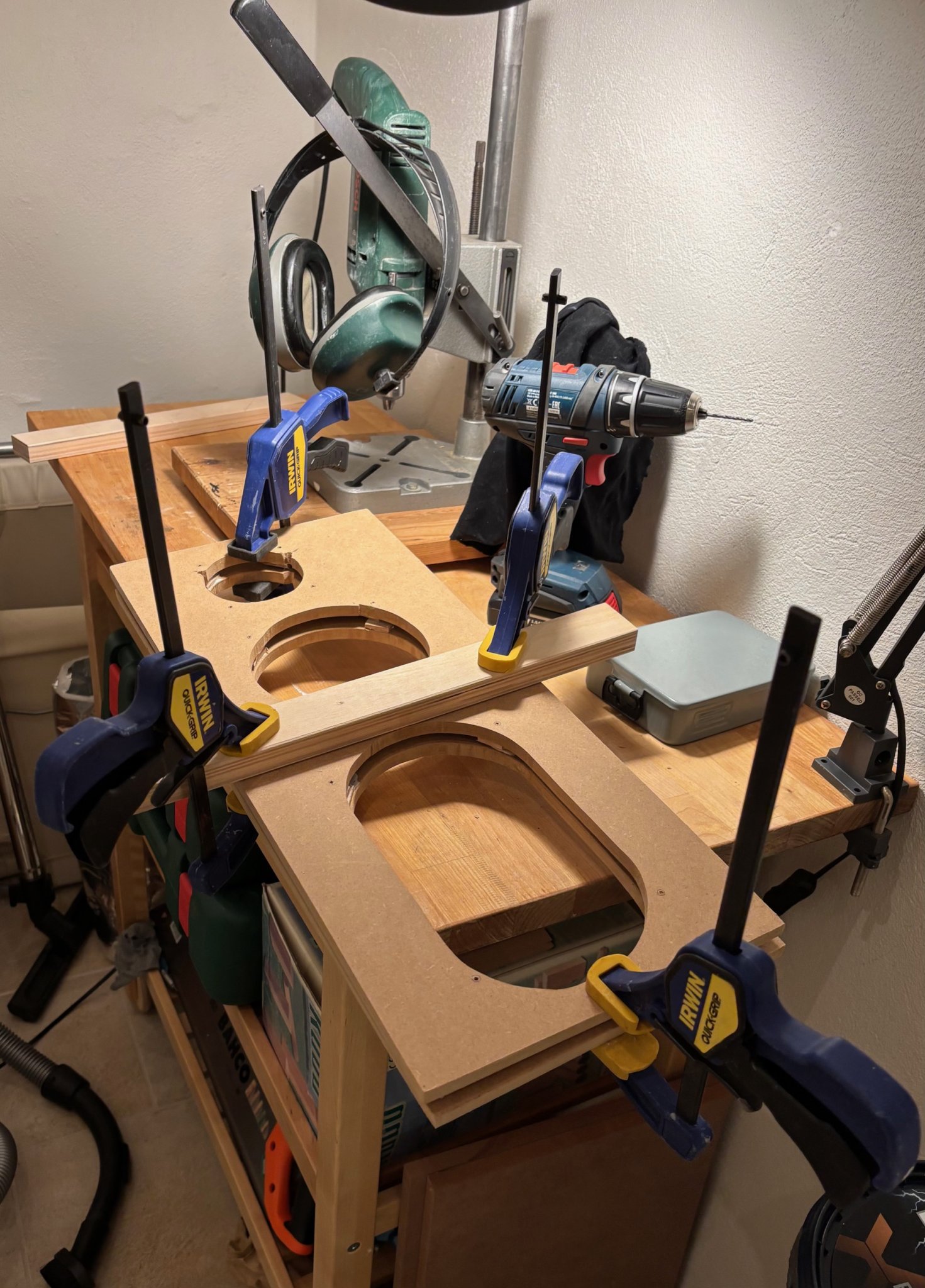

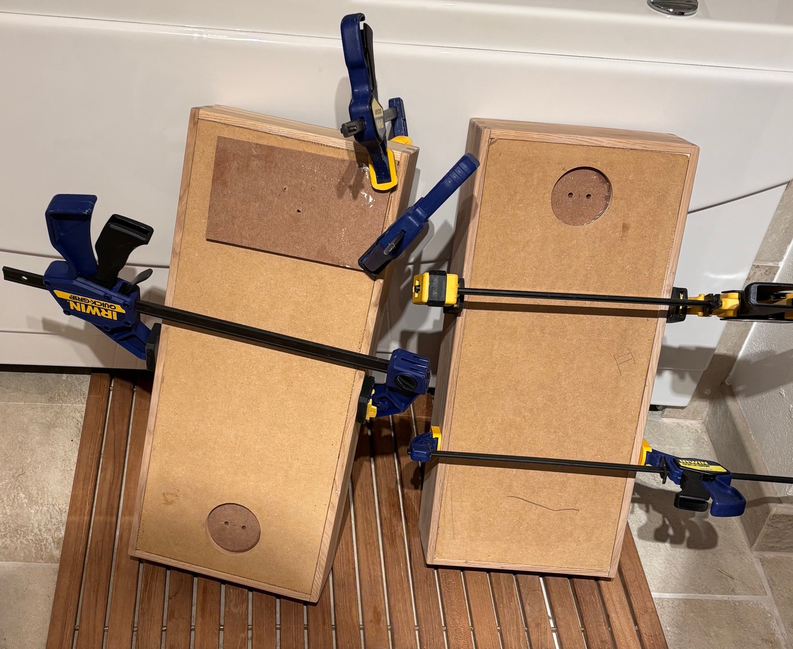

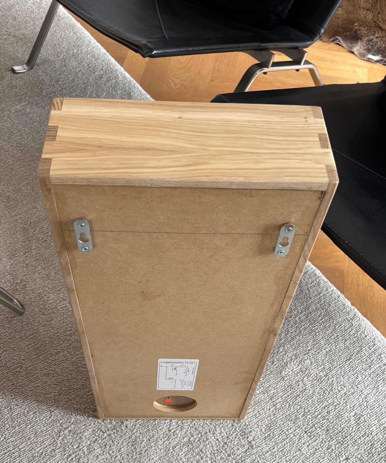

Design:
From the kitchen speaker system I copied the design, just with a slightly larger cabinet as the TV system had to go deeper into the bass range with a passive unit.
The furniture look was repeated with solid oak and finger tapped corners to match the style of the living room.
I was surprised by the use of a passive unit to support the bass unit.

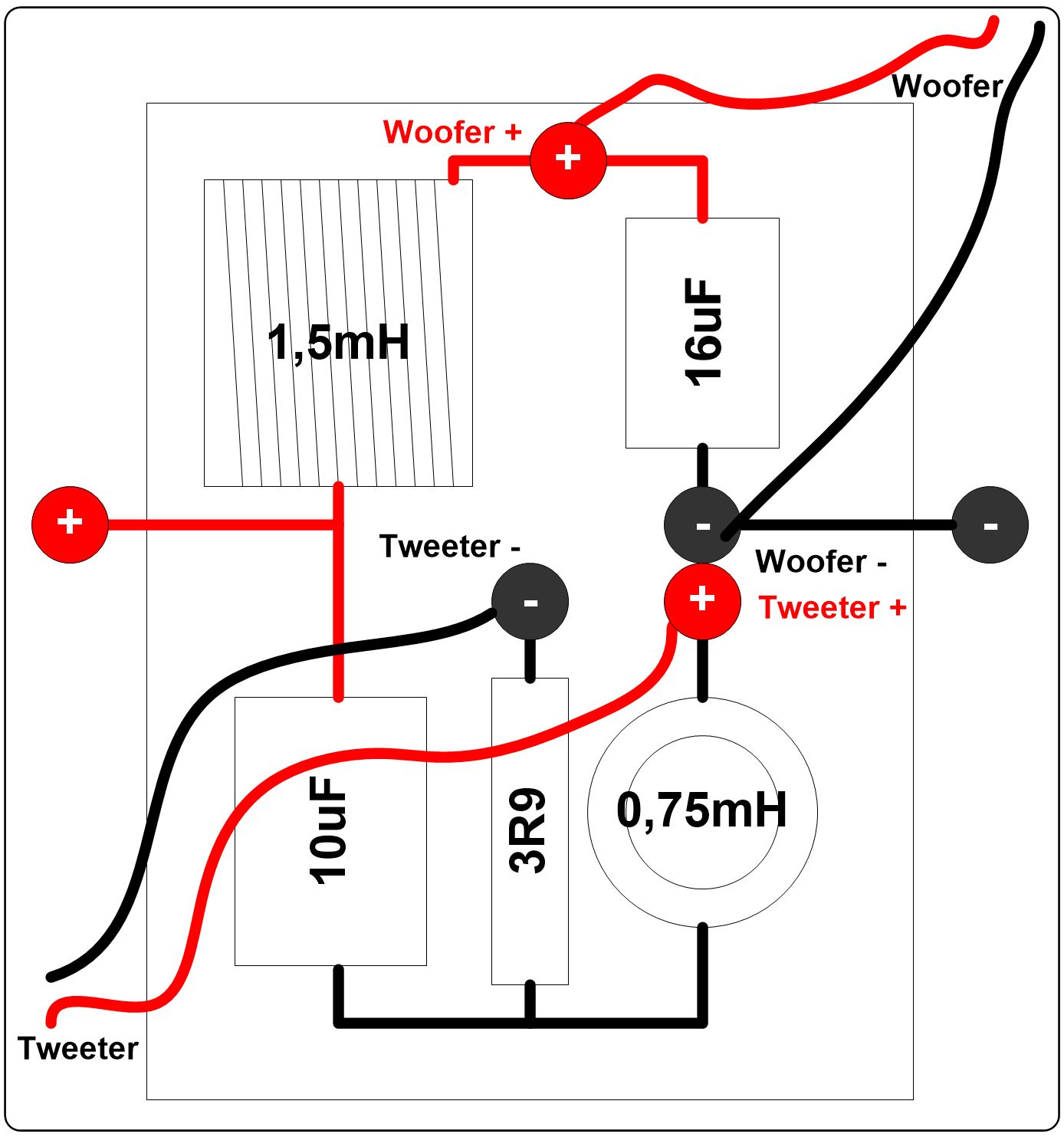

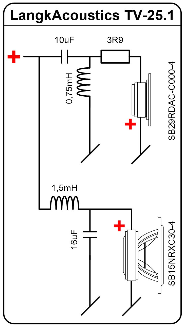

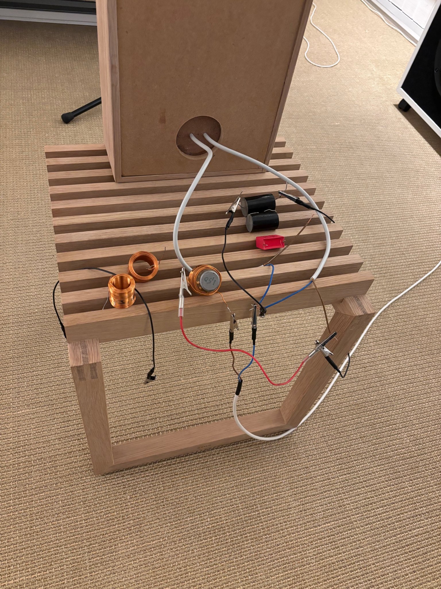

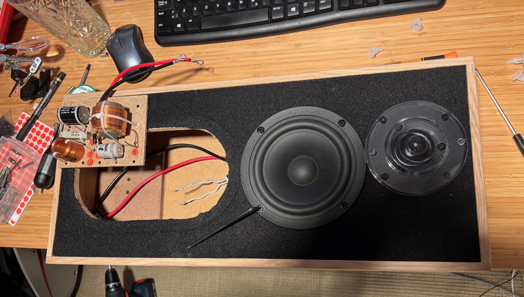

A passive crossover was made and no doubt that these units are easy to work with.

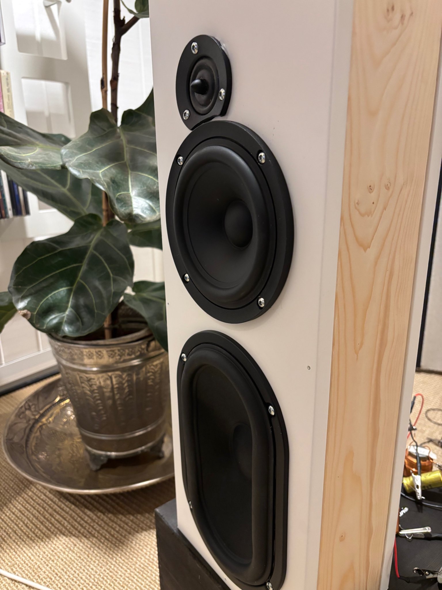

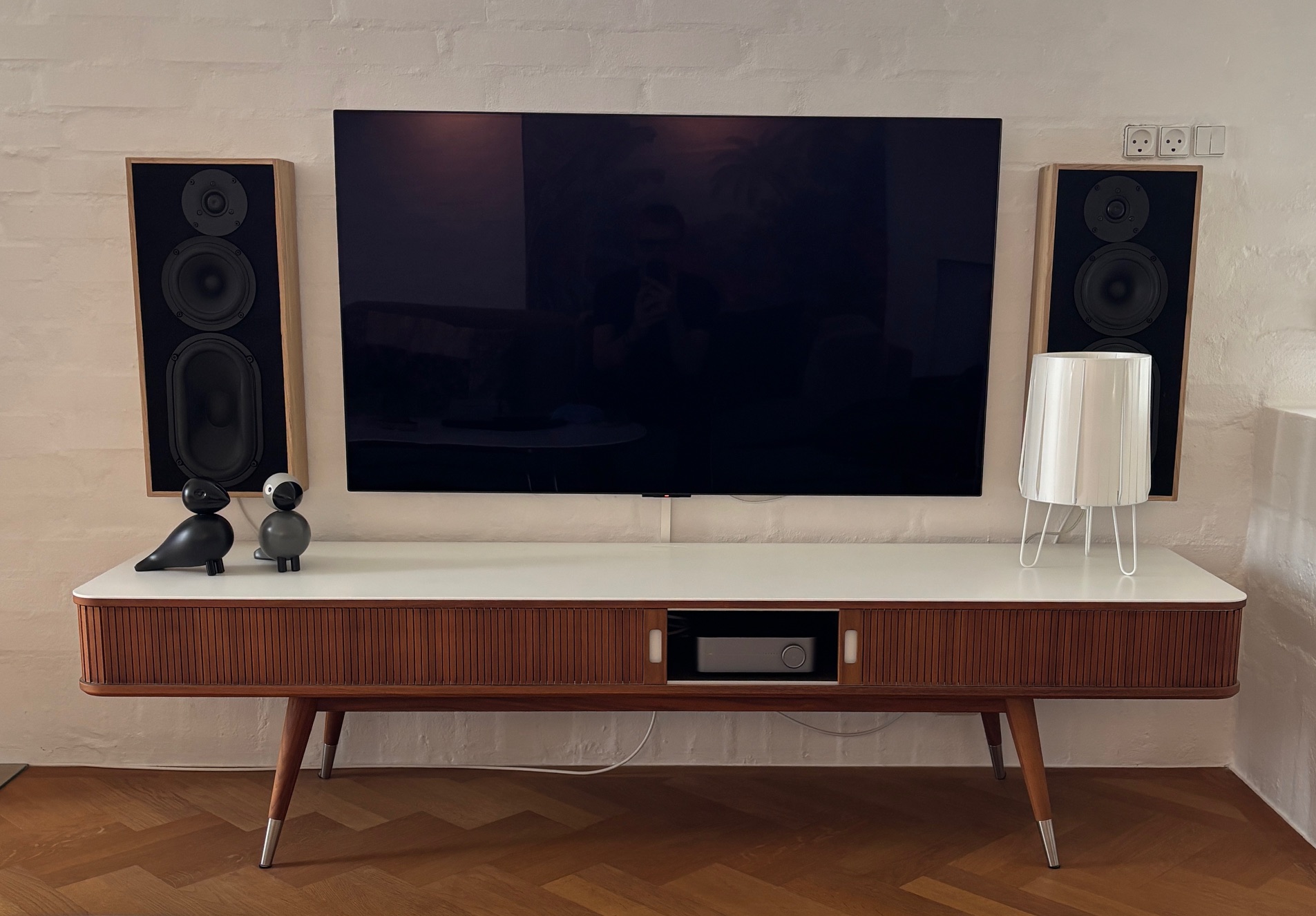

Pictures of the cabinet working and the final result:

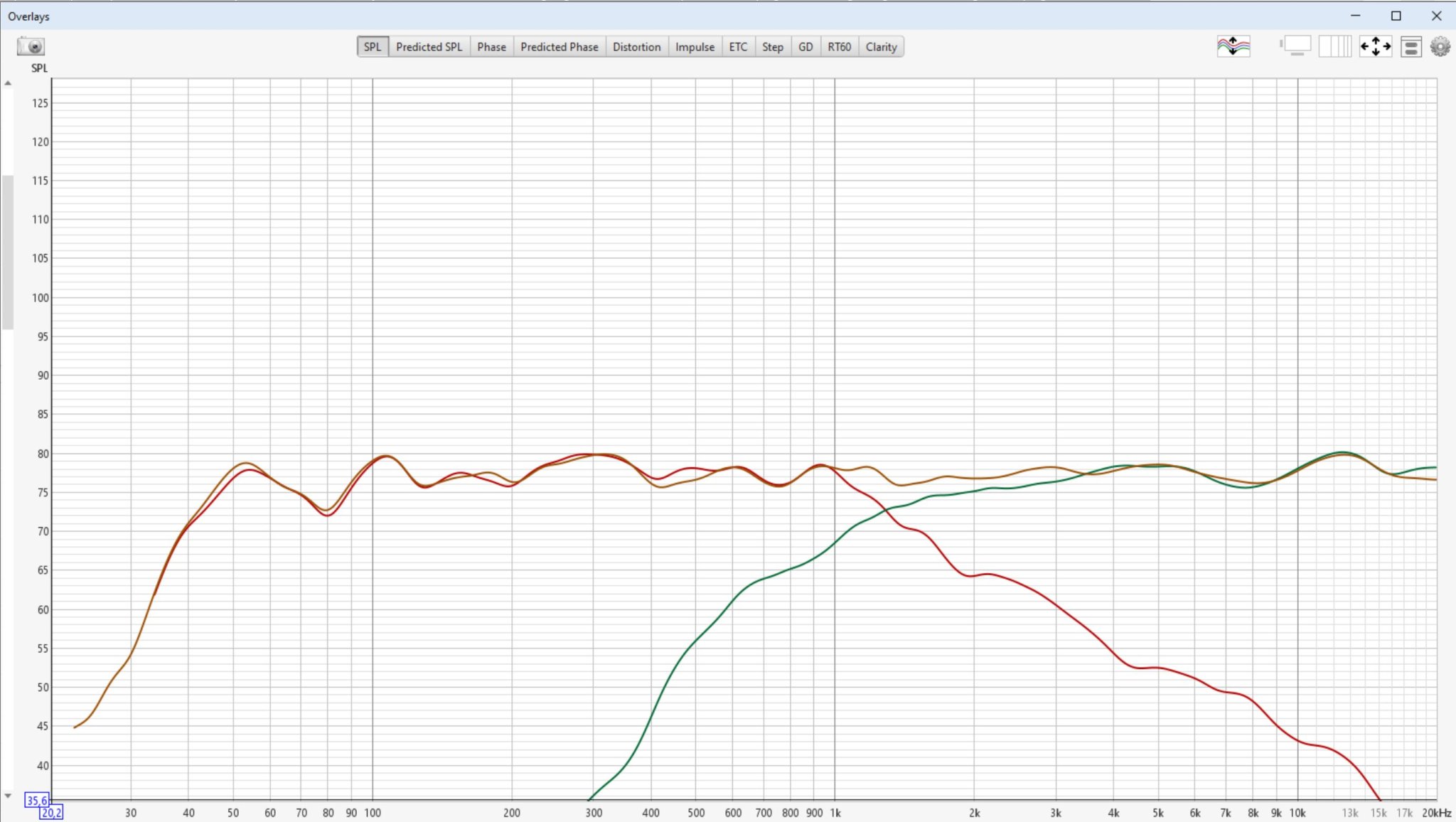

Frequence responce – free from the walls:
Pistures tell it all...
Sorry about The Lamp...

Congrats! Seems like a nice, straightforward solution. 👍😎 I might borrow your design for a friend or 2. 😉
Couple questions:
Does the wall add much?
Walls skinned with drywall can easily vibrate & cause problems. I've solved such problems in the past using soft rubber feet on back of speaker, and string to hang the speaker. The string doesn't tramit vibration well.
Also what of the natural bass boost for the close wall position? Do you compensate for that with EQ in the Wiim?
