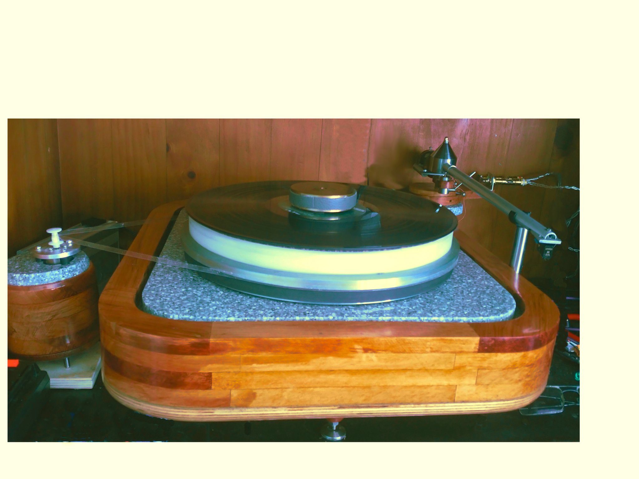

Hi I cam e up with this using a Lenco 78 platter & bearing (refurbished) & a 12'' tonearm lit. The used a separate motor pod & Mylar belt to drive the unit
Cost under $1000

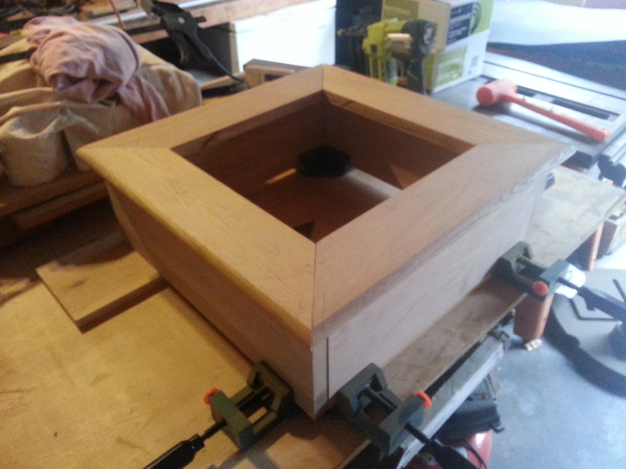

Broadcast TT are just for the ruggedness and the 24/7/365 X 15 years. They have huge aluminum non magnetic platters. They are 2-3 times the weight of either the 301 or 401 Garrard TT. Same rim drive idea. I have at least 30 Russcos I've done through the years that are still in service. I make the plinths out of 1" oak stair flats from Home Depot. 39.00 USD.

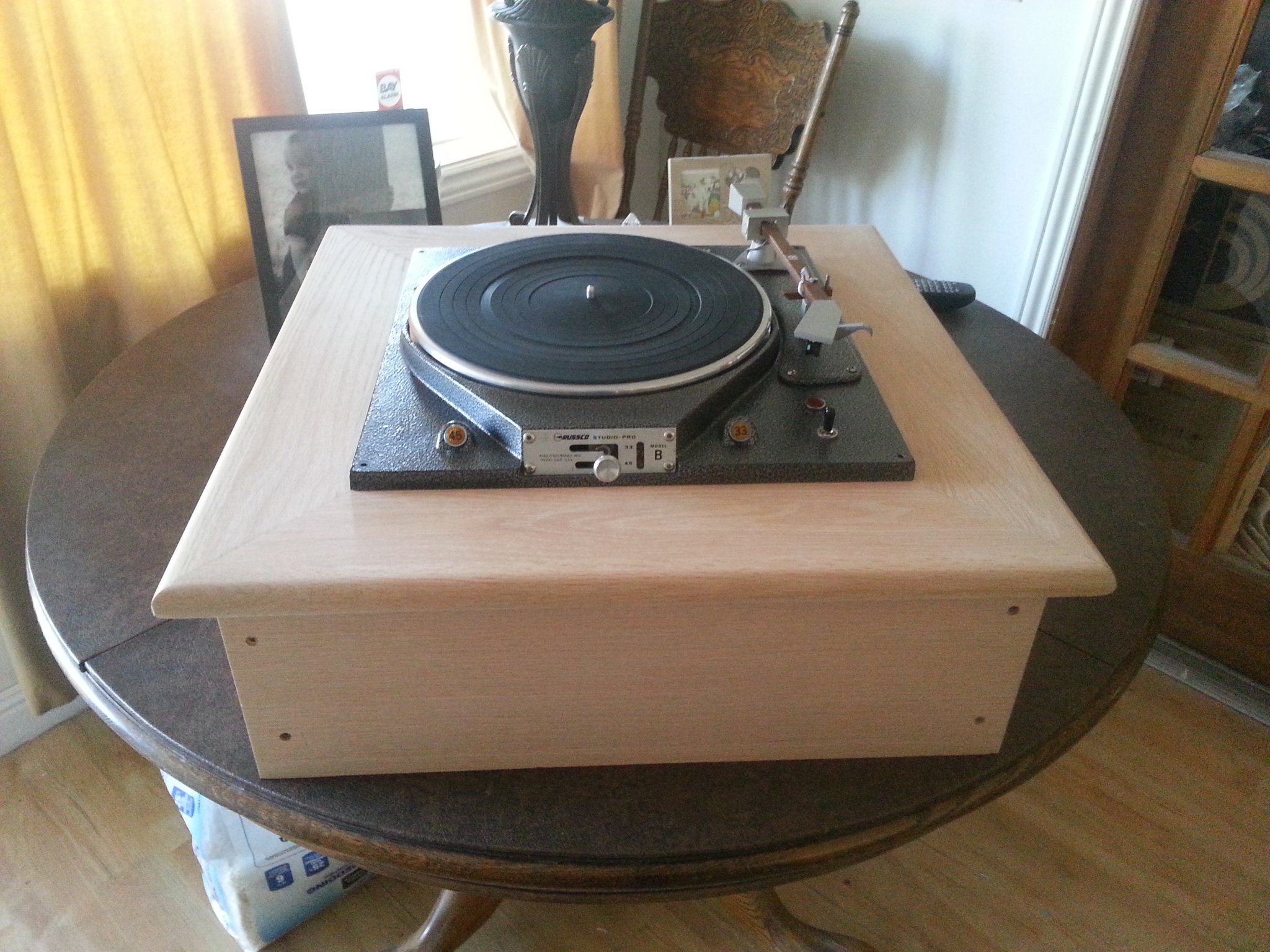

This one is in primer/sanding for a smooth high gloss finish. The top is no longer a slipper mat. That tonearm was made less than 50 miles from my home. "Woodies" In Elk Grove.

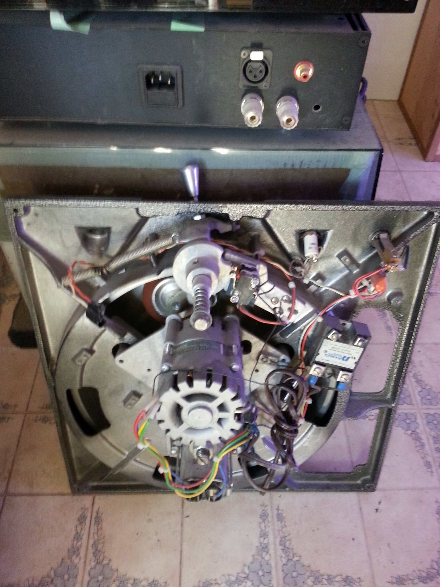

As you can see that is a washing machine motor. 🙂 That is the 39.00 stair flat I use. I've made 45 out of stair flats for Thoren, Russco, Garrard, Kenwood, ect. Work very well I add stubby Queen Ann legs to the corners on a few, quit a change.

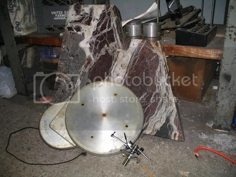

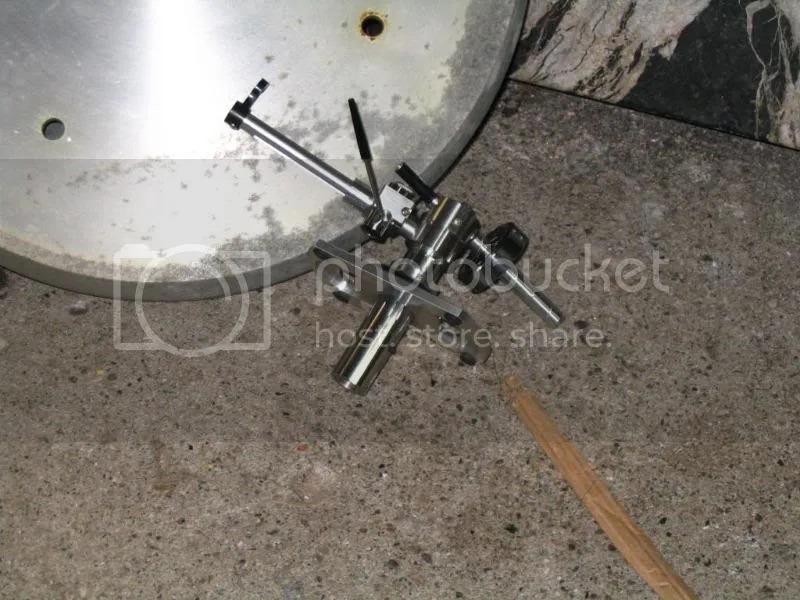

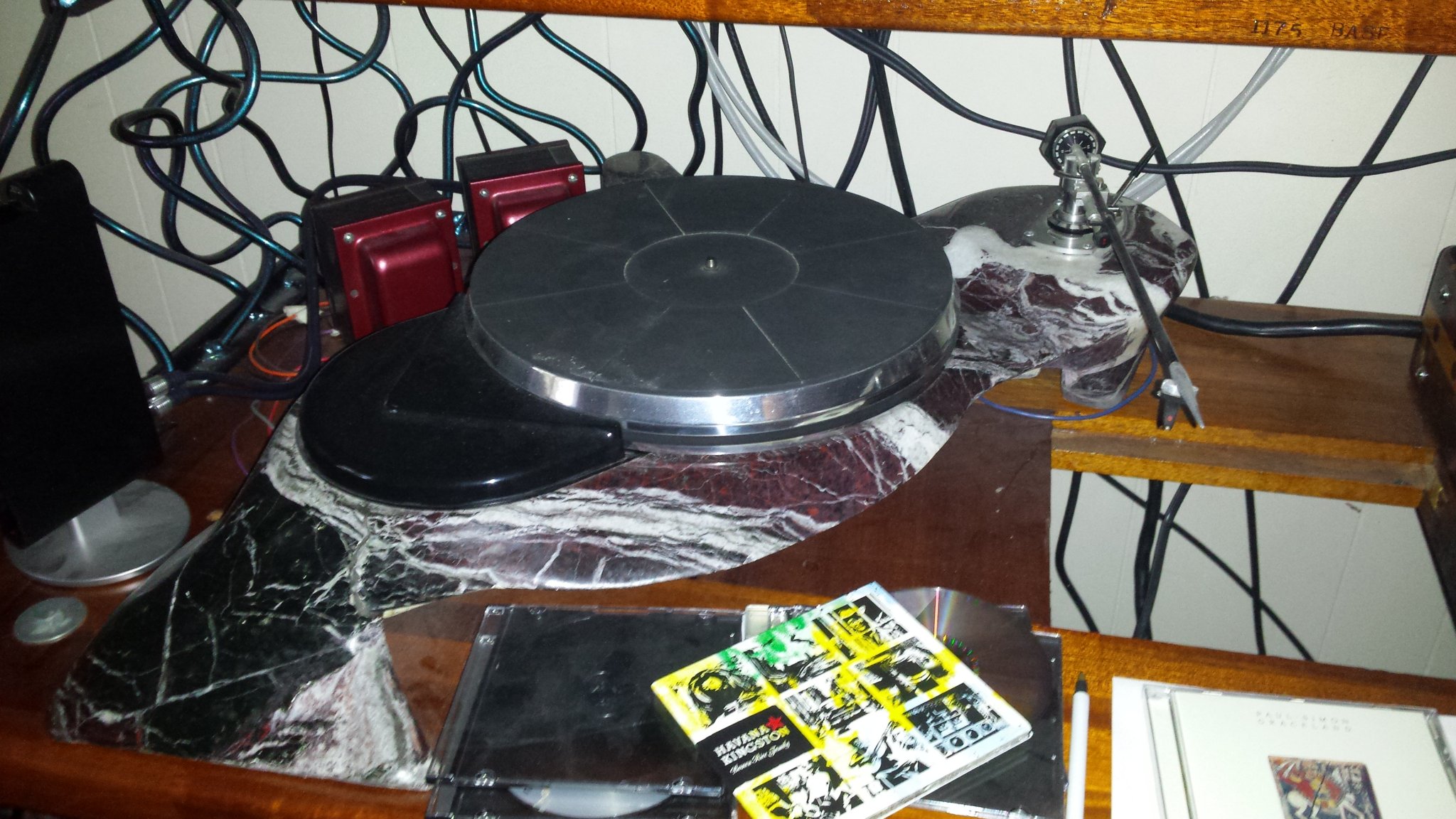

I bought an old Rek-O-Kut turn table for the platter main plate and motor them used an Infinity Black Widow tone arm that I lengthened to 12”. All this I put on a 120lb piece of carved marble.
Cost under $1000
good work - very nice.
For me an interesting question is - what is the correct value for the pretensioning force of belt (right contact pressure on motor pulley and platter)?
