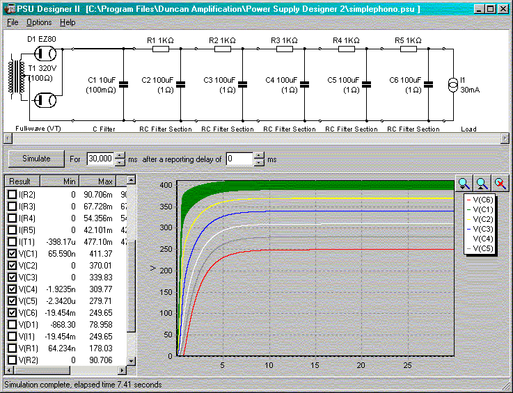

What does the data mean on your attatchment? it looks like something useful, and pretty **** cool

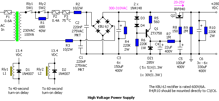

By the way Alex, not to confuse you but, I found the suggested rectifier, the 6X4 noisy on my 12B4 preamp. I replaced it with 5Y3 and it's silent. However, I don't like the huge voltage drop with the 5Y3.
Recently, I've had very good successes with solid state
(i know, i know) recitification on my preamps. They are silent, way cooler, smaller (i like nice, small chassis). I'm planning to use the attached schema which I pulled out from HeadWize. Just ignore the relay stuff...
EDIT: Sorry, haven't had morning coffee yet. The suggested rectifier is EZ80 and *not* 6X4 as I posted.
Hi Alex,
that's the simulation result from the PSU Designer II software, which most of use use to prototype power supplies.
It shows the voltages along each stage of the power supply. If you have the software, you can check the "ripple" (noise) by zooming in on one of the lines.
I have no inhabition toward using a SS recitfier, it just seems a little more practical. Is there any real advantage using a tube rectifier? other than the fact that alot of them look really cool?
Arnoldc, could you explain the data thats in the attatchment from the previous post? the graph, showing the suggested power supply, I am very close to understanding it, however I am not sure, please enlighten me

so the graph shows the voltage vs time graph of the various stages of the Power supply right? so depending on what capacitor you place your lead into B+ next to, you get a different voltage?
The numeric results on the left pane shows the simulated voltages at each stage - "Max" column.
I really like this software so much, and the simulated values are always close to the real world values. I use it in all my projects, whether SS or tube rectification. 😉

Changing the capacitance does not change the voltage but will have an effect on the ripple. If you want to play around with the resulting voltage, you can change the R.
Another EDIT:
The 10uF first capacitor is sized according to the maximum capacitance limit of the tube rectifier, the EZ80 in this case. Each tube rectifier will have a different capacitance limit for a cap-input supply, like this.
I ditched, the EZ80 and 10uF, replaced it with FR107 and power transformer is 280V I think, in one of my projects.
