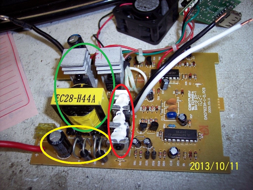

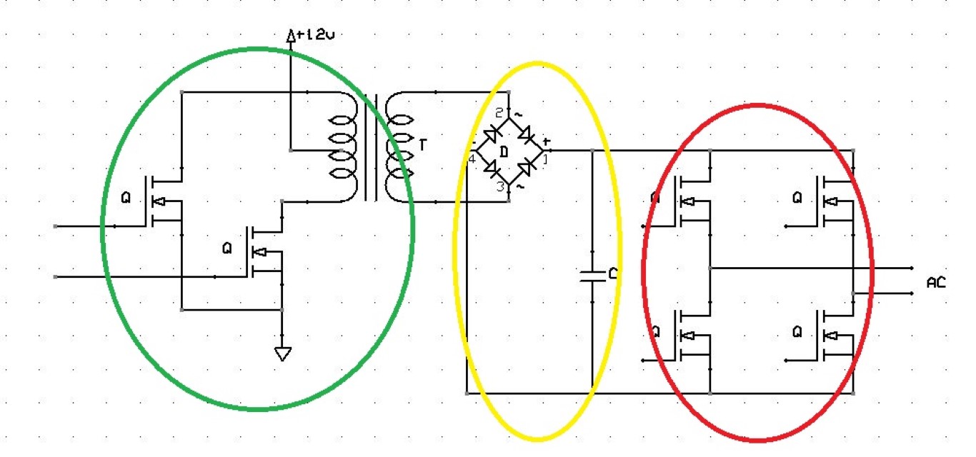

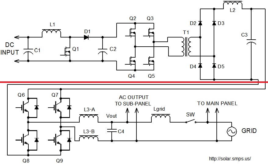

That is not accurate. Most inexpensive inverters are modified sine-wave and have 2 stages to create "ac". The first stage is a high frequency push-pull SMPS step-up convertor. The second stage is 4 (or more) MOSFETs that alternates the DC polarity (at 60hz) to the AC receptacle. That much I know.

Here's a schematic. The top half is the DC-DC step-up converter. There are various topologies. Most common is a push-pull which looks a lot like the output stage of a pp tube amp or the power supply of an automotive amplifier. There will be high voltage on C3. The bottom half is the the DC-AC converter. If you tap the power before the second stage you will have a nice DC supply.
This 120vac inverter was rated at 300w and has 147vdc coming from the DC-DC portion. Using that math, a 220v inverter might have about 270vdc. Rough schematic showing below of the main components.

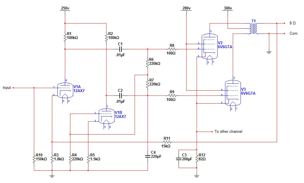

Here's a drawing of the Motorola schematic.
It looks like they placed a resistor divider across both phases outputs rather then use a resistor divider to ground. How well does that work? It seems to me that it may have a more symmetrical output then some other paraphrase PI circuits I've seen. Wouldn't an asymmetrical output change the gain of the second triode?
What is the purpose of C4?

For a single 12AX7 as a preamp, what has more gain? A paraphase (as shown in the schematic) or a cathodyne with 1/2 of the 12AX7 in front of it? I should have a 2-4v signal coming in.
