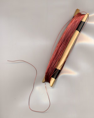

I use a shuttle to wind toroids -- it's a small piece of thin wood, notched at each end.
When I am checking out a transformer I use a signal generator to send a 5kHz signal in one end and measure the ratio of input/output.
I've wound quite a few SMPS transformers this way -- with mystery cores -- life is simpler if you purchase cores from Amidon because you don't have to cut and measure -- works right the first time from the equations given, and you know how much heat it will take.
