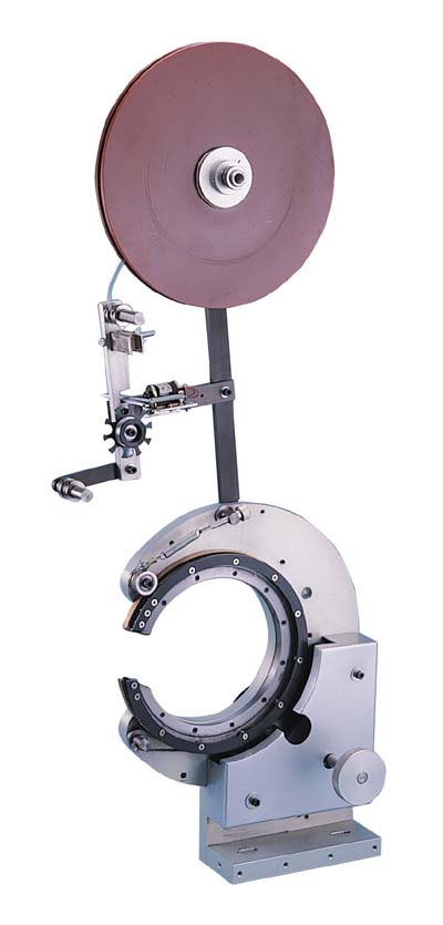

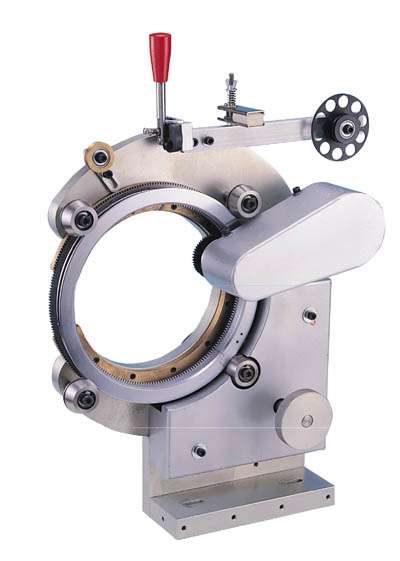

hi audioPT
Really cool winding machines have a shuttle (shaped like your bobbin) that goes through the toroid. They have an opening to insert the core. Then the opening is closed, the shuttle is loaded with the right length of wire. And then the toroid is wound by unloading the shuttle again.
At the lower end of the following page you will see such thingies:
http://www.weyhwang.com.tw/wh900.htm

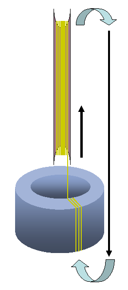

I guess id just make a bobbin and cut it in two halves. Put it around the core and tape the bobbin to one piece again. Load the bobbin with the required amount of wire....and there you go.

Make a bobbin, that looks like a bicycle rim without spokes.
Cut it in half. Install a hinge on one end, latch on the other.
Put it through the toroid. Close and latch the bobbin.
Now, load the bobbin with enough wire for your need.
Rotate the bobbin as you wind the toroid.
If you're really good, you can make the bobbin inside out, load the wire on the inside of the diameter.

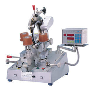

googel me this batman:
http://www.gormanmachine.com/900avid.html
http://www.toroid.com/standard_transformers/transformer_kits/transformer_kits.htm

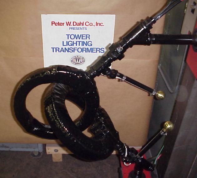

And once you think your good, realy good, why not try for more HV isolation with an Astin Ring Transformer:
(its how radio stations keep the tower lights from back feading 50KW AM onto the power grid. I think it must give a touch of lightning protection too.)
