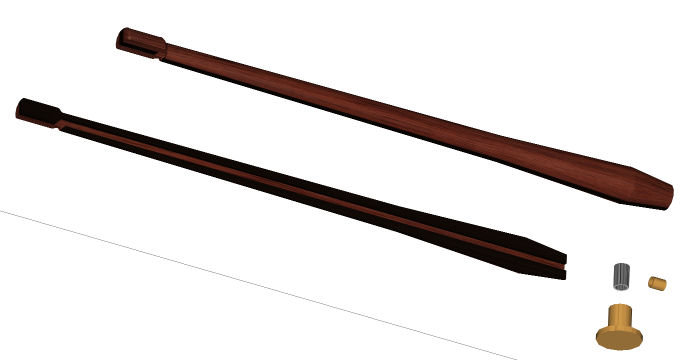

Is there any benefit to shielding the wires in the arm tube?
I will be a tube running down the centre of my dowel anyway, for ease of wiring/re-wiring and if shielding isn't an issue then it will be a thin plastic straw so I can bend it to shape. If shielding is an issue then what should it be made from?

Here's a little piccy of the arm tube and a cross section through. It will be Walnut on each side with a 4mm strip of Ebony down the middle with a slot in for the wires.

The signal leads don't need to be shielded - use twisted pairs. You could try splitting CAT5. I rebuilt an SME with an ultra-light Balsa arm which has seen about 25 years service, and embedded single thread twisted pair enamelled copper wires and it's fine. Arm mass is critical though, especially if you want to be able to track warped records.
