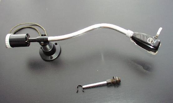

And most vinyl junkies in Europe and, especially, Japan will swear by the 12-inch Ortofon RF-297 or RMG-309
Indeed. I was amazed how much better my SPU G/T sounded in this horrible chunk of steel and lead which was easily heavier than a Rega platter. Way better than in a 3012.
Nice! If people want to know what vinyl can be they should listen to the Ortofon combo on a Garrard 301 or Thorens TD-124. I actually settled for an EMT 929 for my Garrard 301. I had an SME laying around that I originally intended to use. It's now sold.
