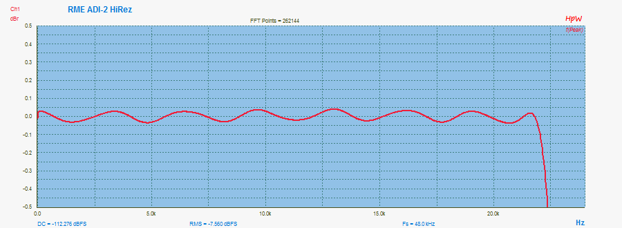

Here my mentioned not so flat freq. response at 48kHz on the AKM ADC... just for the given AKM spec's validation 😀
Keep in mind that the upper roll off freq. is adjusted/altered by the ADI-2 Pro DSP .. 🙂
