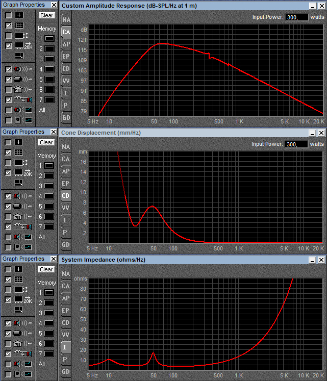

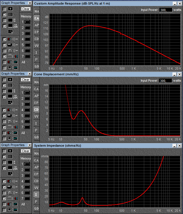

There is a possibility that I will be asked to construct a subwoofer for a room that will be used quite heavily for parties. This means that in this case quantity is somewhat prioritized over quality. This also means that it will be playing a lot of base heavy music.
The budget is rather slim but I've made two suggestions using a Dayton DCS385-4 15" driver and a Monacor SAM-300D 300W amp. As for the box I was thinking a ported rather then sealed for increased volume. The placement won't be ideal either since it will have to stand behind a corner sofa, i.e it will have to be a three sided box. The port will be firing underneath the sofa.
I did some calculations in BB Pro 6 and got two inital alternatives I would like to get some feedback on:
F3 @ 30Hz:
F3 @ 35Hz:

Sounds like you're on the right track. I would advise against firing a port into a sofa, as it will absorb your bass. You want the sound going into the corner, then up and out over the sofa if at all possible.
Thanks. Would you advice to put both the cone and port above the sofa?
If possible, yes. But would not face them upwards, where people could spill on them.

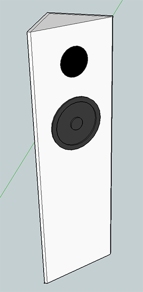

A quick sketch with dimensions of what you have to work with would be very helpful here.
How large is the space, and what are the main speakers you have to keep up with?
Made a quick 3d sketchup:
The amp would be placed at the bottom of the baffle. The box is now 79" high which would place the port above head level (don't want anyone to get that thing blowing in their neck). Would this be a better placement? Or should I keep the port high and place the cone low with the amp in the middle?

Bass is omnidirictional and should pass right through a sofa. I would mount it low so the center of balance is lower. A cube will be easier to fabricate.
......should pass right through a sofa.
Disagree. A sofa will absorb a significant amount of sound, which is particularly important for a sub with limited output.

I would build it right up to the ceiling and get both the driver and port as close to the ceiling as is practical, for good corner loading. Use a large area port with a 90 degree bend, slot/triangle port if needed, or put the woofer and port on the top face about 2-3" from the ceiling.

Too much volume will lead to a lower extension than is desired and lower sensitivity. You should be aiming for maximum output around 30-80 hz, so your initial tunings are about right. Getting it corner loaded is important though for output, so it may make sense to build it up on a riser of unused space if you were to corner load to a ceiling.

And if you can build all the way up to the ceiling, try to use that volume! 2 drivers-the same one you modeled if budget allows, or maybe 2 of something less expensive. More area = same SPL with less cone motion. How wide is the face of this thing?
By the way, I'd be really concerned about fitting big-enough-area ports without the inside end being too near a wall. Be sure to run some air velocity simulations, or someone here can help if you can't.

Thanks guys for your help and input. Unfortunately, behind the corner sofa is the only place where a sub can be placed so no chance of having two subs. I'll be in the room tomorrow so I'll take some more accurate measurements and get back to you then.
If anyone wants to do their own calculations to see what you come up with I would really appreciate it. 🙂 My newest calculations got a Vb of 157.8L, F3 at 30Hz, Fb at 22.24Hz and QL at 6.076 with little damping. With 300W power it would give me a peak of a little over 117dB between 50-80Hz (not including room response).

Haven't got the exact measurements yet but I played around a bit more in Bassbox and when I went from "Vented box" to "Vented box with active HP filter" it went crazy! I filled in 20Hz and put Qx to 2 (would this be a good Qx value?). Now the driver exceeds Xmax as soon as 47Hz! Vent air velocity skyrocketed from 18.7m/s to 37.8m/s @20Hz.
No matter how I dimension the box I can't get the cone displacement to go down to reasonable numbers. 🙁 What am I doing wrong?
