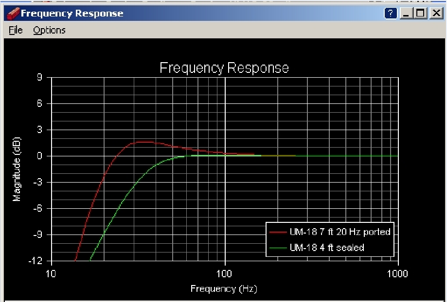

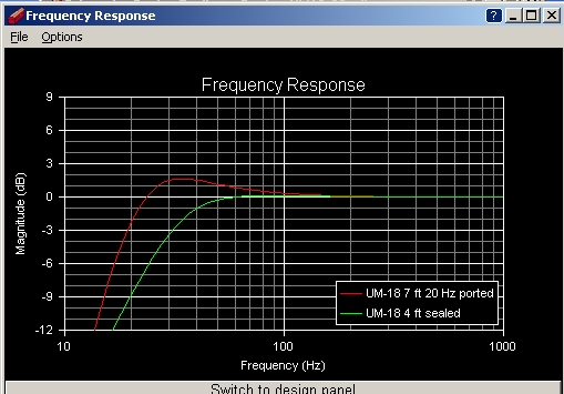

Ultimax-18 Driver puts out but will MDF box survive?
This is the response of the UM-18 (using the present T/S specs on PE's site).
I also included a ported 7 ft^3 box tuned to 20 Hz just for kicks.
The kit uses a 4 ft^3 knockdown MDF box.
P/N 300-7099 $355.00
It is currently out of stock.
Dayton Audio 18" Ultimax Subwoofer and Cabinet Package
It does look like, with some EQ you could get some respectable 30 Hz response.
- 3 dB at around 30 Hz and -10 dB below 20 Hz with no EQ.

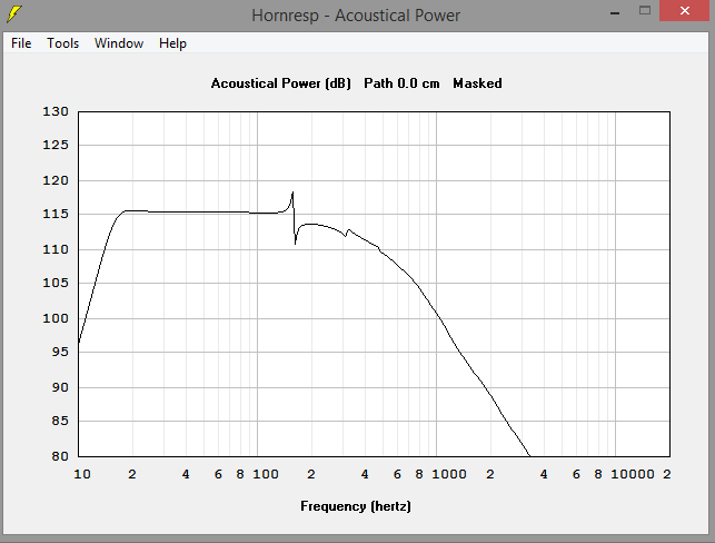

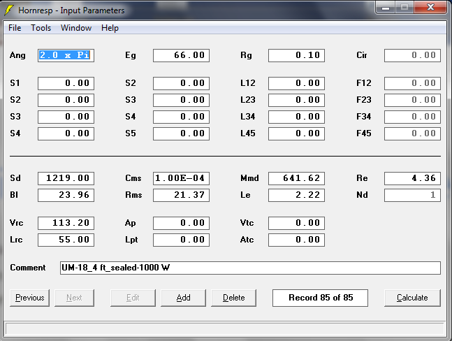

Hornresponse gives similar results for a sealed alignment, even at 66 V drive levels (1,000 W).
Hrsp. shows - 3 dB at ~ 30 Hz and -10 dB at 19.5 Hz With no EQ required.
At this drive point in the small 4 ft. box no HP filter is even required.
18.5 mm excursion @ 20.5 Hz (Xmax = 22 mm)

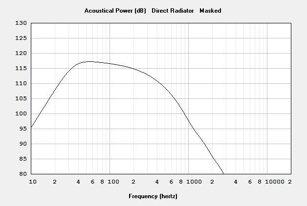

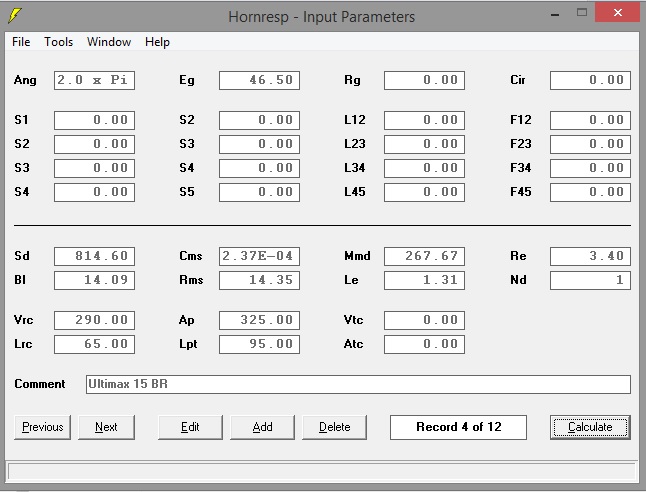

Here's what I did for the Ultimax 15, pretty sure they're the first generation. I've got two of these doing LFE duty (just effects)...still not sure I'm going to keep them in these enclosures, but..fwiw...
Edit: Yes, I know, not a knockdown cab...but sometimes ya gotta do what ya gotta do!
