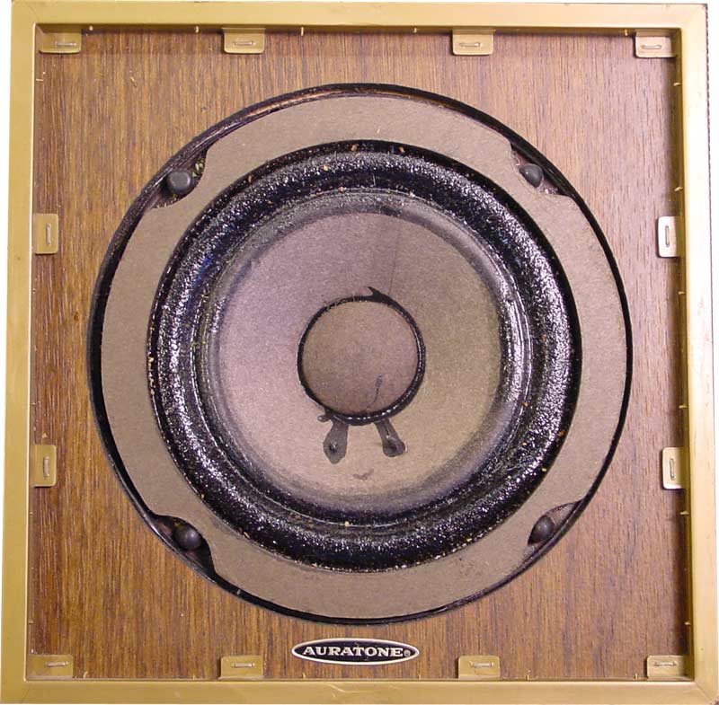

The reason so many studio's have NS-10's is because it is a standard. Boomboxes come in all sorts of types and versions, whereas there is only one NS-10. The only thing that can change the sound of NS-10's somewhat, is the amp that drives them. The same goes for Auratones - a small, one driver, "widerange" system. Narrow- or midrange would be more accurate, because they too sound like crap. But, as with the NS-10, if a mix sounds good on those, you can bet anything that it will sound good anywhere.
As for acoustics: controlrooms in studio's are acoustically treated to have as little problems with reflections and diffractions as possible. They are by no means comparable to a listening room or living room in your average home. Orcourse, studio's sounds different, but all (well designed studio's) have only a fraction of the acoustic problems a normal home has.
