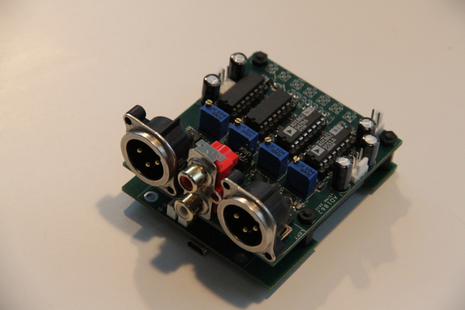

Here is a somewhat out of the ordinary DAC I made for testing multichannel PCM.
It is a quad AD1862 NOS DAC sandwiched on top of the USB-I2S board. With 4 PCM data streams the DAC chips can be configured as 2 channels, parallel 2 channels, differential 2 channels or 4 channels. All this without any glue logic.
If 2-channel NOS sounds great think about how much better 4-channel NOS sounds 🙂
