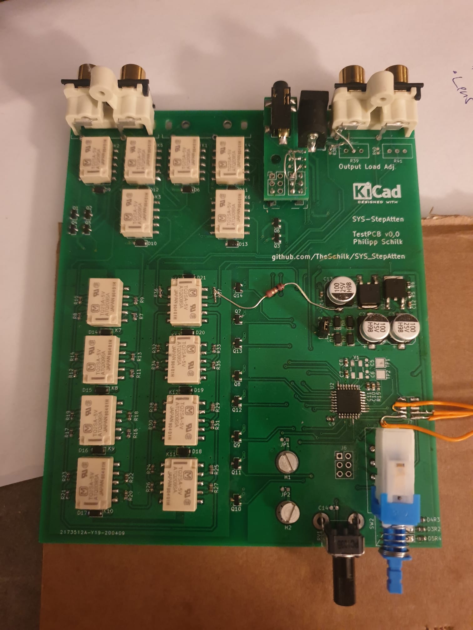

My phone (floating ofc) going into the step attenuator powered from the 9vAC adapter, going into my Dad's Violectric HPA V100 ( * grin * )
I am getting a faint but definetly hum through my headphones. That hum goes away completely if I ground my control circuit (for example by plugging in the programmer for the microcontroller, which is grounded through my PC) or by connecting the digital ground to analog ground (which is grounded through the headphone amp)

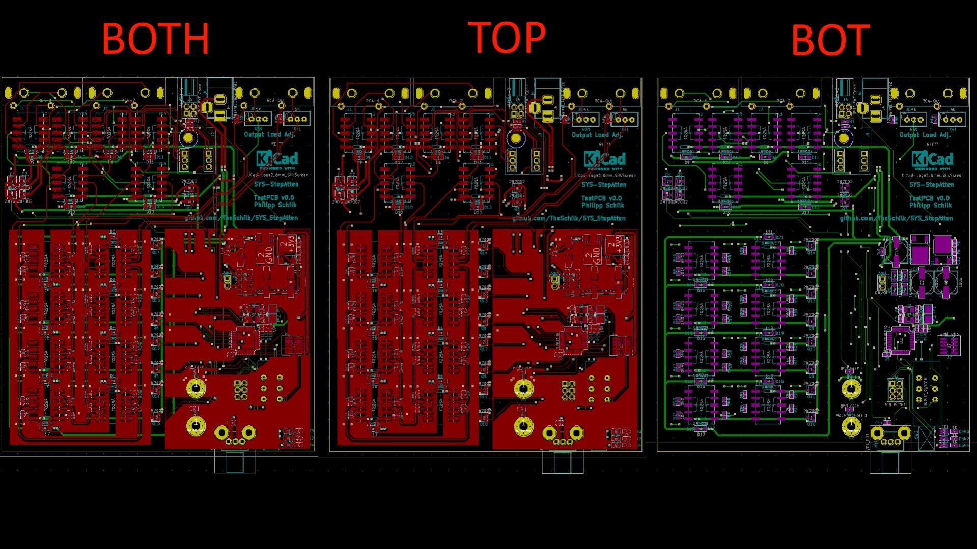

Can you post your layout? This appears to be the problem, and can perhaps be fixed with some rerouting. It should be like a board with the power line going to transformer, you want as much distance as possible between the relay circuitry and the switch/signal circuitry, so that the closest they get are at the connections to the relay itself. You could run a ground trace between them (on both sides of the board) as a shield. This still may not eliminate the capacitive coupling between the relay coils and the switches, but should help.

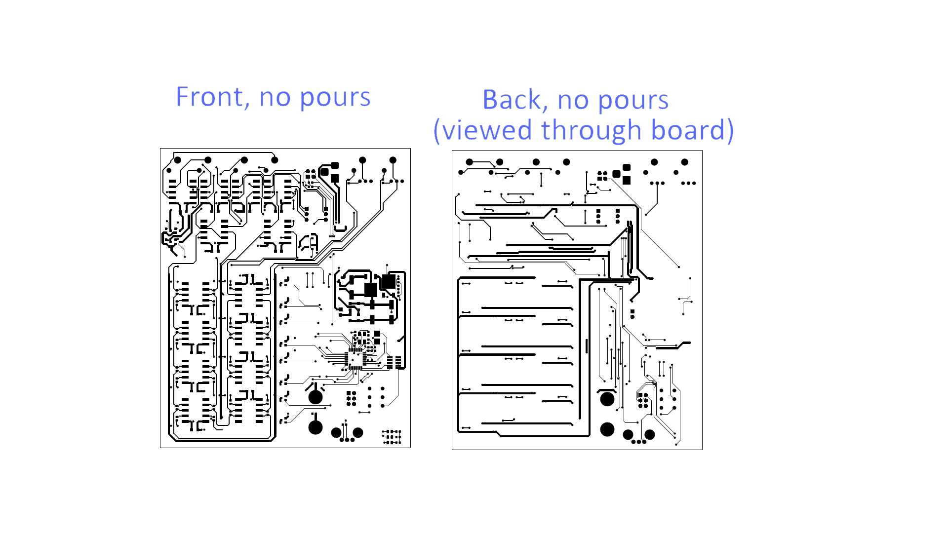

I have attached the PCB layout below, (Images of the front and back layers, plus the whole KiCad Project if that is easier? Not sure what the best format is, let me know if you would prefer something else)

1) This is definitely not my finest work. It was a test PCB I threw together fairly quickly just to make sure everything worked and I could get the firmware written. The attenuator is OK, but all switching and routing on the top is a mess. I had another order to make and wanted to squeeze it in to save shipping….
2) The two 3.5mm Jacks are mounted on small riser PCBs that sit above the 2x2 pinheader for the external pot. This somewhat weird arrangement is my solution to fitting the 2 3.5mm Jacks, External Poti connection, and Barrel Jack power input in the space between the SYS's RCA jacks.
I wanted all connections on the back, as to not modify the case anywhere else.
3) The formfactor is also the reason for the choice of an external AC adapter. That would make my unit fit with the Magni and Modi I own.
4) This means I am also somewhat stuck with having the Barrel jack power input Right in the middle of my audio IO. The lines will have to cross somewhere. What is the best way to handle this in the final design?
Because I have quite a few parts to fit into not that big of a PCB (with the Switch and Potentiometer placed in such a way as to maximise routing and placement annoyance) I will move to a 4 layer PCB.
I am honestly not sure what the best layout strategy is.
How do I cross the Power line and Signal Lines? at 90 degrees?
How do I handle ground pours if I have 3 different grounds on the same PCB?
My idea at first was to create have a ground pour of the signal ground following both lines around the PCB, as I teste in the attenuator section of the test PCB, mimicking that on the inner layers.
There are a few things I already ran into/realised and will fix in the next revision, just to save you the trouble:
1) The 5V regulator (d-pak) is undersized. I will move to a TH TO-252 with heatsink, maybe even split up the relays on 2 regulators. I could switch to a switch mode, but because I am not really optimizing for cost here I would rather not include such a noise supplying such a small formfactor.
2) Adding pull-downs on the transistor line. While the processor is in start-up/reset, the relays are switching uncontrollably.
3) Polyfuse on the power input, ESD protection on the external potentiometer input. (Would allow me to hook up something like a level pilot to have a nice big control knob on my desk, controlling the internal step attenuator)
4) Screwed up the pinout on the output RCA, fixing that...

I have attached a shot of the first proto PCB, excuse the messy jumpers fixing my connection mistakes, and the messy programmer connection. I am stuck without my tools at my parent’s place 😊
