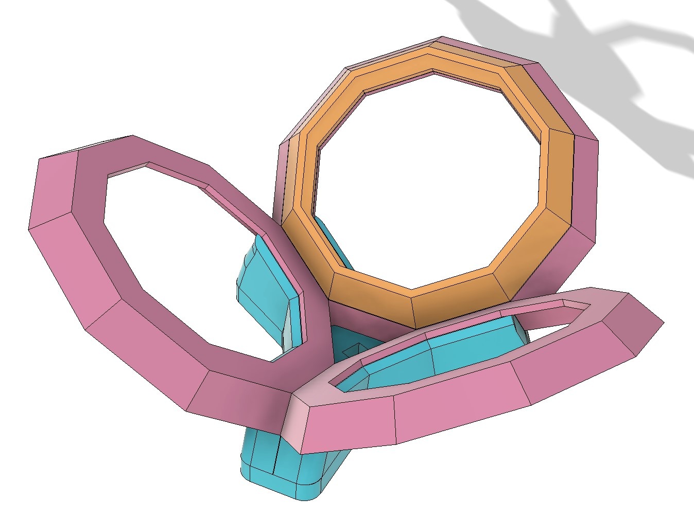

Today I redesigned and printed the gluing jig for the smaller test build before I commit to the full size speaker build, and welded one hemisphere together. I used ethyl acetate (sold as MEK substitute) to solvent weld the 3D printed PETG parts together. As I was gluing it occurred to me that the jig may not be necessary- strategically placed binder clips might do the job just fine. It takes just a tiny drop of the solvent and the joint is secure in a less than a minute.
When I set the glued up assembly down on a flat table all the surfaces on the bottom of the assembly touch the table so I think the printer is producing the prints with accurate angles. The surfaces that are welded looked like they were parallel to each other. I will print the other 6 individual stator pieces and glue them together and see how the two assemblies line up. Then it will be on to more of the design work for the actual drivers.
Note- the print quality is less than ideal- I have a 1mm nozzle on the machine so retraction doesn't work worth a damn resulting in blobby defects. I'll probably switch to a smaller nozzle where I can use retraction effectively for the final prints.

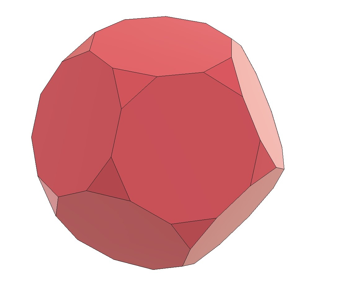

This is a truncated dodecahedron:
Three of the outer stators pieces (red) in the gluing jig (blue). The orange piece is one of the inner stator pieces:

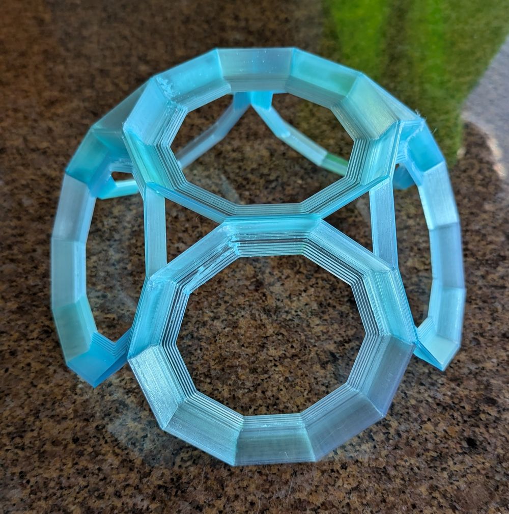

Here is a hemisphere made from the small, test-sized outer stator pieces:
It will be interesting to see if the diaphragm tension causes the stator pieces to flex out of shape. I'll probably add some supports for the wire screen to the inner and outer stator pieces, as well as some means to add dust covers to each driver using the same 6um film as the diaphragms. I still have to work out details of the electrical connections.

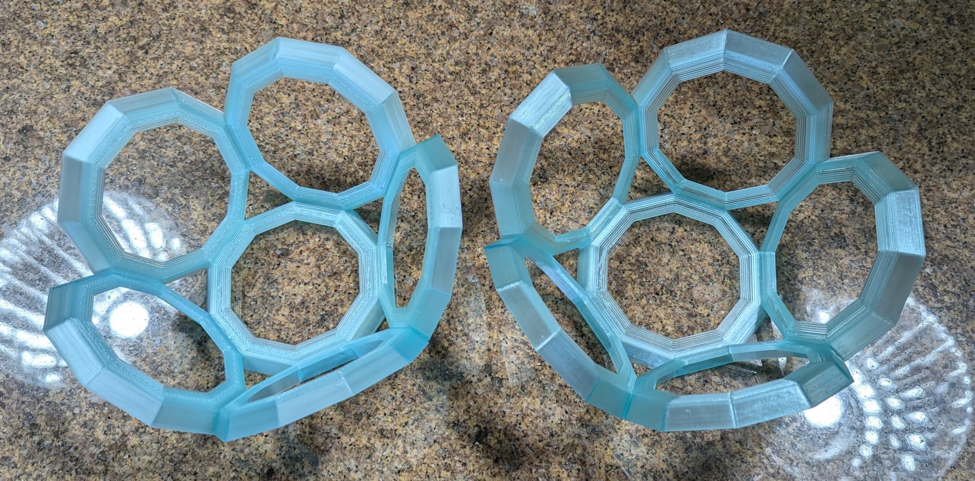

Printed and welded the other hemisphere:

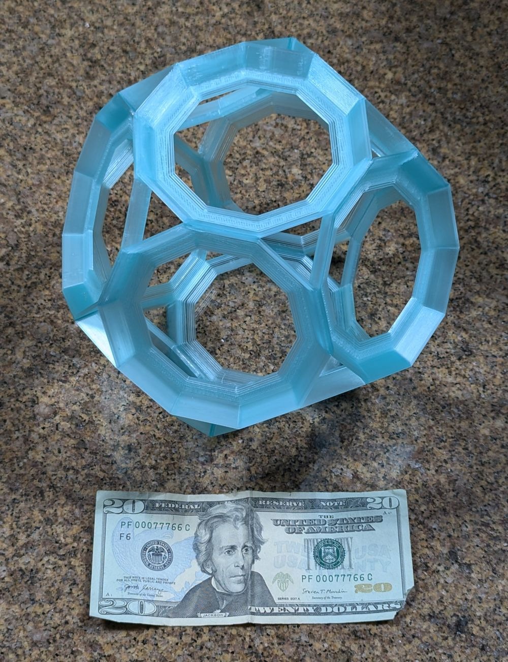

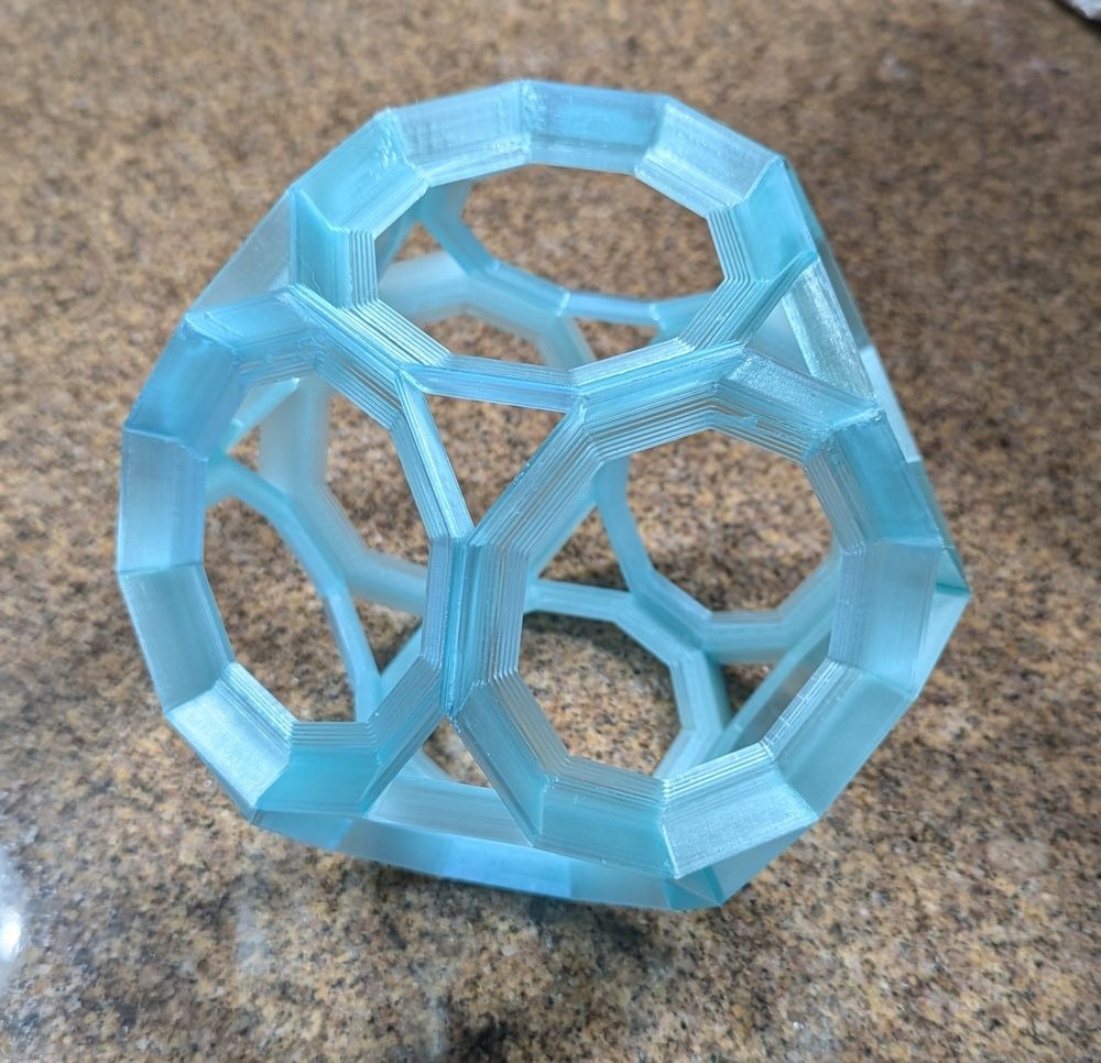

And do they fit together? Like chocolate and peanut butter!
With a sawbuck for scale (sorry, I have no bananas):
I'd say it's a go. I'll start work on the "final" driver design including screen support, electrical connections, and dust covers. I'll also design and print the triangular pieces that will fit between the drivers to close up the sphere. I'm hoping to make this a sealed enclosure but it might be hard given all the seams and potential leak points. I might have to add some silicone to the joints (or use some thick construction adhesive when joining the pieces) to seal it completely.
These prints used a total of 160g of filament. I printed 6 of the stator frames at a time in two batches. The frames are 100mm across the edges. After gluing these hemispheres I'd say the gluing jig is a good idea. Using binder clips only would require very careful placement and I'm not sure you'd be able to get the same results.

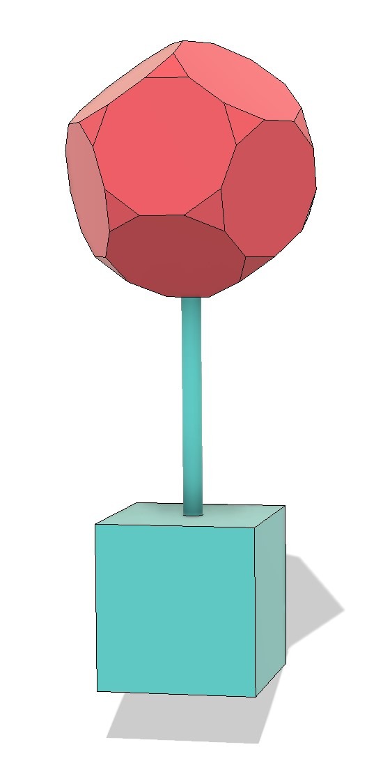

This is the idea. The tube will carry the wires up to the speaker from the transformers and bias supply located in the box. The angles that the drivers make on the surface of the "sphere" will require some specific height based on the listening distance because they are angled slightly downward. At 10' the driver facing the listener will have to be about 1.9' above the ear which will probably put it close to midway between the floor and ceiling in most rooms.
Even if the sealed sphere concept proves less than ideal, using a 3D printer to make the drivers will yield some useful results for making open baffle speakers.

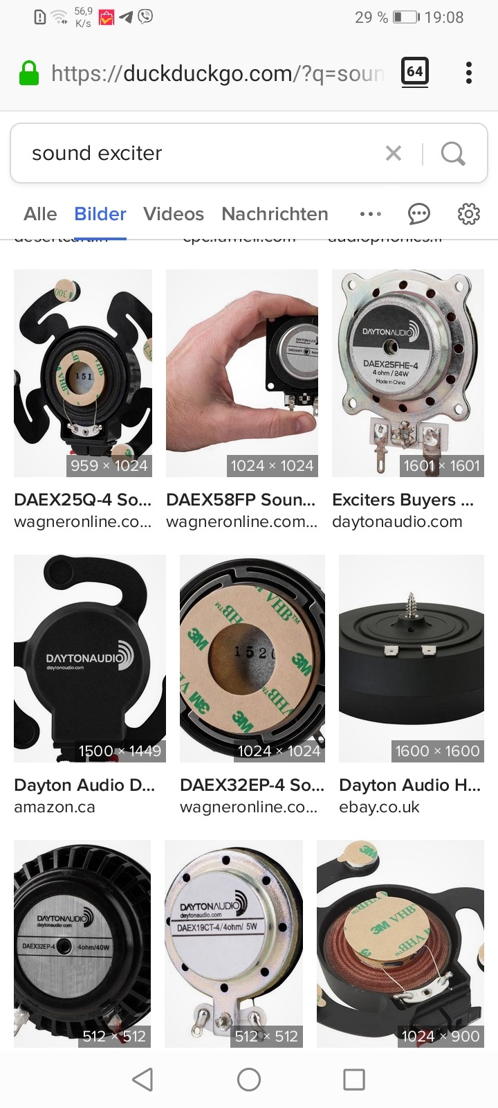

why not take a polystyrol ball and some dml driver making the ball emanate sound in all directions.
Some damping foam inside wich does not touch the walls.
Sound exciter could be outside of the ball on top.
I would try acoustical foam also. I agree that the absorption inside will be very important, but haven't tried this exact approach, so can't say what the best absorber configuration is. The lower the frequency, the tougher it gets to absorb effectively.Stuff a bag of polyfill inside.
Even if the device only works down to a few hundred hertz, it could still be interesting.
One of those drivers attached to a foam ball will not make the ball expand and contract as a spherical source- the waves will radiate from the driver along the surface, and maybe through the ball. Try it and let us know if it works.why not take a polystyrol ball and some dml driver making the ball emanate sound in all directions.
