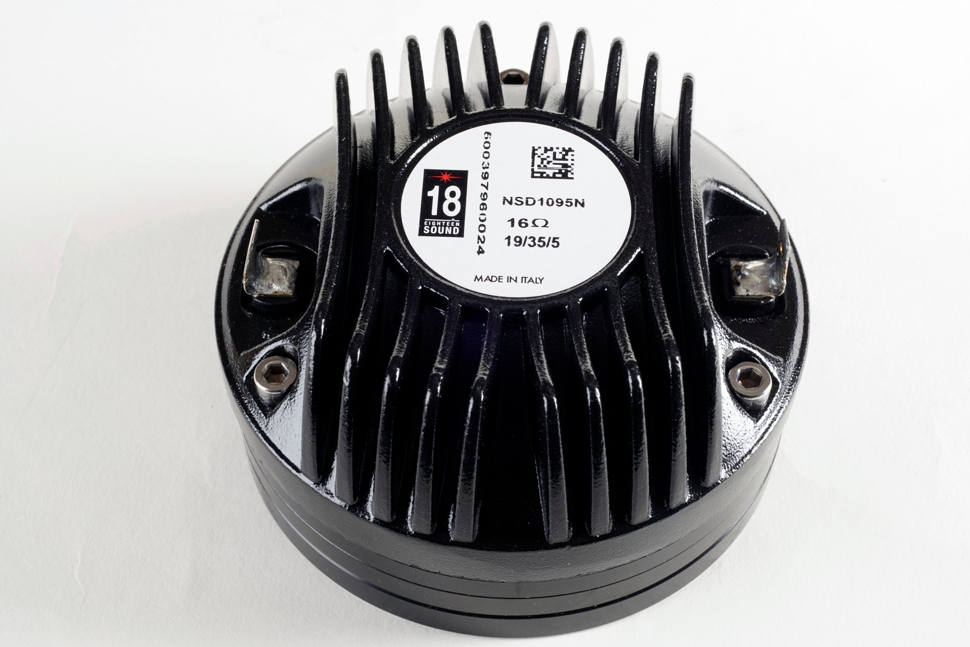

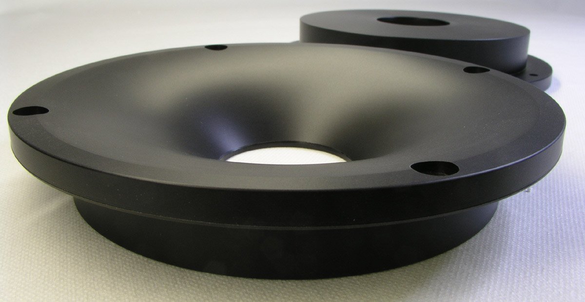

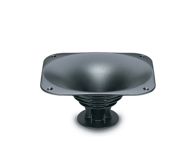

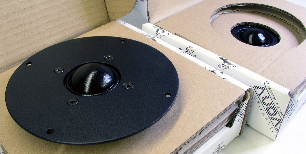

I forgot that the small, concentric horns are called "waveguides." My cabinet has one of those coupled to a fabric dome tweeter. But if you want something more professional, there are the TL-1 and TL-2, with compression tweeters. I don't know if it's within your budget, just write to Troels, and by the way, I have absolutely no relation to TG, I'm just a happy user.
http://www.troelsgravesen.dk/The-Loudspeaker-2.htm
