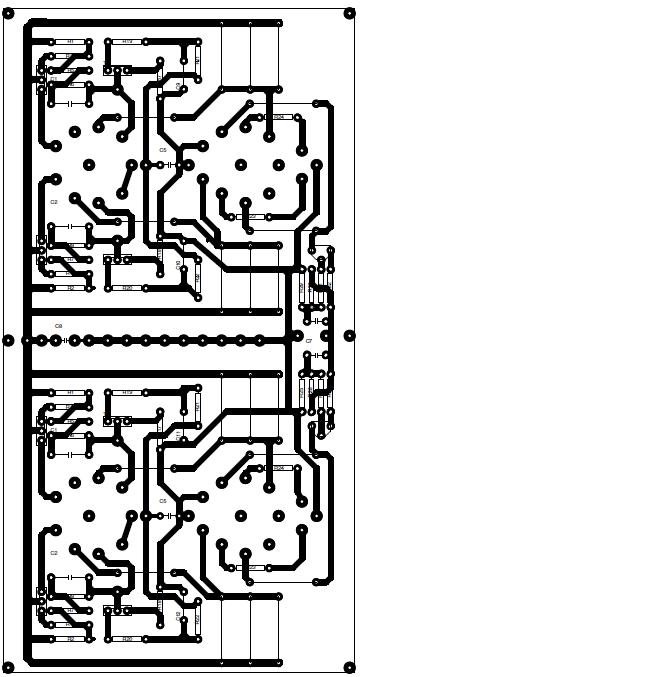

I just looked over your PCB layout and I'm confused.
I cannot see where Pins 1 & 9 are, as they all seem to be equallu spaced, so cannot orientate.
And in one tube you seem to have one pin unconnected, which if it's pin 9 that's ok, but on the second tube it appears that you have TWO pins unconnected.
Regards, Allen
Regards, Allen

Just looked at the posted pcb and realized it is the wrong layout. My sincere apologies for this error. The mistakes around the output tube have been corrected but i can't find the correct layout now. I'll keep searching.
Thanks for the hint on the zeners mr Wright. My FVP5 is due for service anyhow so I'll try to change it to the FVP5A version when i'm at it to

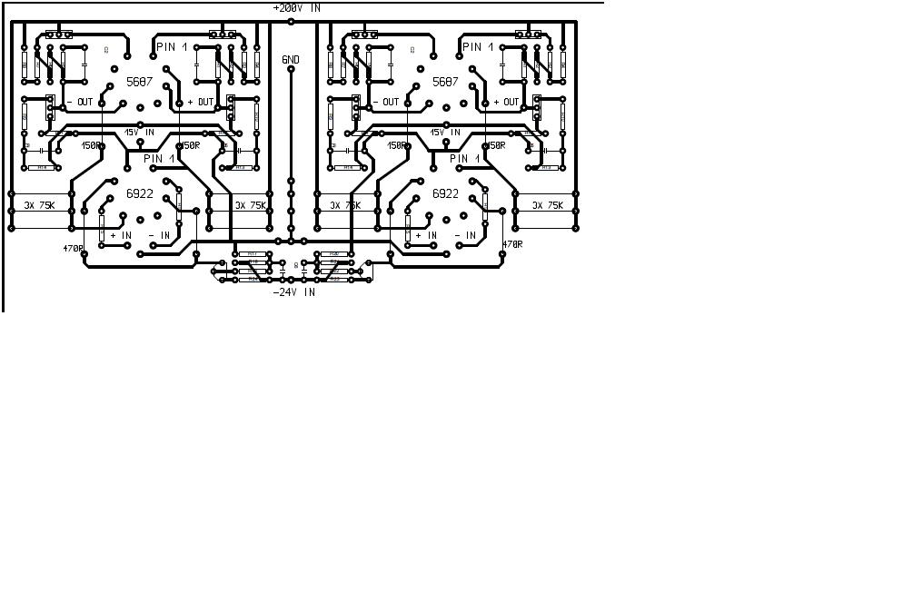

Well i didn't have the layout anymore so I made a new one. The dimensions may vary slightly from the actual unit but not by much and should give a good impression. This is bottom view for the tubes only. I've marked pin number one and supply voltage inputs as well as the values for resistors shown as jumpers.
I did try to get those gridstoppers rather close but maybe not close enough...

Jazz,
1/ Didn't realise you were doing a RTP5 line stage, I thought we were talking about the FVP-5 unbalanced stage.
1/ The grid stoppers for the 6922 are close, and MAY be OK, but as Andrew says, they should really be AT the tube pin, even if you have to "hard wire" them there.
The grid stoppers distance for the 5687 are FAR too long - I'd be surprised if it doesn't oscillate horribly! They must be moved very much closer.
This sort of thing is what tends to gives high gM tubes a bad name. People say "Oh, I've got grid stoppers there but it still hums, buzzes and is microphonic", but in essence they may have resistors, but not "grid stopper' resistors!

Noise in a RTP-5/FVP-5 gain stage is 99% certain to be oscillation. The production SVP-2's have had one instance of reported noise, but he had poweramps with some 40dB of gain! And when we researched this, the noise was in the SLCF section (circa 1mV), not the gain stage.
** What voltages do you get on the triodes in the cascode section?
** But what gain are you running in that first gainstage?
** And how muchgain does your poweramp have? And what speaker sensitivity?
** What PS regulation are you using? - if not a SuperReg, then all bets are off!
** The cascode gain stage has very poor PSRR, and relies on a dead quiet, dead stable powersupply. If you make a RTP-5/FVP-5 with phono but without a SuperReg, you also will certainly have motorboaring...
** Have you posted the PCB layout you have finally used? Layout determines stability.
Regards, Allen
