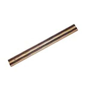

I have a few 24" long x 7/16" x 7/16" magnets. They are kitchen knife holders (search Winco WMB24 on fleabay)
Anyway, am I better off stacking them or placing side by side to increase magnet force...this is for ribbon tweeter... These are not Neodymium but cheapies I picked up thinking they could work. Thought to try this before going with the expensive magnets...

If you are making a ribbon tweeter then you want the strongest field you can get. Neodymium magnets are just so much stronger than everything else that unless you are making a large-scale device where you can make up for inefficiency by sheer size then you will want to go for the expensive magnets.
You have to stack them in order to make them stronger.
They are just like batteries in series, everytime you double the stack you double the strength.

As far as I know, all quality ribbon tweeters use neodymium or better magnets. The problem with ribbon tweeters is getting a large magnetic field in a small area (this is referred to as high magnetic flux density). There is a limit to the maximum field you can achieve by sticking magnets together without it becoming far too large to be usable, if your magnets are not very strong then you can't even come close to what would be achieved with neodymium.
Yeah, I knew I was taking a chance on these magnets...just don't know if I want to drop 4300 on magnets at the moment...anyone know an inexpensive vendor of Neodymium magnets? looking for a 5 - 6 foot tall tweeter....

One other factor is how are the magnets magnitized that is are the poles on opposite ends or opposit sides of the magnet, Usualy a round bar like that would have the poles on the ends probably not what you would want. And look on ebay you should be able to get enough bar neodyyminum magnets for your project for $100 or less. And with a 6 ft tweeter I would think you could get by with a little less flux unless you just have to have a sesnitivity of over 100 db/w .

The Neo magnets on ebay worry me. Wa s looking at 2" x 3/4" 1/8"thk at 17 pounds pull should be good...6 for $10 puts me at $200, and then the crazy shipping...
